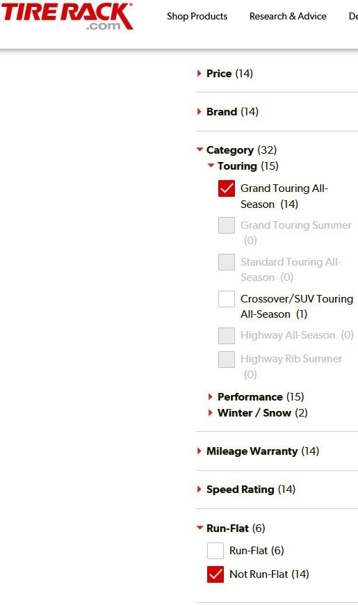

I'm always searching for the quietest tire, so I understand your plight! I recommend filtering your TireRack search for "Grand Touring All-Season" and "Non Run-Flat." Then scrutinize each tire's test results carefully for noise.
I'm not sure whether or not it's true that smaller wheel/tire combinations inherently are quieter, as it depends on the tire choice (it's possible to choose a crappy/noisy 19" tire versus a wonderfully quiet 21" tire). I will say that it seems like there are more options to choose from, the smaller you go.
Hope that helps!
P.S. If you currently have run-flats and are worried about doing without, you can always purchase the Mercedes TIREFIT kit for your trunk. That's what I did, when I ditched my run-flats in search of the best ride quality... I'll never go back!
