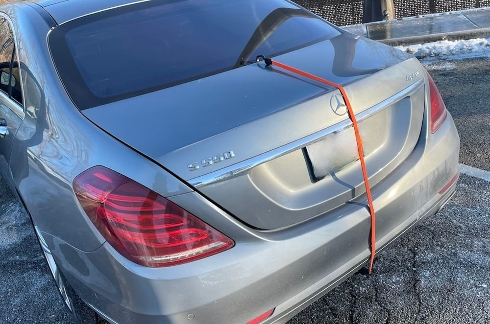

First overnight stay in Indiana. 21F in the morning and loading up. Close trunk, it pops open, will not latch. WTH! (Same problem with my previous 2015 S550 on a trip east at about 10F.) I push the green button, multiple tries but no luck. A couple times it latched for a second, the car alarm beeps to say it’s all locked, then it pops open.
Watching others load up their various cars and trucks, new and old, close trunks, hatches, clean the frost off their windshields, then drive off was rather aggravating.
I told my wife as we stood in the cold a nice new Navigator or Denali was sounding good.

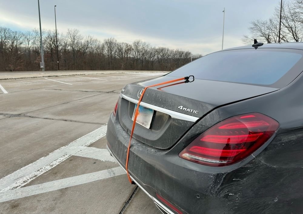

Luckily I packed the bungee from my S550 shenanigans. After lots of cursing Mercedes I bungeed it down and we headed west. Stopped about 1.5 hours later, about 35F, and I got it closed with green button trick.
Second overnight in Iowa, 30F, loaded up in the morning, closed the trunk… nope. Popped open. Green button no luck. More cursing. I decided to breathe on it to warm it up. First try nothing, second try it half-way latched. Like a hood not all the way closed - didn’t know trunks did this. One more try breathing on it for a while, pushed the close button and it latched.
To say I’m disappointed in this nonsense is an understatement.
Staying positive - I know how to deal with these issues. The orange bungee is ridiculous and asinine for a temporary fix for an S Class. Think I’ll add a second one as a backup. Maybe a battery powered hair dryer to warm up the trunk mechanism to make it latch?
This has to be temperature related. At our South Dakota destination about 39F, got it cleaned up and in the garage and the trunk and fuel door work perfectly. Multiple open/close of each and they work as they should with one try.

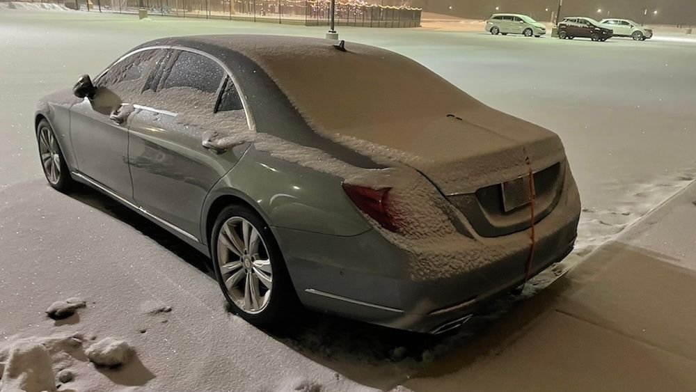

Pictures from a few days ago:
Jan 2022, my previous S550:

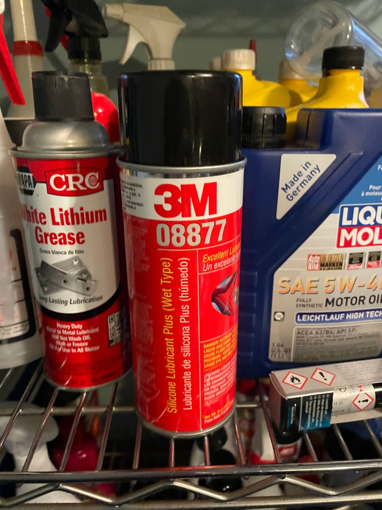

I called a local NAPA and they couldn’t get it from any of their WHs, so called one in Maryland and they found some in Connecticut. Thanks anyway.
So just picked up the Blaster Silicone Lube at a local hardware store, doesn’t say dry so should work fine. Done.
Also got this from Lowe’s, supposed to be good stuff. Think I have plenty to work with and hope it works. It’s -7 out now. Too cold to play with it, then test it. Plus it’s clean and the roads are a mess.
