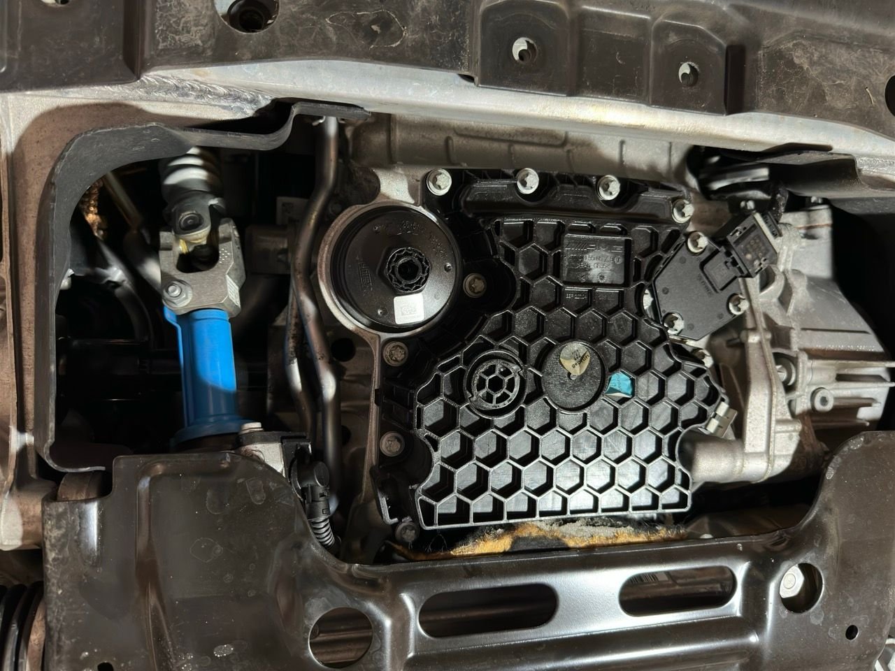

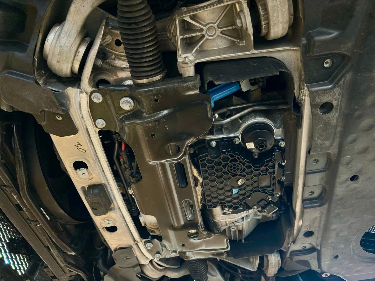

Had my 2020 S560 4Matic on my lift a few weeks ago looking for the oil pressure solenoid - never found it. Need a shop manual. It’s incredibly tight up in there.
While under there… I looked and I’ll admit I have no idea where the oil drain plus is. I’ve changed a lot of oil and just did my FF and my daily driver. Is it the small round plug in the black honeycomb piece? Interesting it has bump stops so no over tightening. Guess the oil filter is the big round cap, but thought it was on the side, horizontal? Guess I really need a shop manual.

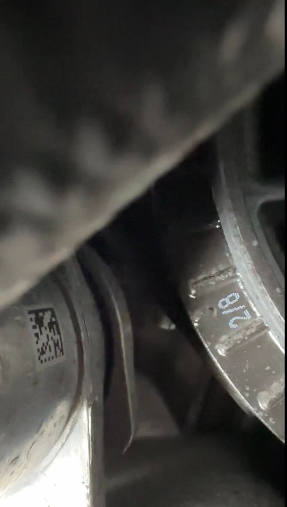

Locate the engine serpentine belt
the largest pulley is crankshaft balancer
look at 8 O'Clock (20Hr00)
that's the solenoid connector
it cuts down oil pressure below 3500.Rpm

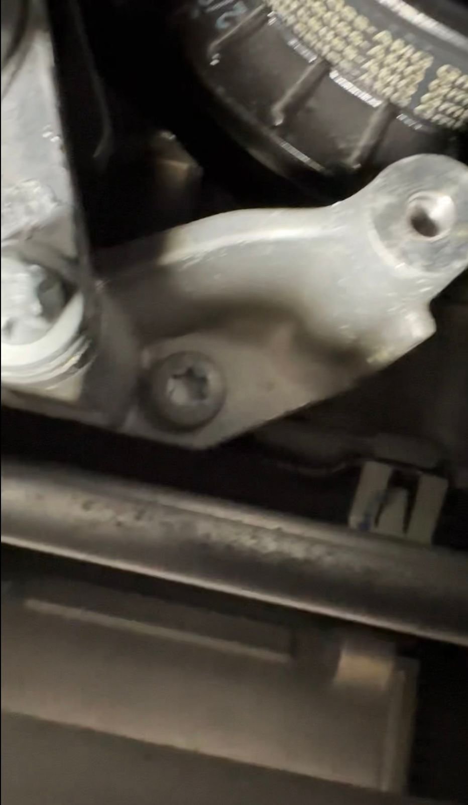

This is for an M176 engine (2020 S560 4M), correct? I took a bunch of pictures and a video and didn’t see anything, plus looking for a wire leading to it and nothing. Lots of hardware there.
Couple screen grabs from the video. There’s a bracket right in front of that area.
I also found pictures online where the solenoid connects to the oil pump but no luck finding it either.
You're right its hard to spot anything at all - Use a mirror and flashlight... sometimes old tech is most convenient.
Here is a guaranteed way:
Search online partlist catalog for exact location drawing... the so called EPC!
then you can go in with confidence and gloves on.
Tried that too. #37 looks like front and low where you’re saying. When I have time I’ll get it back on the lift for another try. Since I have their tune, I called RENNtech and asked if they could do something on the tune side to deactivate it. The guy I talked to didn’t know about it and said he’d talk to others. Sounded interested, but not expecting anything.
