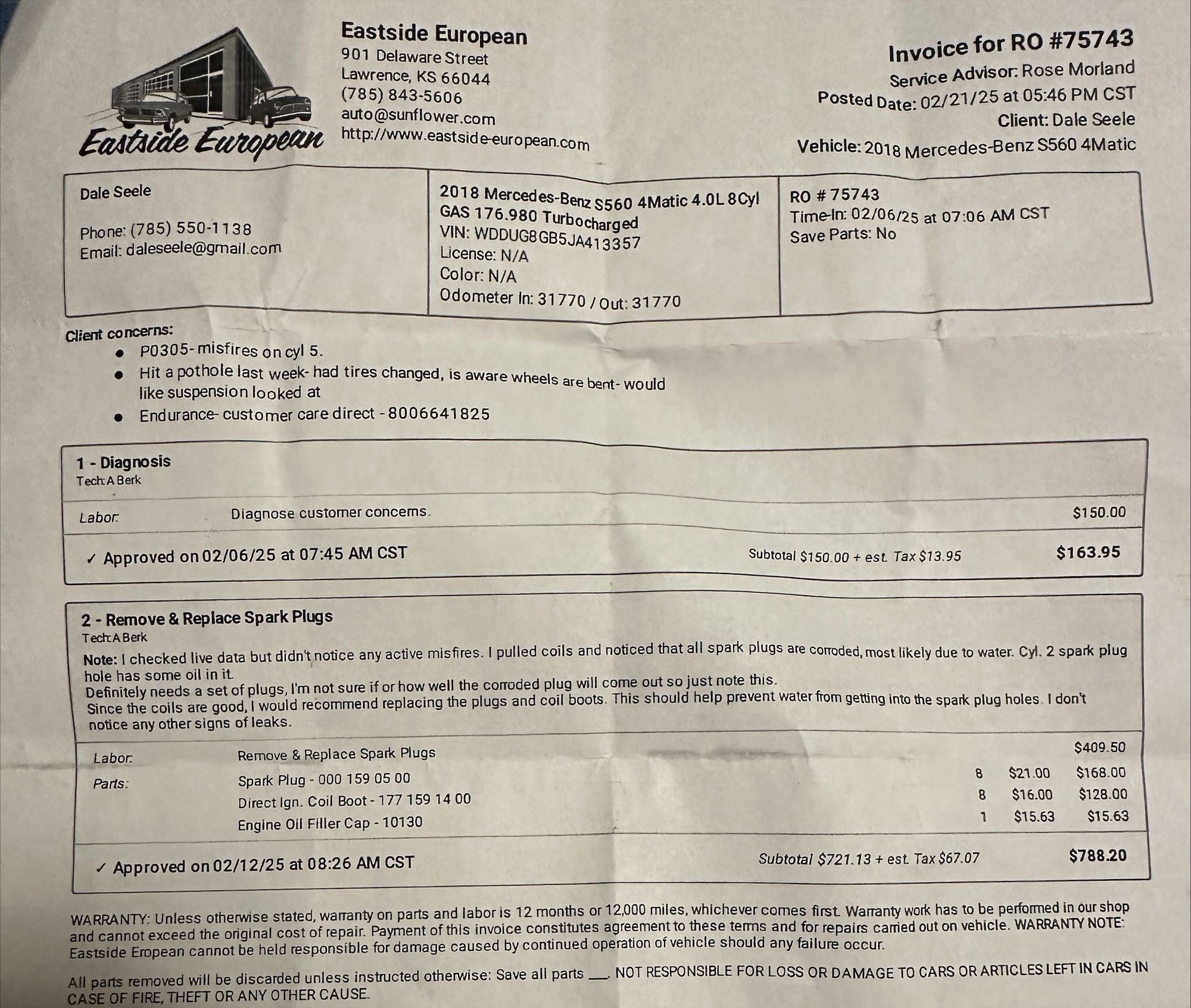

First time poster (dont yell at me) 2nd mercades i've owned. 31K miles, I've had it for 5 months. Purchased with 25K miles. one day car started missing, flashing CEL and then a solid CEL. nothing on command screen. had it scanned misfire Cylinder 5. took to a local shop and they said it need the coil boots and new spark plugs. they noticed there was water in some of the spark plug holes and oil in one (the oil they said was caused by a broken gas cap which I replaced. I picked up the car as i was driving home. As i was heading home (about 20 Min drive) it started doing the exact same thing, misfiring, flashing CEL then solid, then it had a defernite misfire (shaking, sluggish acceleration, etc) I got home as i was right up the street. waited a few hours. started it again. NO CEL, i let it run to heat up... i went back out to check it out about 15 min later. sure enough it was on and missing. I've only had the car for 5 months. should i get out? I baught it with a renntek tune. I wasn't going to but everyone on here and the folks i know say its a good tune and are very reputable. i'm taking the car back to the shop tomorrow to drop it off and tell them its not fixed. any ideas?? thoughts? get rid of it? came from an 18 750 which i loved. everyone said the benz had a more reliable engine that the BMW. any input or advice would be appreciated

Thank you for your reply. Do you have any advice if i should have it fixed or looked at again? with that low miles i was surprised that something happened like this. I had no Idea about the Bosh ECU thing. is that something an Indy shop can fix? or would i need to take it Merc. dealer? lastly should i just get out? I told the shop i'm not going to get in the just throw parts at it business which is what happened it looks like. Very good shop though maybe they thought it was resolved. Hopefully I can get it figured out. thanks again for the reply. I love the car, don't want to get out but I maybe should
EDIT: As i was driving it to the shop today to drop it off, the CEL was on but there didn't feel like any miss. I got about half way there the CEL started to flash, then back to solid CEL. At that point i could feel the sluggish acceleration and the miss. very weird

On this engine, leaking injector are commons. I replaced a lot of them due to misfire complaint.
I have OEM brand-new injector in stock from Mercedes in stock if you need. Just send me a PM

Was the coil pack changed?
As stated fuel injector would be suspect.
Diagnostic should be:
Change coil if only boot was changed
If problem persists check compression and fuel trim info to determine next steps
A tune always increases the damage profile, with low mileage that should be less problematic but anything can happen.

Also you don't have a good shop, they didn't diagnose your issue, they removed the boots destroying ALL of them (or at least charging you for them) and then just sent you out the door without a care.

The shop wasn’t able to recreate the issue supposedly. They took it out driving it. I explained that in addition to it missing while driving it was also missing while just idling in the garage. They were going to let it idle for 20 min or so. Supposedly nothing. They saw the code, after clearing it didn’t come back. They swapped oils from one side to another. They are going to let it idle tomorrow and drive and few miles and then go from there. I’m at a loss. I called Mercedes and they said they couldn’t tell me if it needed an update or not, it would cost 250 for them to tell me if it did or not

This is exactly the same issue I have had twice. The coil malfunctions like this intermittently, until it fails completely. My dealer couldn’t find it. My Indy did once I had scanned it for codes.
You need the coil for cylinder 5 replaced. Also replaces cylinder 6 as well (2 cylinders per coil). They just did boots, which will not correct the problem.

  1. Under-gap new plugs
  2. Replace new boots
  3. Replace all new coils
Then you won't have to deal with further ignition aggravations. Chapter closed at once with reliable ignition.

Actually that's what they are doing All Coils/Boots/Spark plugs. Hopefully that will resolve the issue. I wish they would of just gone with what i suggested but i get it they have to do their own diagnostic. Under gap the new plugs by how much? is that for the Renntek tuen? do you have anything i can read on for that?
