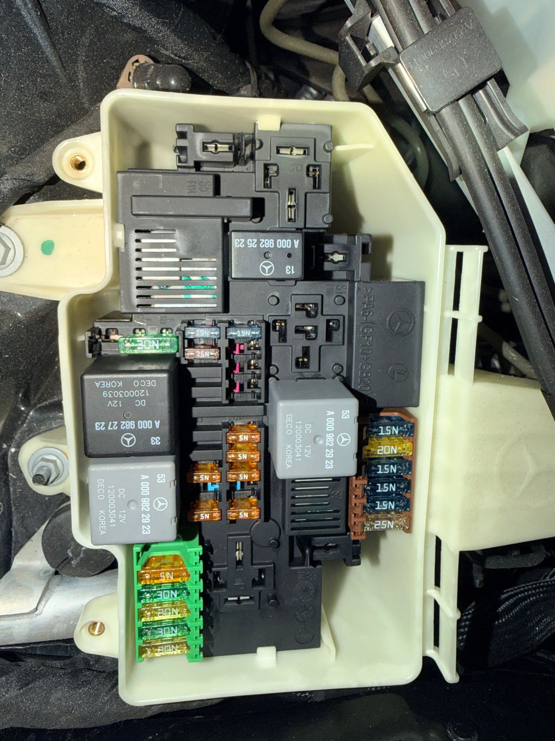

Considering the batteries are good. I would look next at the front and rear sam. Feel and look around for water intrusion into the interior and possibly getting into the module. When you locate the modules, check that all of the connections are clean and firmly fitted.

Replaced the aux battery just in case. Issue remains.
And I get these faults whether I’m doing highway driving or city stop and go, doesn’t seem to matter much.
I checked SAM. Looks fine to me.
Dealer recommends the LIN- Bus ground splice in the passenger footwell area. Said they need to cut into the harness and remove the crimp, strip the wires, and then crimp solder again.
They also think the “pumping” noise I’m hearing is the vacuum pump not being able to get stable voltage so it’s coming online randomly.
sounds like a nightmare in labor costs but, I’m not confident in my ability to it!
