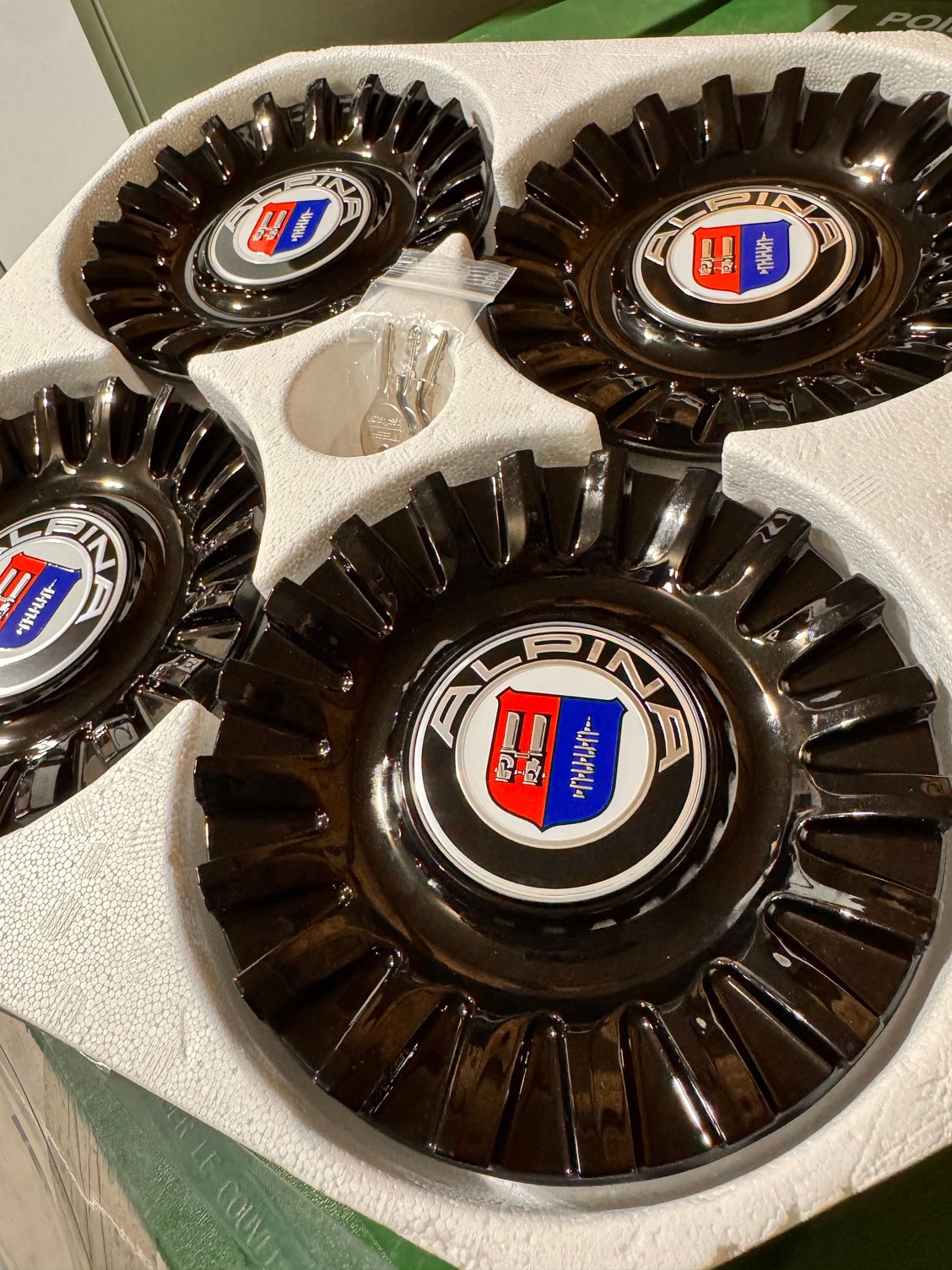

ALLOYWHEELSDIRECT.net
I bought brand new wheels from them and they are great!
I second that!. They guys are AWESOME!.
I just bought from them OEM center caps for my Alpina. Packaging is great, shipped so quickly, they handled VAT docs, and made sure all of them have 4 matching keys. They respond very quickly to emails too. They sell a lot of OEM items.

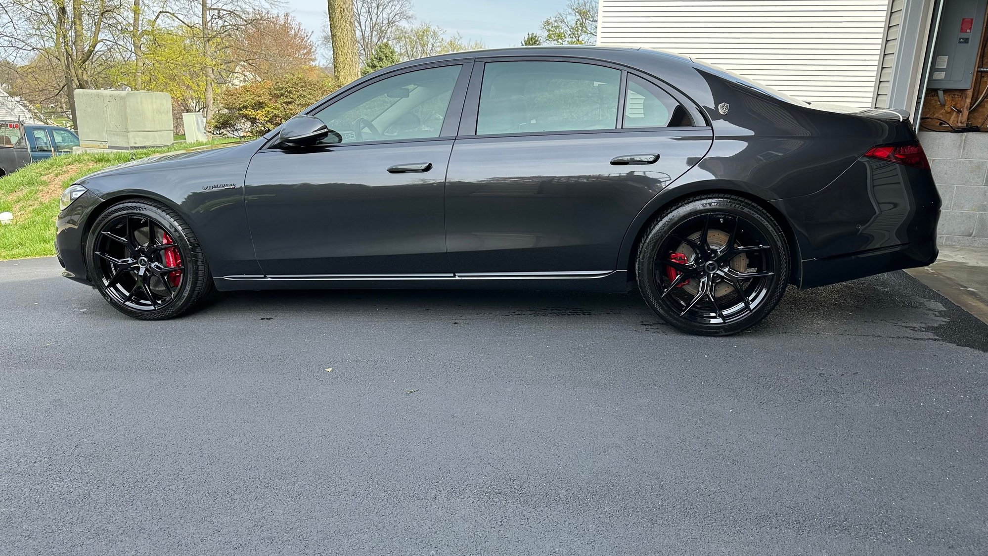

From Pirelli's 21
I went from Pirelli's to Michelin's @ R21". Best Tires ever! I went with a larger sidewall had my lowering links adjusted to 10cm all the way around and couldn't be happier! Less tire wear better in snow and comfort. No blowouts though, even with Pirelli. I live in South Central PA.

Originally Posted by DonS550
From Pirellis 21
What did you have to do to have the lowering links adjusted to 10cm? is that something the tire place can do? Or a dealer or shop?
Those are great looking wheels on yours. They are 21" I'm assuming?
what size tire did you put on with those wheels? Are they staggered front to back?

2021 S580 4MATIC with Rear Executive Seating Pkg. 4D Entertartainment Rear Screens Pkg.
You need to go to a custom performance shop as Mercedes would charge over $3K to readjust. I went to a larger side wall and my kit was too low, found it was rubbing once it went to sport plus mode and when I was making 3 point turns on uneven pavement.
Yes, the wheels are 21" staggered.
You should be able to zoom in and see: 255/40/21 - Front, 295/35/21 - Rear
If you don't have a lowering kit on your vehicle, they will work (I would recommend spacers).
