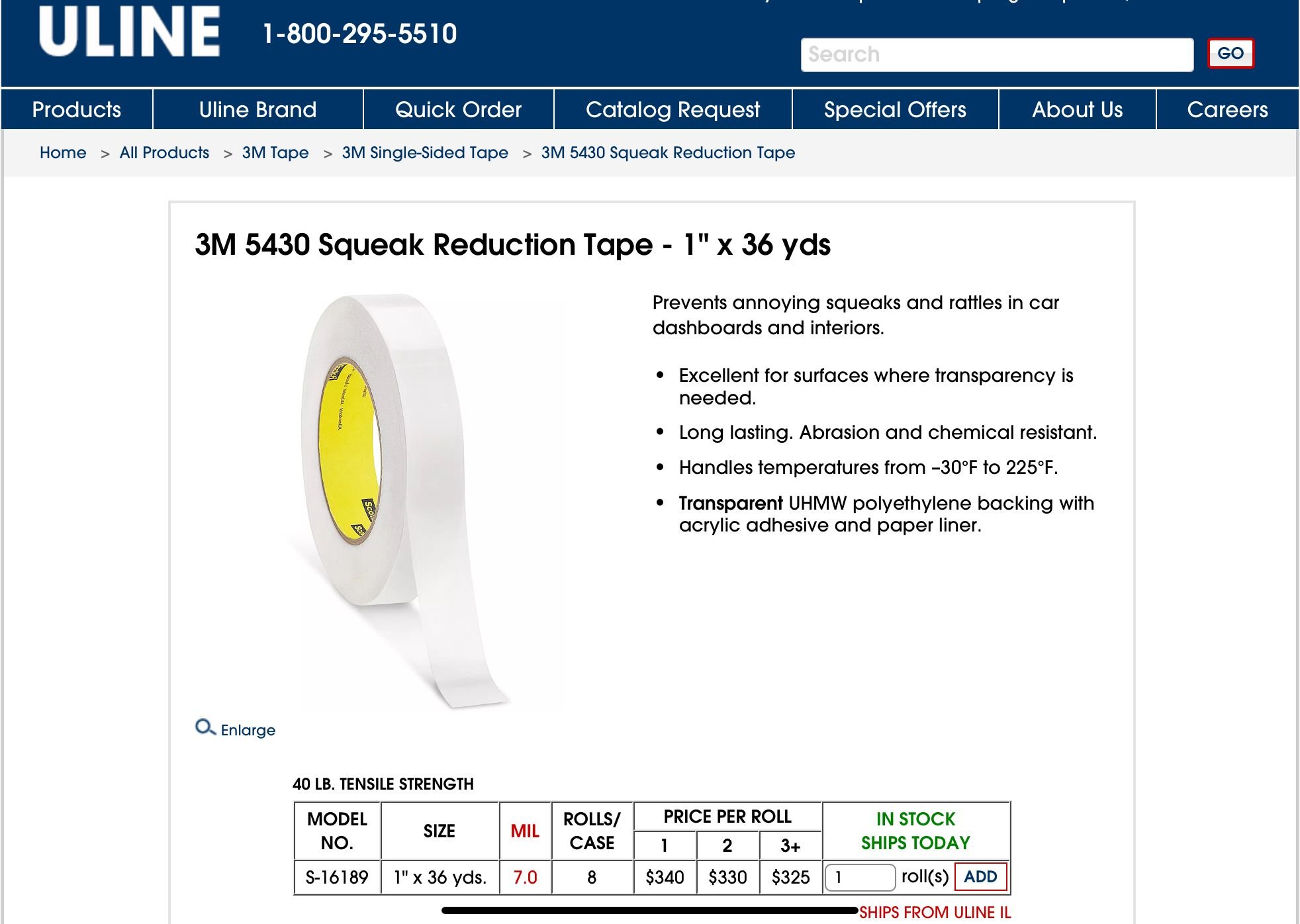

So, it’s a lazy Sunday morning and I’m looking at the ULINE website, as I need to order some items and I happen to see this. Amazingly pricey, but might work wonders.
