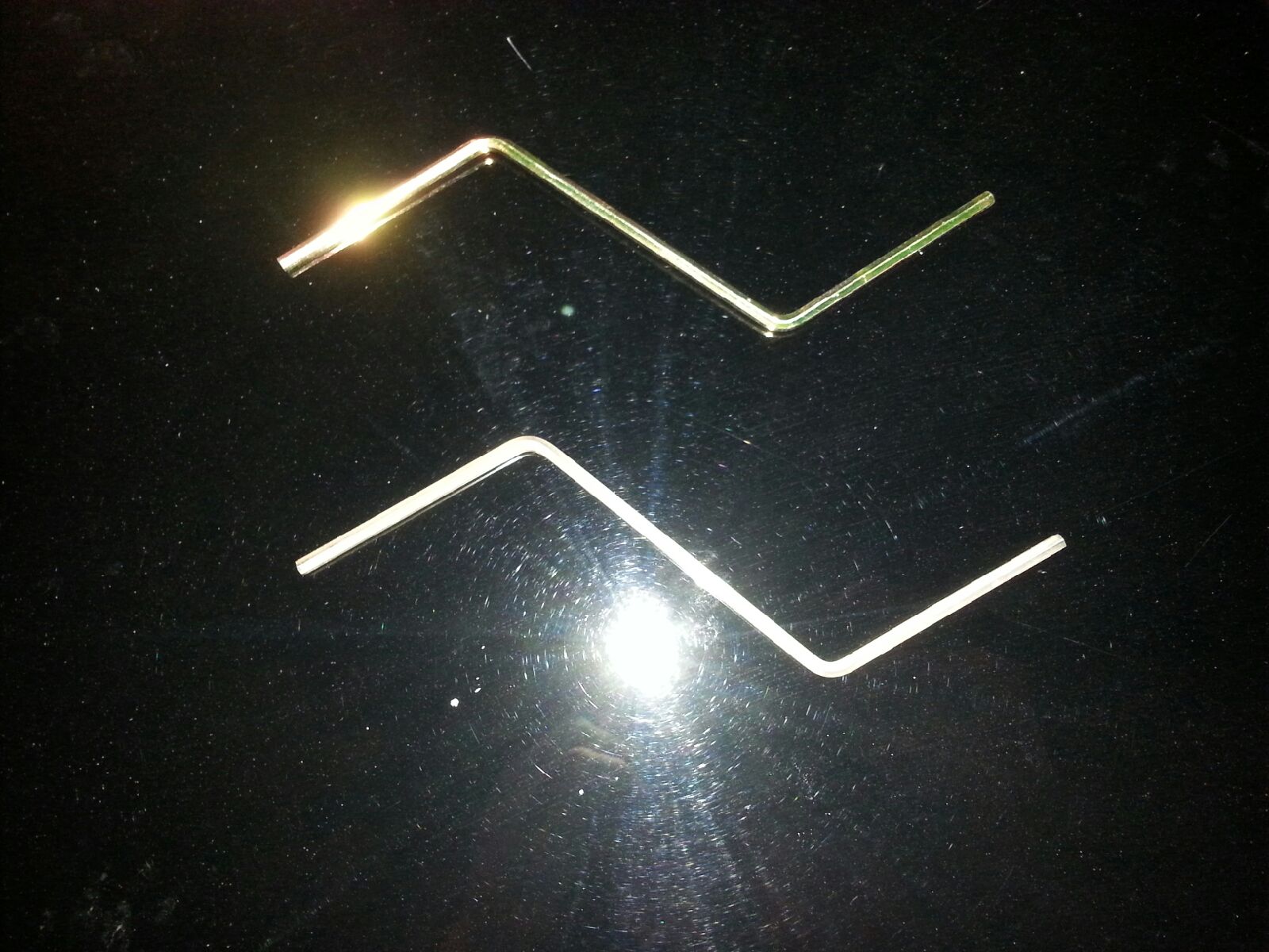

In the attached photo, what are the wrenches I find in the glove box?

Hi Jim, and congratulations on your new acquisition.
Those wrenches are probably emergency winders for the sunroof.
Nick

Finally, the existence of the wrenches out of place would concern me. You should go through and sync your windows (hold the up position for 3 seconds), and sunroof (hold the close position for 3 seconds) with the key in the On position (not sure what this is w/KG). You'll hear a very faint electronic "click". That way you'll ferret out any problems with the roof closing.
