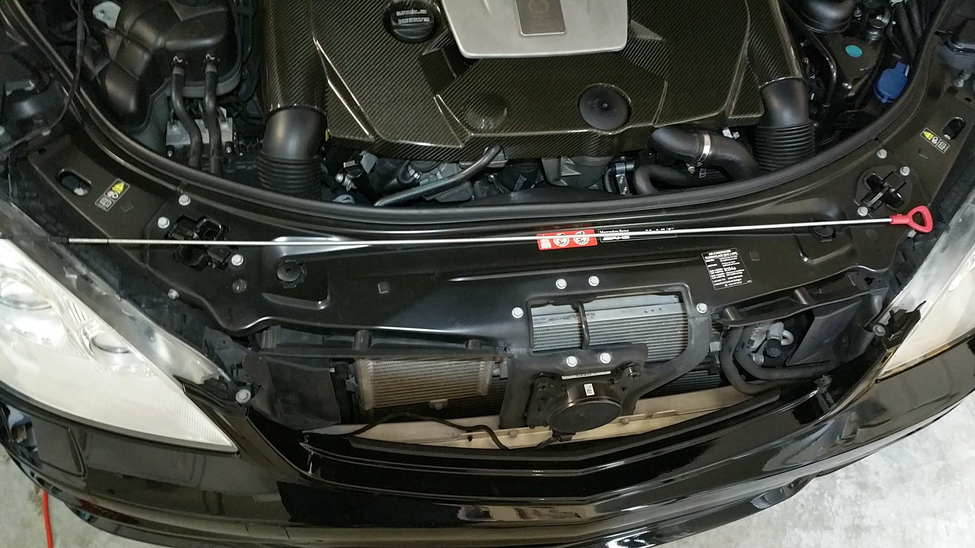

I use the same dipstick I use to check the transmission fluid one level is for cold and the other when the trans is warm.
For the oil level, right after an oil & filter change with the 10.5 qts. (I always put in 11) and measuring the level the following day when the car has sat overnight after driving, the oil should be right at the black mark I have on the metal portion. Almost 5 inches from the plastic tip.
Readings for both levels are 100% accurate. Tom
Bought it off Amazon. $25
Mercedes Benz 722.6 Automatic Transmission Fluid Dipstick 1220mm 140589152100

Thanks Tom, that's fantastic. I'll order one of those dipsticks.

Quick question about the dipstick described above. Since our cars have the 722.6 5-speed transmission, when the gearbox is hot, should the fluid level be between the 80* hash marks and when cold, between the 25* marks?

Yes when warm it should be within the 80 marks. To measure the transmission fluid though, you have to make sure you get the dipstick all the way to the bottom of the transmission pan by wiggling it some. It will feel like it stops initially but then when you move it a little it will drop in about another 3 inches or so. Watched the service manager at the dealership do it once so I knew how far it needed to go in.
I would say there is about a foot or so of the dipstick that still sticks out even when measuring the trans fluid.
Even more of it when measuring the oil.
