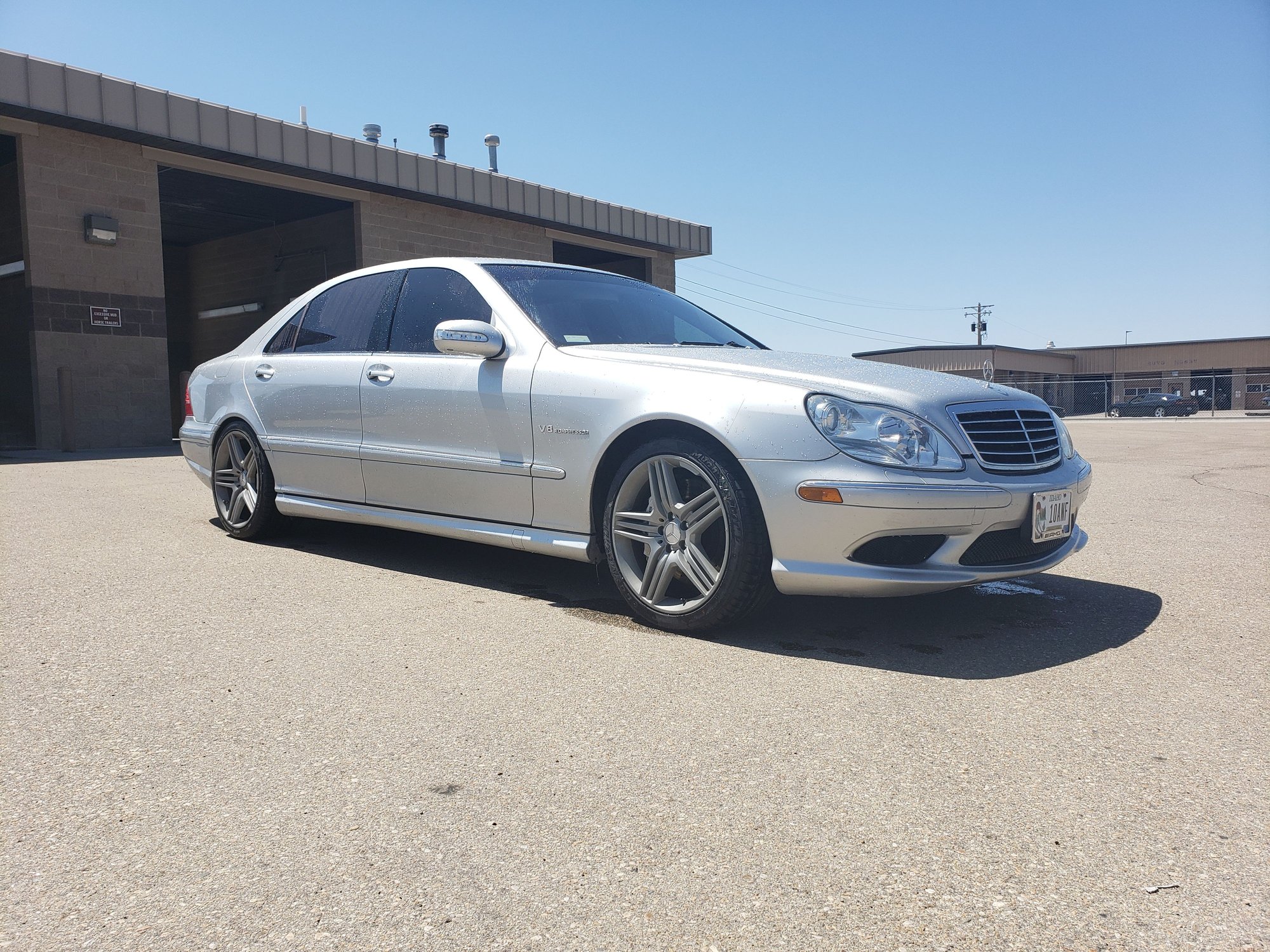

hello everyone this is my first post and I have not found any information I was searching for (maybe I'm bad at navigating the forum?
I have a 2006 s55 and am interested in doing a coilover swap or bagging my car. I know airlift is a management system but any company actually make air struts for my 2006 s55?
Is there any reputable companies that make a good coilover for my car? I understand I need a sway bar too. Seems like there isn't much info I can find on the internet about my particular car in this situation.
