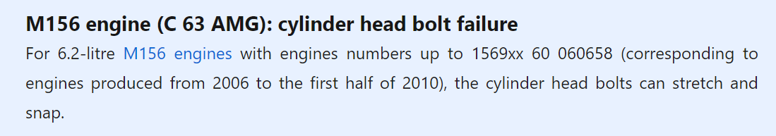

Here is some info that I didn't know about the M156:
Here's a guy that loves his M156 E63 and explains what the concerns are with the engine and works on them in his garage:
His head bolts were fine.
Another guy addressing the cam adjusters...in his garage:
All of the above look like major surgery, but for a decent shop (or competent DIYer, it's not). Doing such "top of the engine" work is a lot easier than doing similar "bottom of the engine" work...that's if it needs to be done at all.

Does anybody have the specifics on how to tell if an M156 was equipped with the upgraded head bolts and lifter buckets? I’m talking about from the factory.
(Edit: I see the AMGmeister video he specifies the engine numbers for the head bolts) but what about lifters.
Is there an example of what sound the lifter buckets would make as they wear and become close to failure?
Long time fan of the motor but these things would make me hesitate from owning one.
I think this might not apply to every single M156 though, I've read it even goes out to 2012 per FCPEuro which is all of them.
The lifter thing is obvious it's going to sound like a spray paint can being shaken x8. They also have issues with premature camshaft wear. I think certain oils just didn't vibe with it.
The upgrade is to the SLS Black ones which are $1700 in parts, the regular ones are $800.
Yeah I mean if something sounds like a bad idea for you don't just leap of faith it. These issues aren't uncommon enough to where you should put yourself in a position to have to need $5000 one day that you don't have. They're uncommon enough to where I'd just drive the thing and bail out as soon as I have intermix and deal with it at the shop. The amount of cars affected has to be under a certain amount so the manufacturer doesn't end up having to recall the entire run of cars. It's something under 5%, I was a Porsche 996 and 997 guy with the IMS, porous block casting, D-Chunking, timing guide and bore scoring and all of those issues combined didn't cause them to recall

That said, the S63 has the headbolt and cam adjuster wear issue...still fixable.
