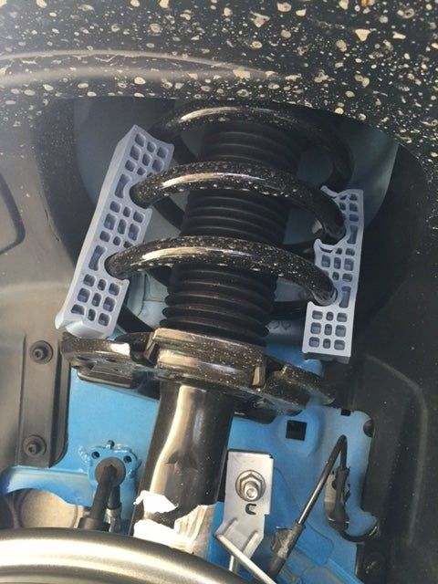

But just to add another possibility, I hope the shipping blocks have been removed. You wouldn't be the first one with a car that was riding on the shipping blocks for many years until somebody actually discovered that they are still in there.

The most interesting point of your post was shipping blocks. Never heard of that. The car had two blown front struts when I purchased it likely why I got it so cheap so I had them replaced with MB struts. Never heard of shipping blocks but a quick Google lead me to photos and I don't see any shipping blocks.

Shipping blocks are plastic pieces in the suspension that keep it from compressing. In case of coil springs, you'll find them attached to the springs. Below is an example. Blown struts on a 2020 would make me suspicious of additional suspension damage. The prior owner must have hit something badly. The adaptive suspension may not be working correctly. Also wanted to add, your other two vehicles have air suspensions, whereas your GT has coil springs.
Oh I remember those I think the C190 GT actually had some bright coloured was it orange or yellow shipping blocks to make it more easy to identify. I am curious why they changed the colour to the one of such it matches the struct, it might get overlooked from PDI. I still remember a forum member bought a used vehicle still with them installed.

When I think of shipping blocks I think of the shipping bolts that holds the drum of washer machines.
Thank you. Never seen these before on any car ever. But no, no shipping blocks. I agree on a 2020 with blown struts sounds suspect. But it was looked over by an MB shop foreman. It was just the two front, because it came from Chicago I suspect as the foreman does he probably drove around in sporr+ and dogged Chicago potholes.
