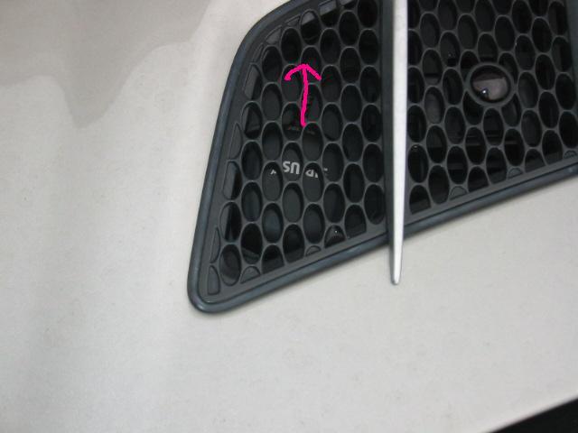

Ignore the pink arrow. You can place the antenna in the driver’s side vent. I use a metal plate and attached the plate to the bottom of the vent with silicon. The antenna has a big magnet on the bottom and the magnet will stick to the place.
The vent on the passenger's side does not have a bottom vent cover. You will not see tie wraps doing my way.

Quote: Ignore the pink arrow. You can place the antenna in the driver’s side vent. I use a metal plate and attached the plate to the bottom of the vent with silicon. The antenna has a big magnet on the bottom and the magnet will stick to the place.
Tigger,
I'd say you've achieved the ideal solution. Innovation often leads to perfection.
