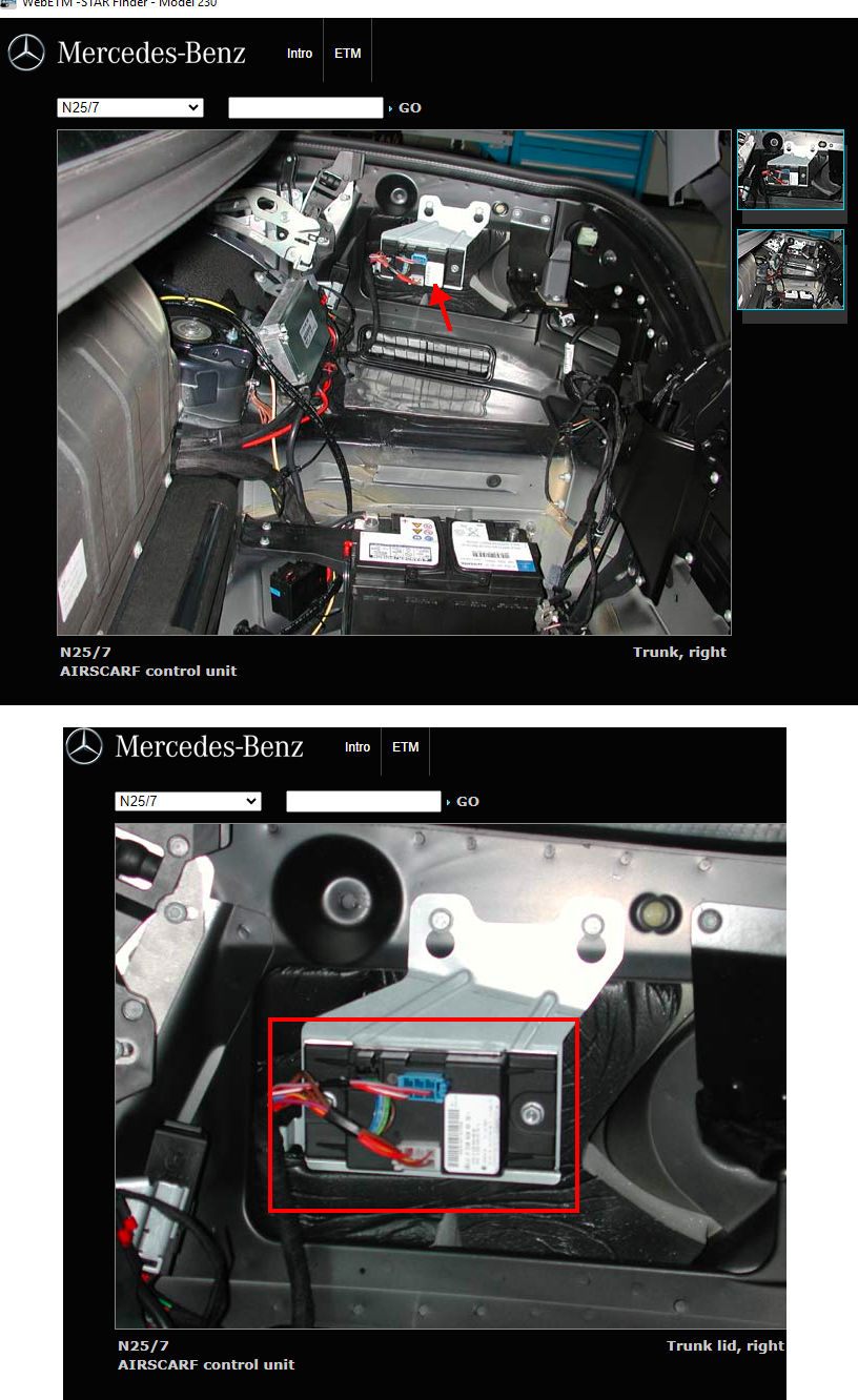

There is a control module in the trunk (boot), so you would need that plus wiring, the door switch, upgrades to other modules, software, etc, etc.
