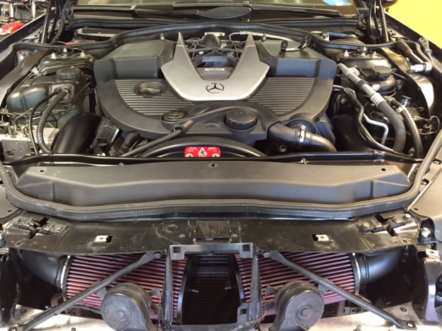

Hello members.
It's been some time ago since the last time I was here...
Someone of you remember my CAI thread for about one year ago...
https://mbworld.org/forums/sl-class-...e-project.html

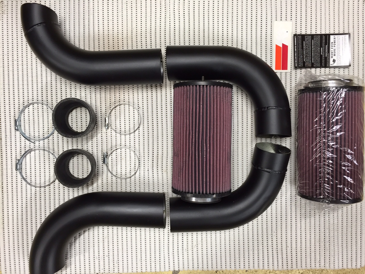

Because the CAI result was very impressive I have decide to made them at carbon fiber. Will look a lot better !
The pipe ( left and right ) which are at the engine room is going to made at carbon fiber. The another ones (outside) at aluminium as they are now.
Some of you have asked few things about the fitment and I'm pretty sure its gone fit CL ( AMG) an al SL (AMG) cars to with V12 Biturbo engine. Because you can adjust the length at it.
The CAI is al the way 3".
So if someone is interesting about this CAI system I can made some extra's at the same time as mine.
Those who are interested let me know....
PS. I must change bigger injectors to because the engine run to lean at upper rpm's. I think I have 15-30 hp more there.

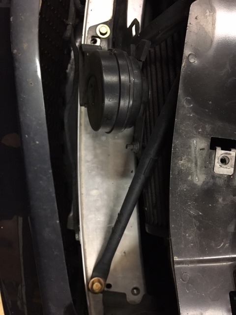

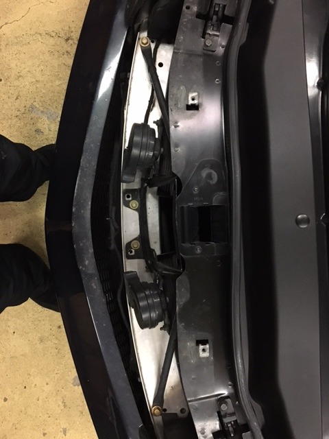

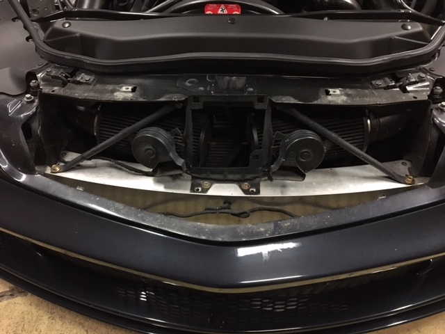

Hello ...
Today I had time to take few pictures where the filters located.
At the same time I took of the pipes, filters so I can send them away to a workshop which make them at carbon fiber.
So how many of you want to order them?
Only the pipes which located at the engine room is made at carbon fiber. The another pipe which is front of the radiator is gone be made of aluminium.
Complete kitt without K&N filters because the filters is cheaper there than here in Europe.
As you can see at the pictures there is lot of space behind the grill.

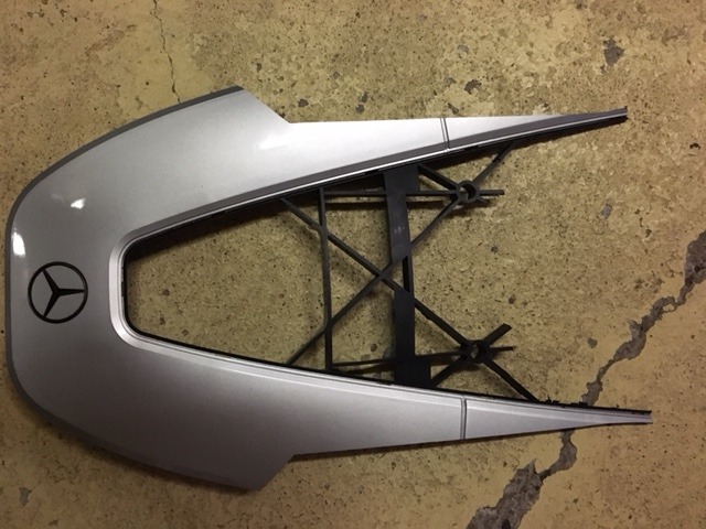

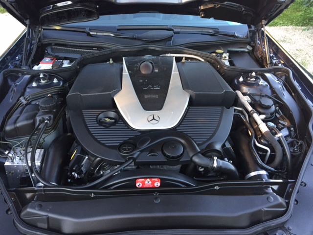

Next step
I'm gone send away this engine cover also to the same workshop.
They are gone try If they can made this cover also in carbon fiber.
This cover is for all those who have Speedriven intercoolers on the engine. I have cut it so it fit.
At the moment I don't know the price. I think I have the price end of next week.

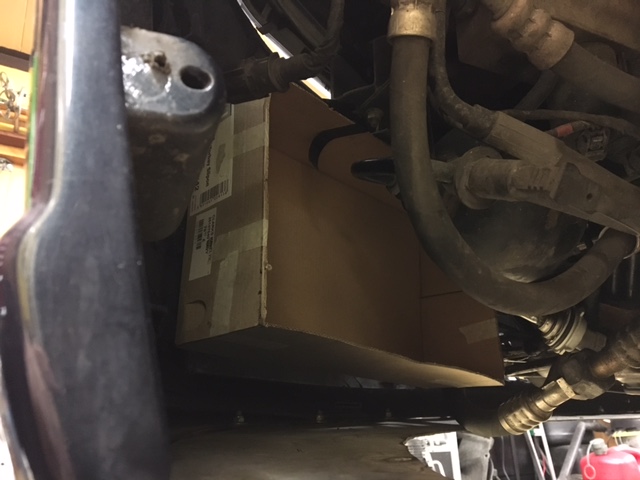

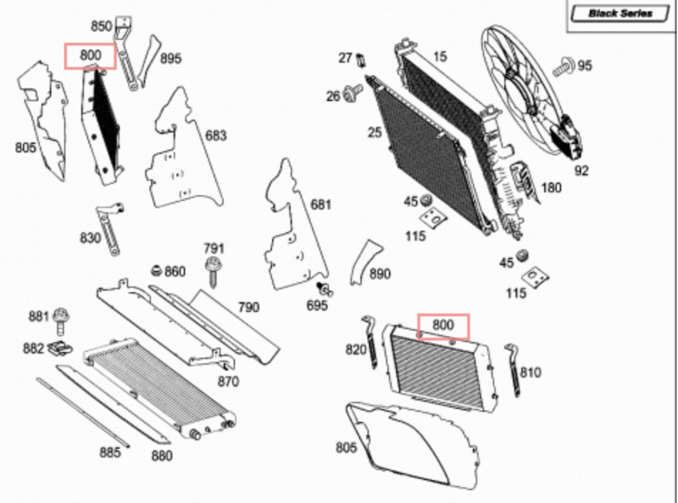

I found this info. Mercedes SL65 AMG Black Series Heat exchanger located like this. Two piece. One at the left side and one at the right side. Big ones.
So why not for the wide body cars?
SL600 R230 V12 Biturbo CAI system.-screen-20shot-202017-01-19-20at-201.09.39_1.png

.. But If I'm gone go this route I think I'm gone leave the extra HE from Eurocharged in the middle to or the OEM in the front.
I'm not sure about the pump then.. I have the X5 pump from Speedriven already there.

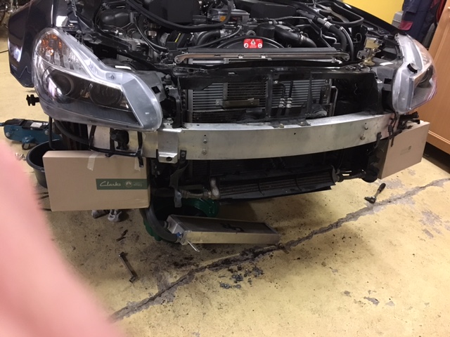

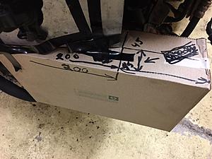

Heat Exchangers
Hello.
Today I have looked closer into this matter. I have come to the conclusion that it is not at all difficult to install similar coolers as BS has.
The size of the both HE can be :
- Length. 330 mm / 13"
- High. 220 mm / 8,7"

I have decide to go this this route.
Today I have asked from two different manufacturer's offer's of two "cross flow" heat exchangers.
My opinion is the locations is the best of all. No heat from the engine.
Old Feb 1, 2017 | 03:54 PM
Ekselent's Avatar
Joined: Jan 2012
Posts: 883
Likes: 24
From: Finland
SL600 / SL450 (107) / E350 / BMW M5 E60 / BMW 745i (E23) / BMW X6M / Toyota Hilux 4 WD/ Honda CBX 10
"BS" Type of HE.
Hello.
Here few pictures how I have decide to do it.
In the middle I'm gone use the OEM HE because its much bigger than Eurocharged HE.
At the corners "BS" type of HE's.
The HE is gone be Tree Pass model because its most effective type of HE.
So the HE it's gone be divided into three different sections so the liquid flow longer distance.
So I'm not gone use the fourth Eurocharged HE at al. 3 HE is enough.
I have ordered them last week and the delivery time is 2-3 weeks.
The dimensions in the pictures are in mm. ( 12,5" long, 8,7" high and 3,5" thick).
Price around 800 USD.
