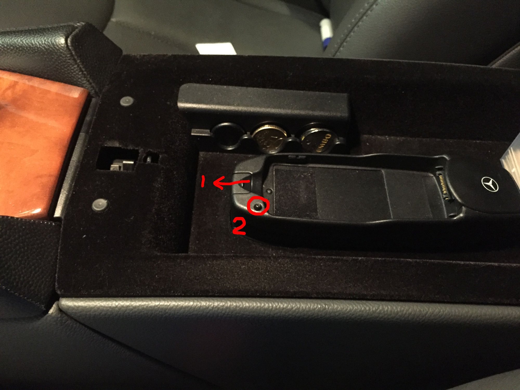

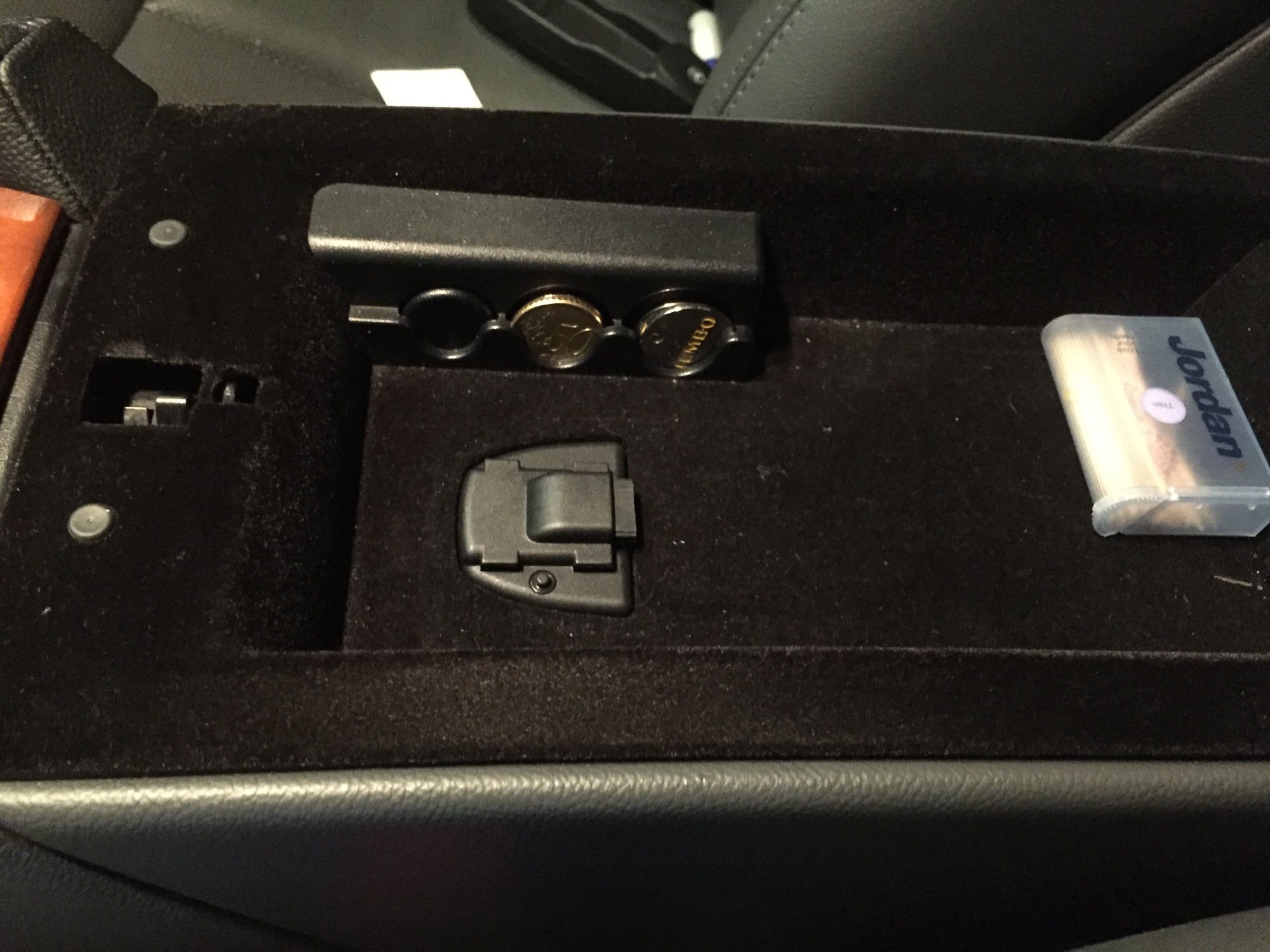

To release the phone from the cradle of course you pull the latch as per [1] (at least on mine).
To release the cradle from the connector you push [2] and slide it off towards the rear of the car. The Bluetooth units sit on the same connector. Not all the news about the ridiculously costly bt units is great.

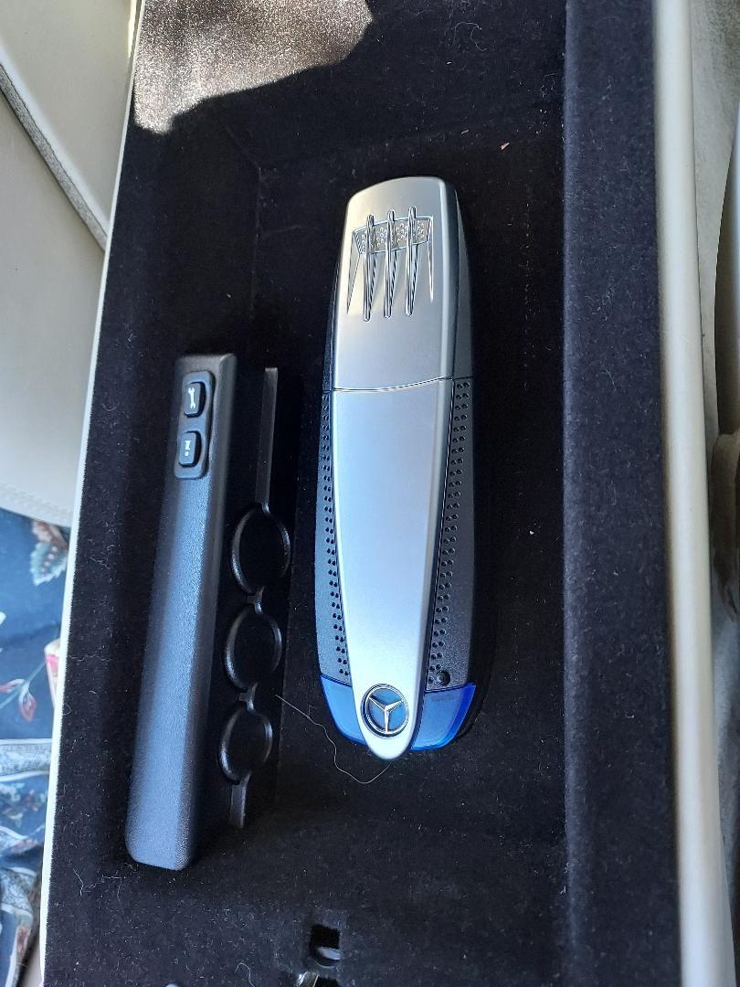

Is this the "puck"
I finally was able to remove the "phone" from the console of my 2005 SL600. It works in the car and connects to emergency and service.
I was hoping this device which has the MB part # B67875878 which is shown on ebay as an adapter to allow bluetooth phones to be connected. I can't figure out how to do this. I even went to the web site on back of device wireless4MB.com and got nothing.
Anyone have any experience with using this to connect a cell phone via bluetooth??

Looks like the only alternative is using a device for the lighter. There is no aux jack in the glove box.
From my reading of hundreds of posts on this subject I thought the device I have in console could be paired with cell phone. Apparently not.
