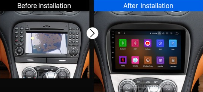

Thanks for the suggestion Frederick. My 2005 SL has a slightly different console to yours. It is like the one below so it fits nicely into the space but unfortunately the bigger screen mean that I'd lose the cup holders.
Exerpt from the Seicane ad.

PeterSh. The comand/radio on the right on the picture you posted does not look to be an Seicane unit. It for sure does not look like it since it is more a Kenwood, Pioneer style
On the picture below is the Seicane unit for 2005 and newer Mercedes SL, R230. But as i said i do not know the quality of the Seicane products.
But do not the Seicane use all of the original connectors so it is mostly plug and play work installing a Seicane unit
I am pretty sure that you will keep your cup holders using the Seicane unit

The unit in TheSaint's post is one of many guises of the same unit available from China, and comes at many price points depending on memory and options. I looked at one for my car, but was really very expensive for a "cheap Chinese" head unit.
You WILL loose cup holders with it, and you WILL loose CD/DVD completely including existing multiplayer (Big one for me as I watch DVD (no not when driving but when I am waiting to pick my wife up from work))...
You will still need a MOST converter, unless you remove/replace existing amplifiers, and speakers (SL speakers are 2 ohm), though you can get away using them.
There is another option which is to get an adapter faceplate for double DIN head unit, and install that. Much better quality, but still need MOST converter if keeping existing speakers/amplifier, and also a steering wheel CAN adapter.
For a Modest Pioneer head unit it can work out cheaper than the Chinese head unit!, and you keep your cup holders...
