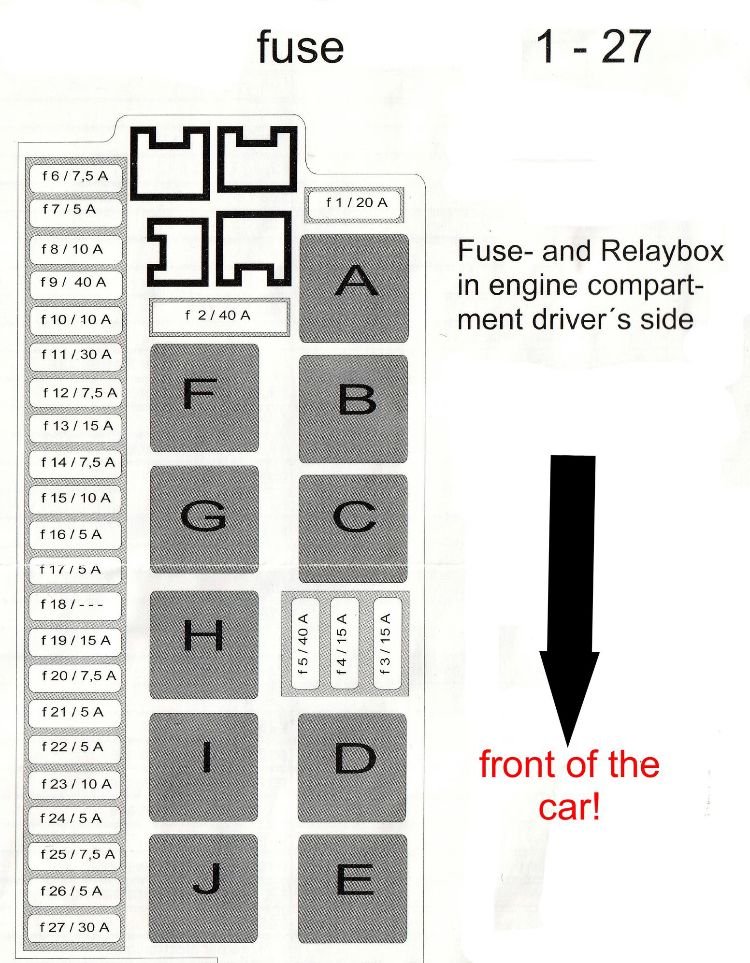

Left fuse box under the bonnet, brown 7.5 amp fuse, third in its row. The fuse protects the alarm horn only and nothing else, not even the alarm triggers. So you might still get false alarms, with the blinkers flashing if your car has that habit. But the alarm horn will draw zero current.

Old Jul 2, 2023 | 01:36 PM
Frederick NL's Avatar
Joined: Mar 2018
Posts: 1,442
Likes: 260
From: Netherlands
2005 R 230 SL350 (M112 3.7). Sold the 1966 W113 230SL recently
Hary Gahtoe's Avatar
Joined: Jan 2007
Posts: 744
Likes: 73
From: PNW Wa State
R230, C5 Corvette Convertible, Audi Allroad, Lexus RX350, AE86 Hachi Roku
Using a MB SDS it can be removed from the system as well as the manual style.
It becomes a battery killer because of a factory flaw in the alarm
Your alarm siren should be a 7.5amp, it's #25 on the left front SAM.
Old May 2, 2025 | 09:15 AM
rodski's Avatar
Joined: May 2025
Thanks Frederick!
Just what I needed.
