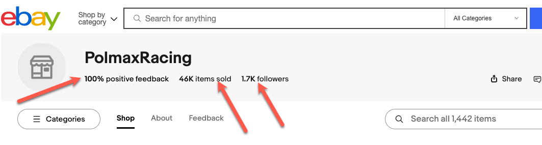

Originally Posted by cdk4219
eBay is definitely where I would not go to buy genuine Bosch injectors, or genuine anything. I have purchased enough of the counterfeit ones to realize that. Really hard to tell them apart, but genuine Bosch injectors aren’t $15 each.
Well, the seller has a 100% rating on over 12,000 reviews. Kinda hard to get if you are a scammer.
The price is $349 for 8, or about $44 each.

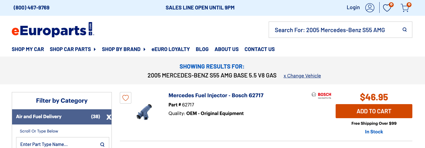

I don't know this company and have no relationship with them, but if I was buying, I'd use them. eBay is not the online Craig's List it used to be. Kinda hard to fake or maintain a 100% rating with that many sales (though the numbers do seem unbelievable).
Old Nov 14, 2023 | 10:57 AM
JettaRed's Avatar
Veteran: Army
iTrader: (1)
Joined: Nov 2016
Posts: 7,847
Likes: 3,496
From: Maryland
Even more reputable sellers are selling the injectors for under $47.

$349 sounds legit, the first link you posted at $106 definitely not Bosch injectors. Regardless I would go to a reputable place for genuine Bosch parts, take your chances with eBay
Bosch parts are counterfeited often , and very hard to determine if they are or aren’t.
eBay and Amazon are the Craigslist of internet sales, there is buyer protection which makes it safer, but counterfeit parts are rampant, especially Bosch.
