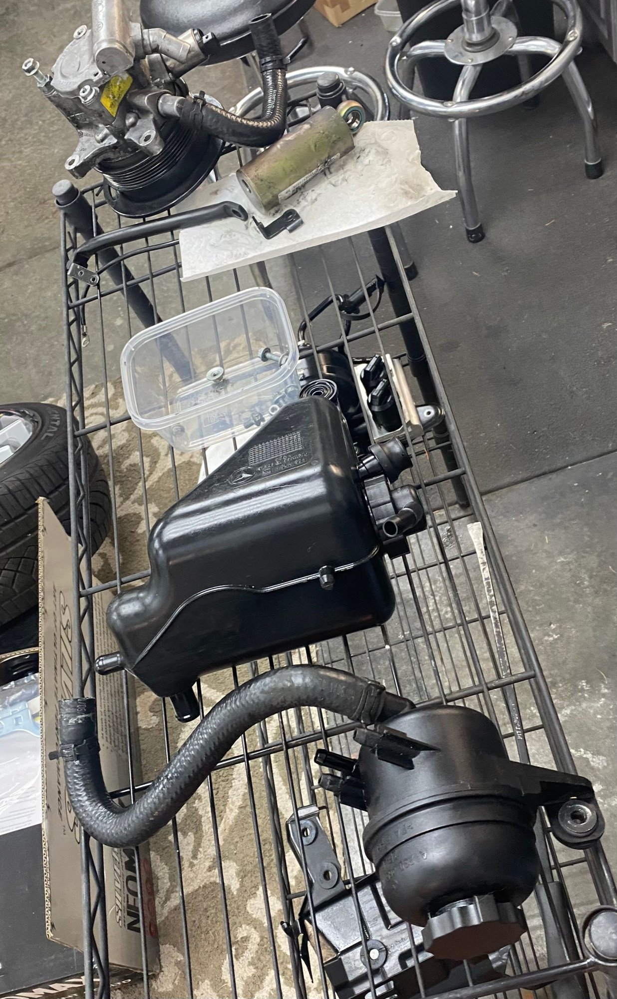

The decision to pull out the entire ABC system was tough but no longer avoidable. After searching out and acquiring the necessary parts I made the space to start all the removal.
The removal process has been fairly. So I have removed the the ABC pump, front valve block, rear valve block and most of the lines. The lines are the most time consuming and messy.
If anyone here needs the pump or valve blocks by all means let me know before I put them out for sale

It takes time to get at the parts you want to remove and then it takes patience to get the lines out
FYI; the front accumulator is 15 months old and 400 mi and paint still came off due to CHF

The whole point of the removal/conversion is reliability. The system was not roadworthy while it was diagnosed as “ no error detected “ by two different shops and my own DAS.
The hydraulic lines are by far the most difficult and time consuming part.
So far the process has been fairly simple but messy
