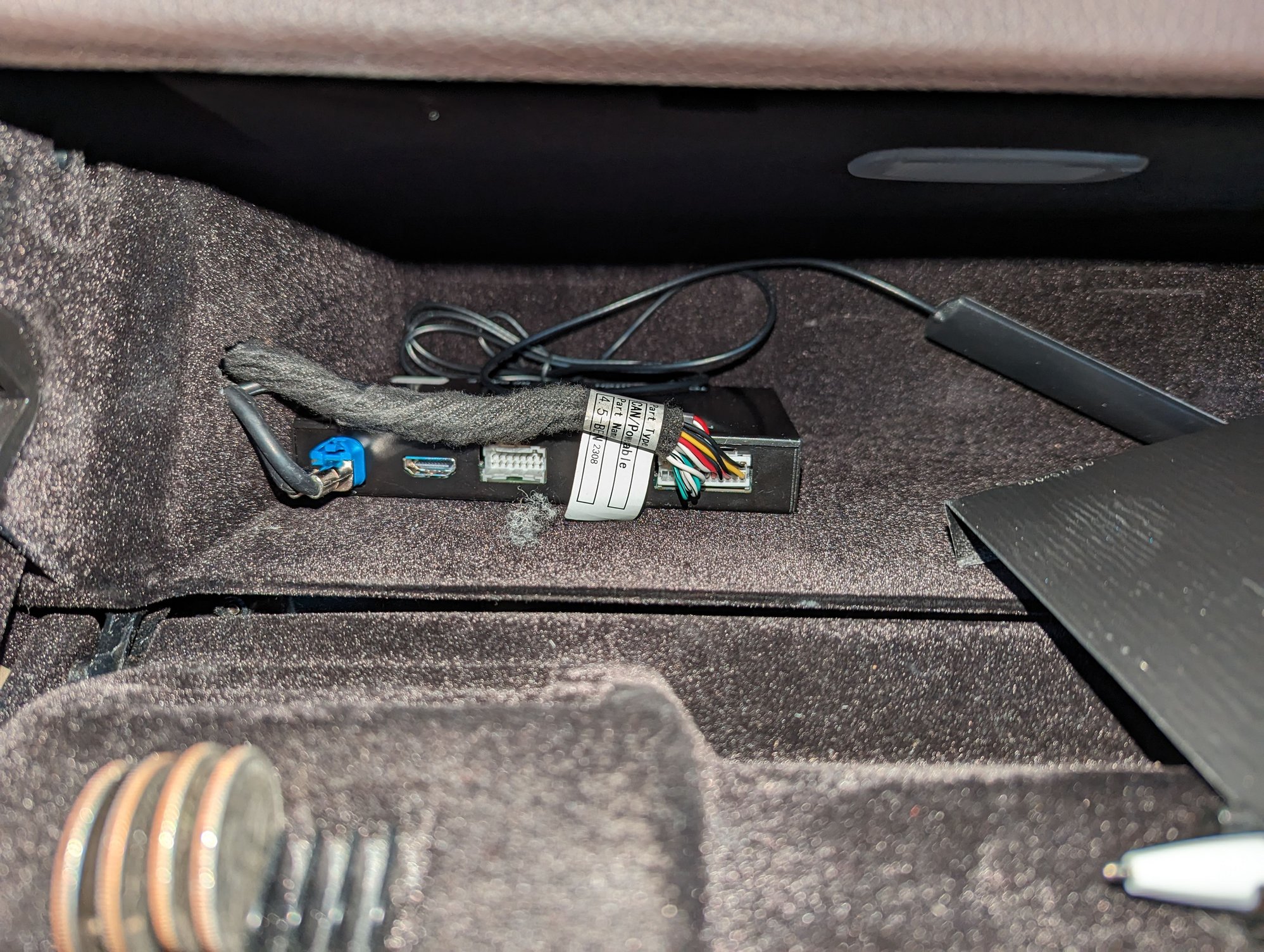

@Haz1 Good to hear. You might not want to cover the controller in a box as it may overheat. I know the glove box is enclosed as well, so it may not matter.

Folks, quick update. I've had this unit now for about 6 months. Zero issues. No overheating. No nothing. Just works. And I've changed phones and that was easy too. This system is WAY better, to me, then "updating" the factory maps, which are old before you start.

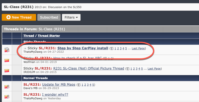

Read the sticky at the top of the forum. You get the kit based on your COMAND navigation version. You're probably at NTG 4.5 or NTG 4.7.

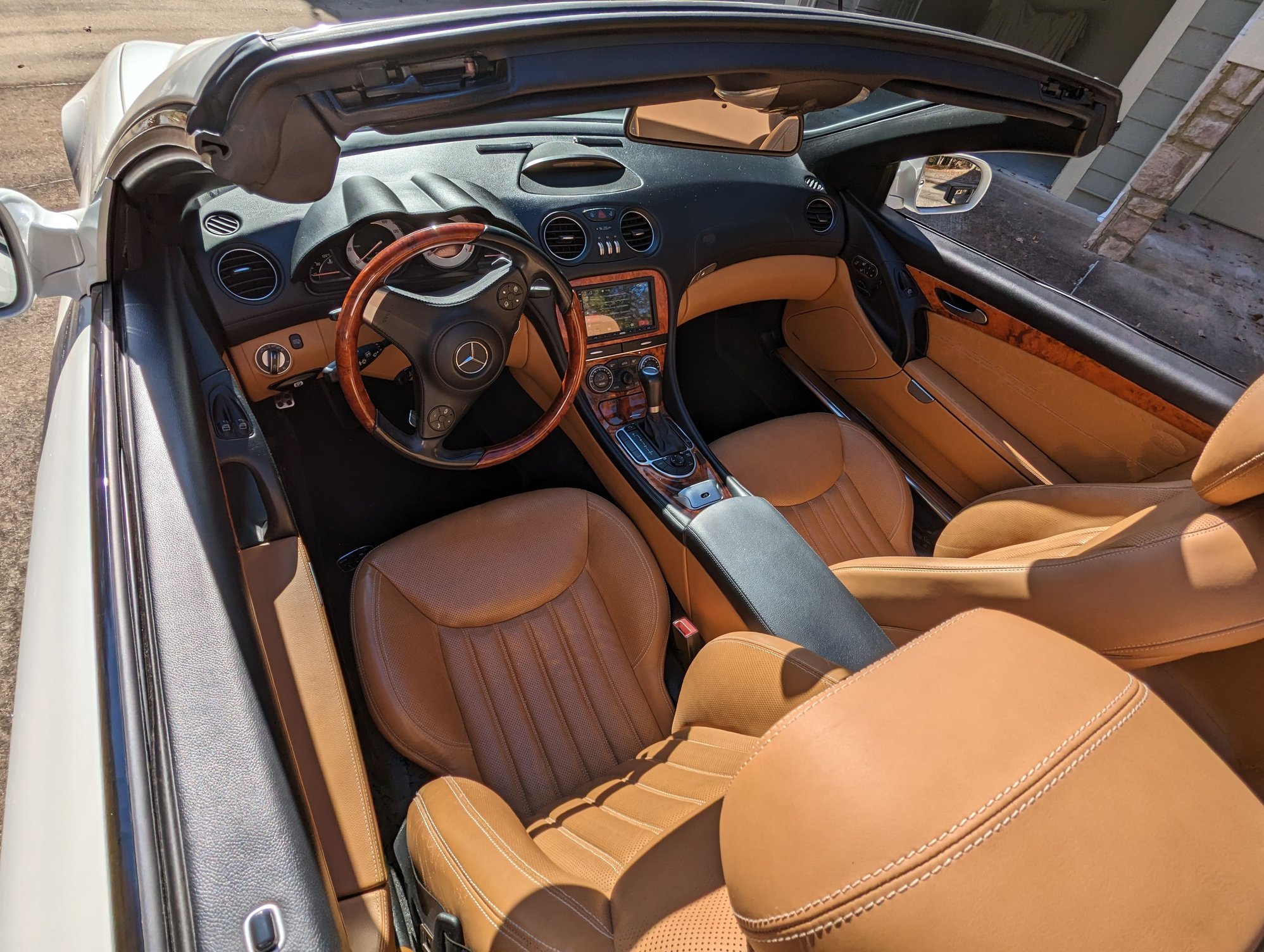

I actually did the reverse of you. Had a 2011 SL550 and traded it for a 2016 SL400, which is what I put the RoadTop unit in.
I also changed the head unit and added three cameras to the 2011 550, which "worked" but never did get the radio functioning worth a crap. Picture attached.
The Road Top Unit I used I got directly from them, but just checked via three browsers to see if I could find my order to give you a part number and couldn't get to their website so I'm wondering if they're still in business. I had emailed them and asked what worked. I "believe" it was the same as the SLK. I think it depends more on the radio model # as different cars use the same version. I'm attaching another picture of mine now. Can't find a model number on the cable seen in the photo but might help.
I did find the email exchange I had with them in January of this year and this might help:Through the original car owner menu page you provided, it has been confirmed that your original car system is NTG 4.7 and is compatible. Please feel free to purchase.
