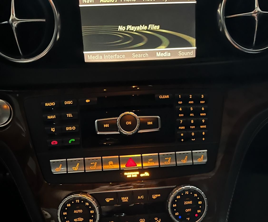

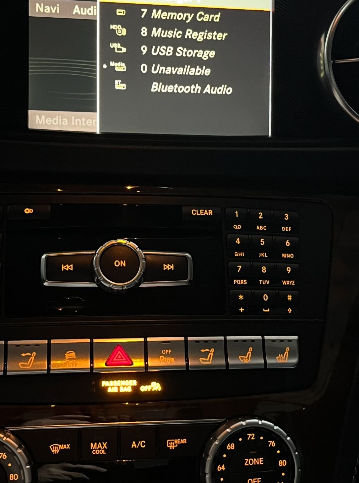

So I purchased an original MB 30 pin to lightning music interface.
The console shows no decide available, but the music plays!
The audio quality is noticeably better than Bluetooth, but the display shows "no playable files".
My car is a 2013 SL550, my phone is an iPhone 13.
is this a compatibility issue?
Display shows \"no playable files", but the music is playing. Tried itunes and spotify.
Phone is connected but Media shows no device available.

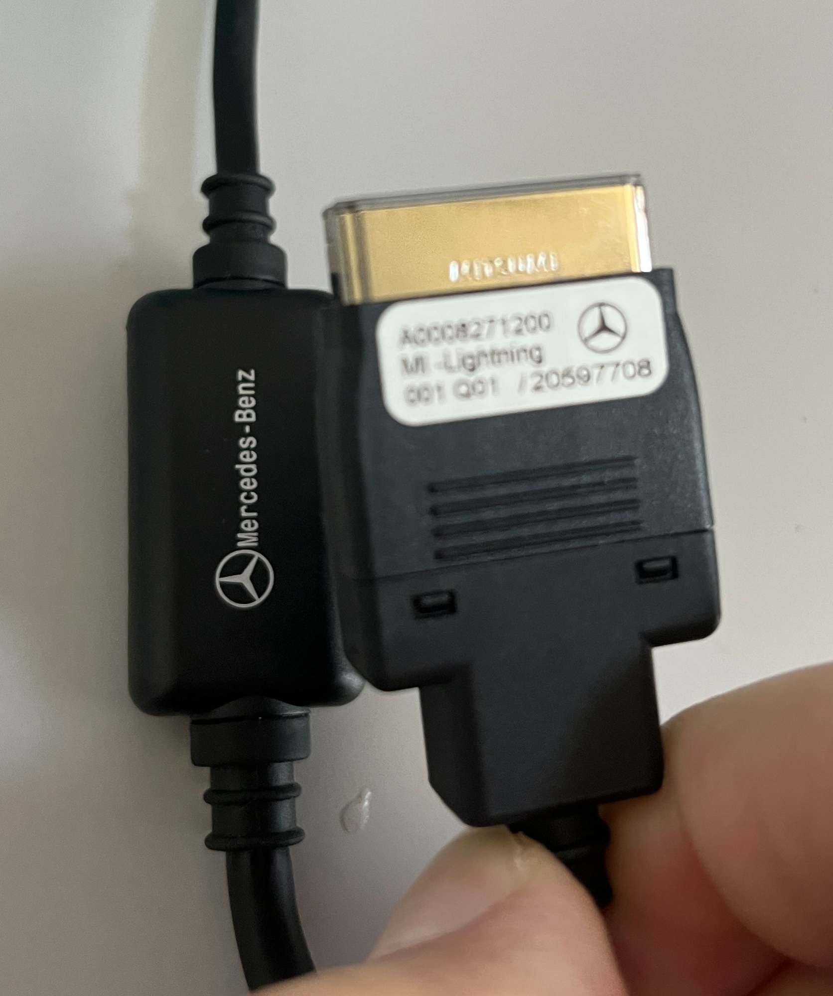

The adaptor i bought seems legit.
see pic below
Old Mar 12, 2025 | 10:19 PM
crconsulting's Avatar
Joined: Feb 2021
Posts: 1,419
Likes: 738
From: Nor-Cal
2020 GLC300 -2014 Sl550 - 1997 SL600
Adapter looks good, at least visually.

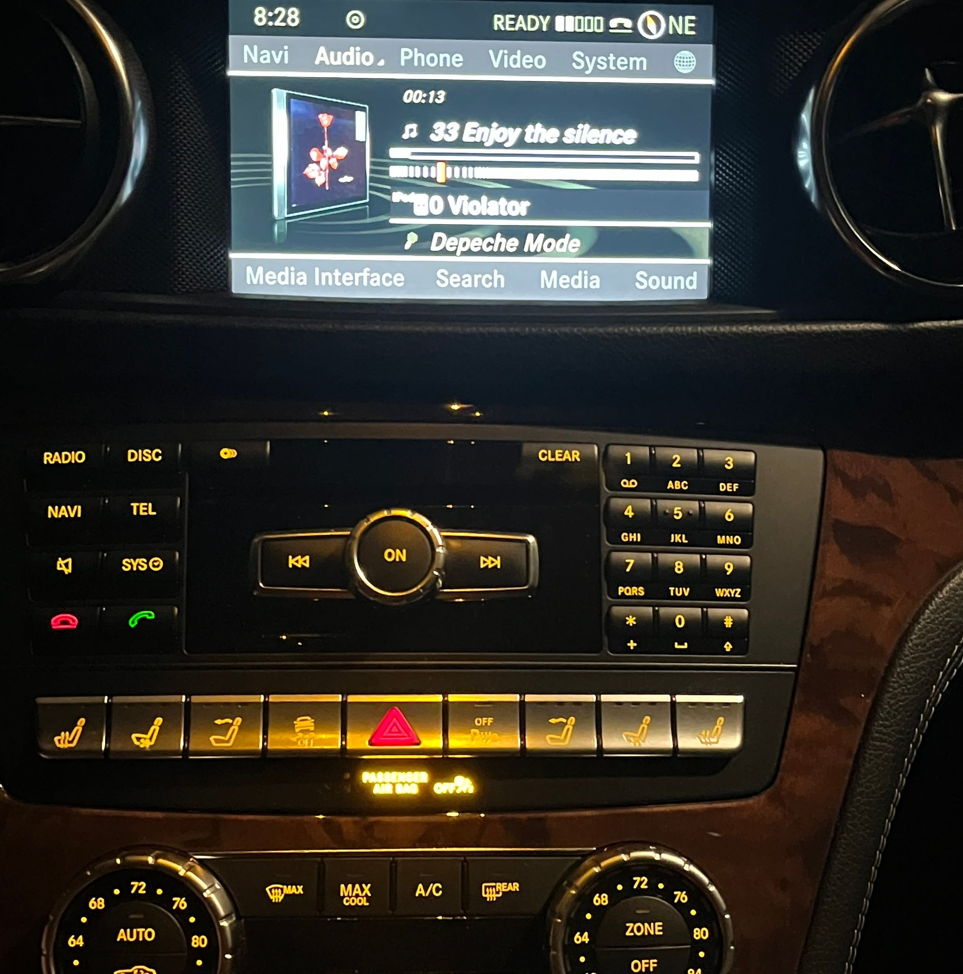

Finally got it working.
I purchased another adaptor cable, part number A0038270904
and it did the trick.
Evidently, my previous purchase had a malfunction.
