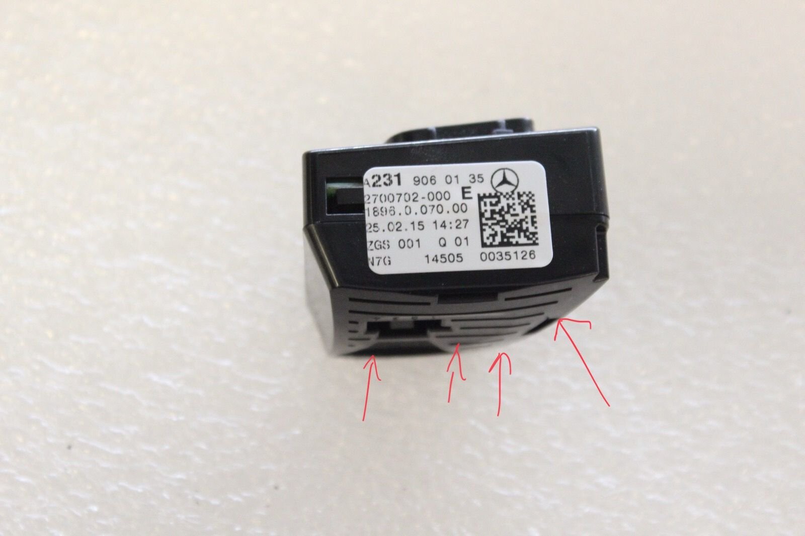

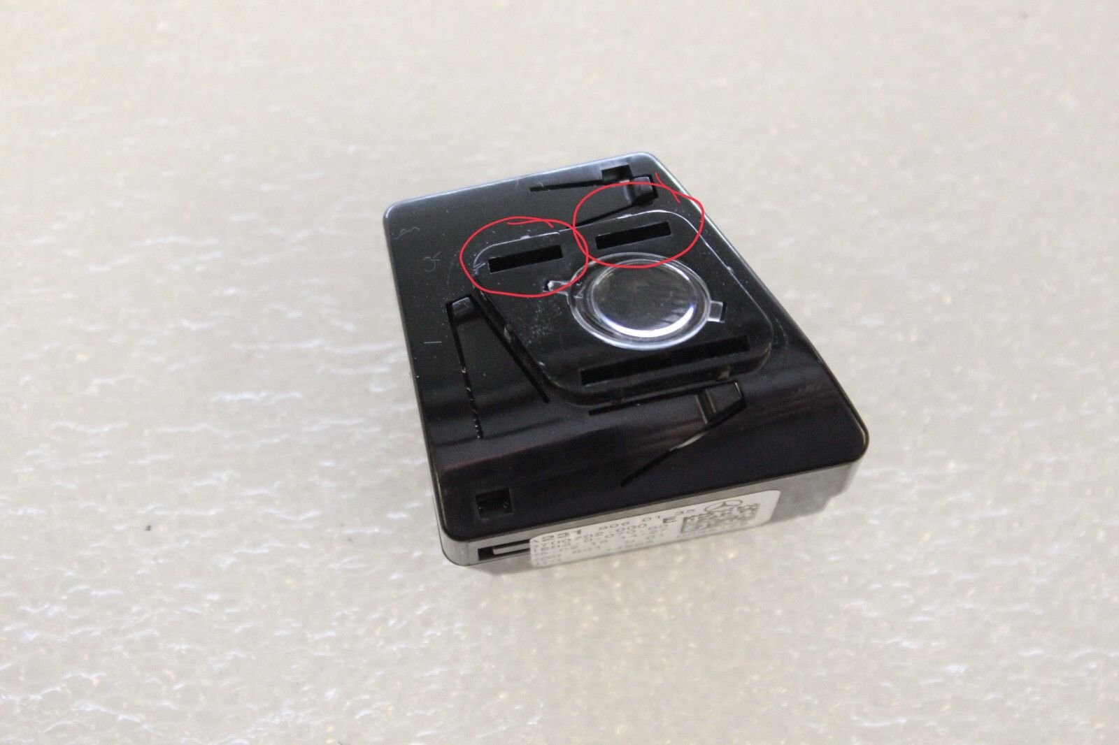

Those LED’s are typically replaced as an assembly. (you can get them for $25 on eBay btw)
It looks like the part itself is vented in the back and a couple of slots in front (up top and long one on bottom)
Easiest approach:
So if a bug got in, chances are you can spray some office “dust off” in there and it should come out. If you have a compressor, that would probably work if you need more pressure. Not sure if that lens pops off or is glued on as they’re LED’s, so typically they’re replaced as an assembly. It’s probably glued in.
But think air is pretty easy first step.
Last resort, you may have to remove the part to get air in the back slots with a compressor.
Good Luck.

@crconsulting
Thanks for the photos of what the assembly looks like when pulled out!
The circles in the first picture are where the cover trim clips into. I tried blowing air into it from the front (while still dangling inside the A pillar) but no luck so far.

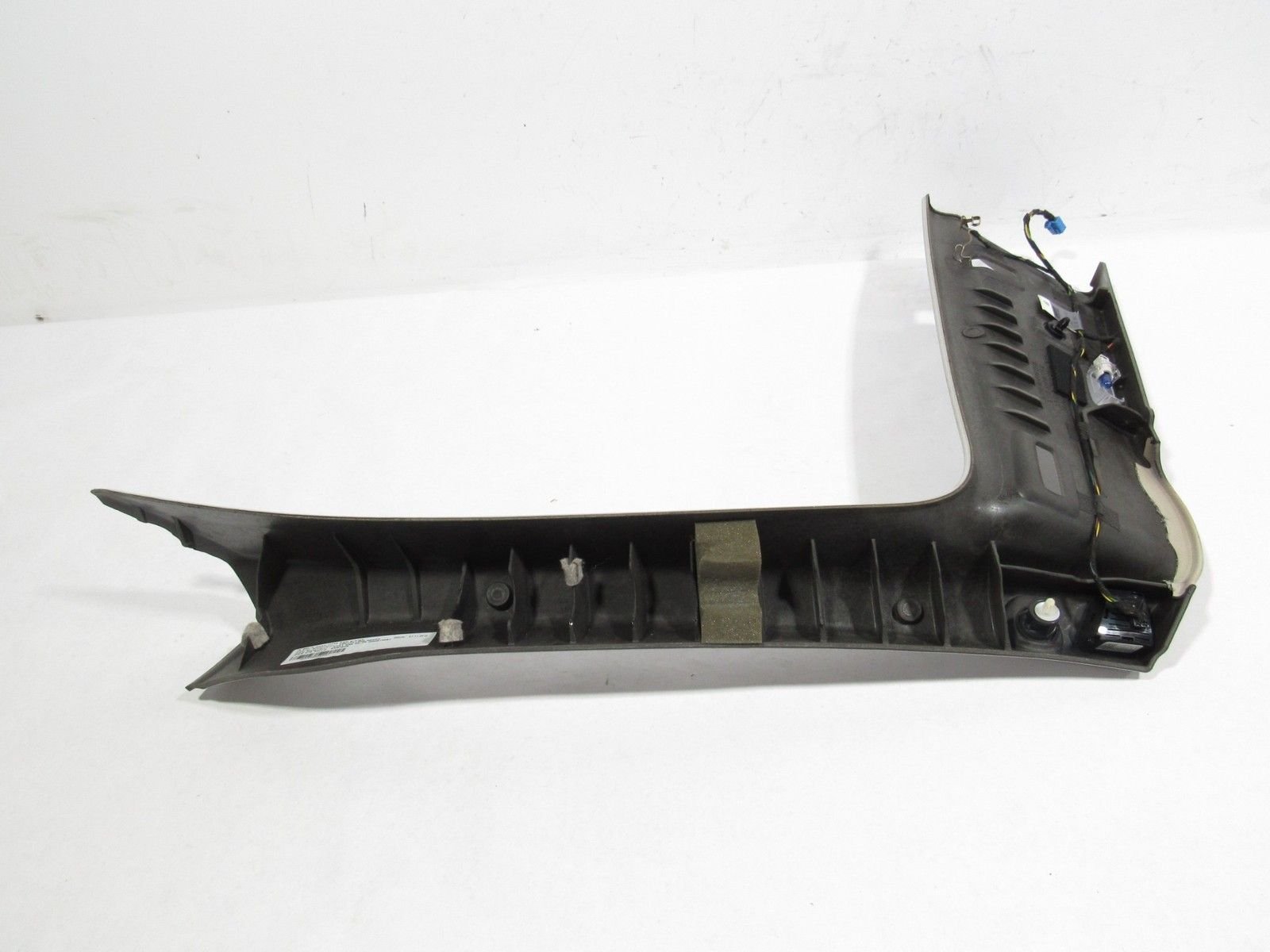

This should help,
see attached WIS section and image of the back of panel.
Those clips can break, so pry gently. They should be available separately though.
You can see once you get it off you have pretty good access to the back. Probably how it got in.
Good Luck

Success!! Was able to pull the A pillar trim off following the instructions and some compressed air and some shaking cleared the insect from the light housing!
Unfortunately, did manage to break the black clip that is closer to the center overhead control panel... but a little bit of superglue and some time to cure and I'll have it back together shortly.
Thanks again for posting the instructions!
