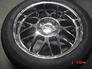

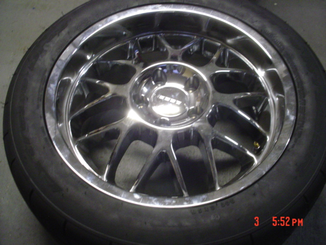

I'm running a Rial Nagaro wheel (18X8.5) with a 265 Mickey out back and have had success with it. No clearance issues, it bolts right up.
That said, I know Sean (thericker) is running a 16" CLK wheel on his SL600. I'm guessing he's running a spacer, but ping him directly to confirm. I also believe Sal (URNext) was also running a 16" CLK wheel for his record setting run.
My setup:
SAL's setup:
Sean's setup:

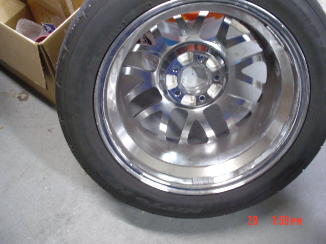

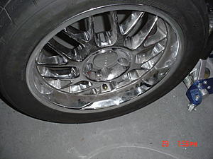

maybe u want these, voxx 17 x 9 jim
Attached Thumbnails Drag wheel question-voxx-wheels-17-x-9-002.jpg   Drag wheel question-crossfire-wheel-lug-002.jpg   Drag wheel question-crossfire-wheel-lug-003.jpg
