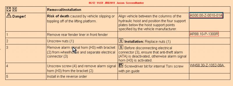

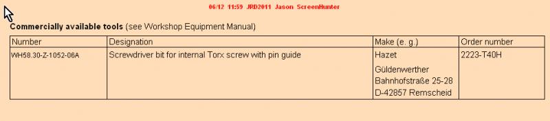

The only part # I could find for the horn on a 2003 SL55 is:
A 230 542 01 20 = Front right 400Hz horn
Here are some screen shots from the WIS on how to remove + install the horn:
Hope this helps

You found the correct horn. Its simple to remove and replace. Shouldn't take more than 20 min.. Part can be found on Parts.com
Attachment 212085
Attachment 212086
Attachment 212087
Hope this helps
