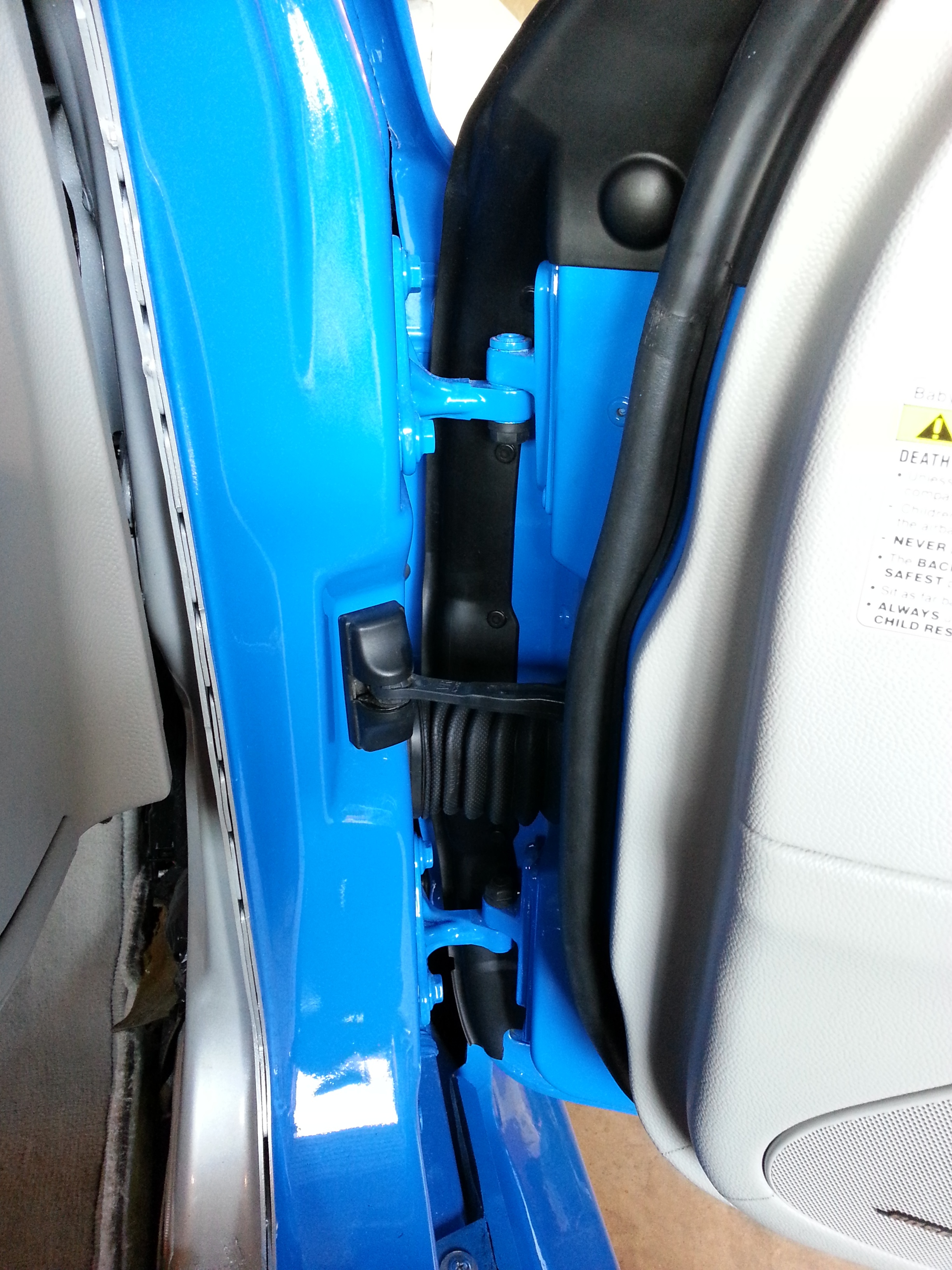

more.

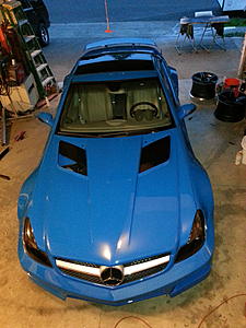

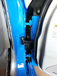

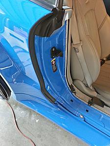

since having it completely apart, every last little area of the car has been cleaned also, making it a super clean car now. i think my rain days are over, again. lol

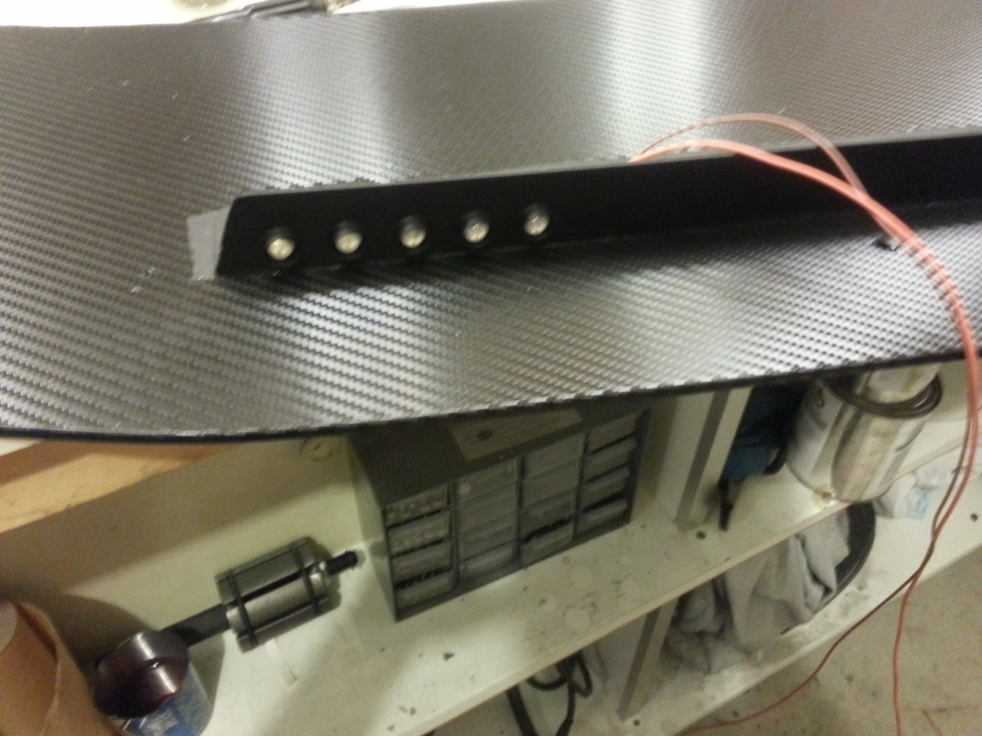

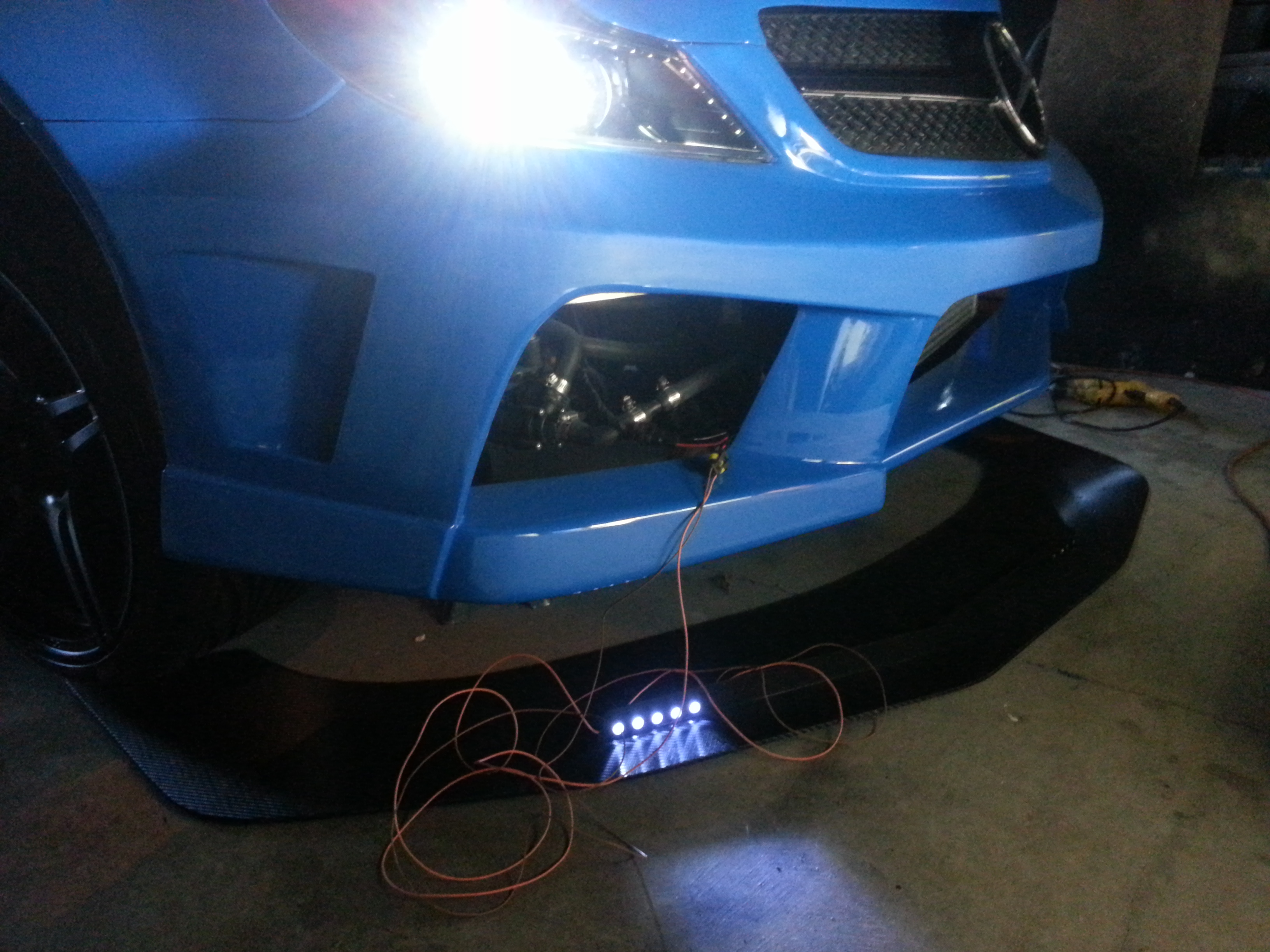

the soon to be fog lights. 5 10mm super bright led's per side mounted in the splitter. should work great and blend in good too.

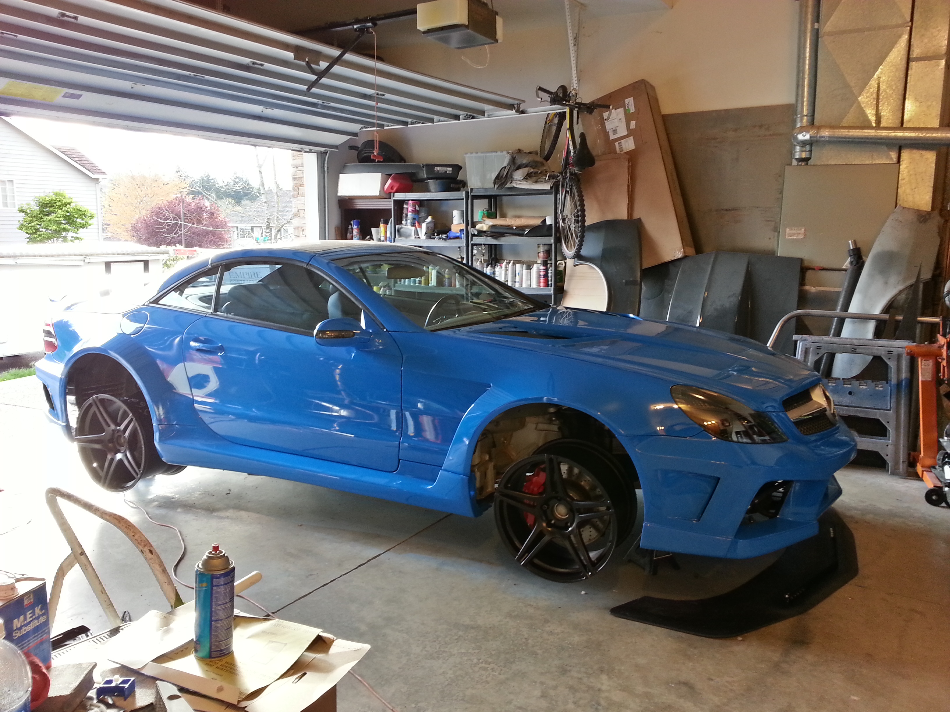

still none of the front body work or side skirts is aligned or fastened. that will only take an hour or so since all my alignment holes are already done. should be able to wrap up most everything tomorrow. still have to open trans though and make the exhaust tips. so i figure end of monday or tuesday i can finally set it down and do the cut and buff!!

Working my way around the car now doing stuff to completion. The front will be last which includes painting grill.

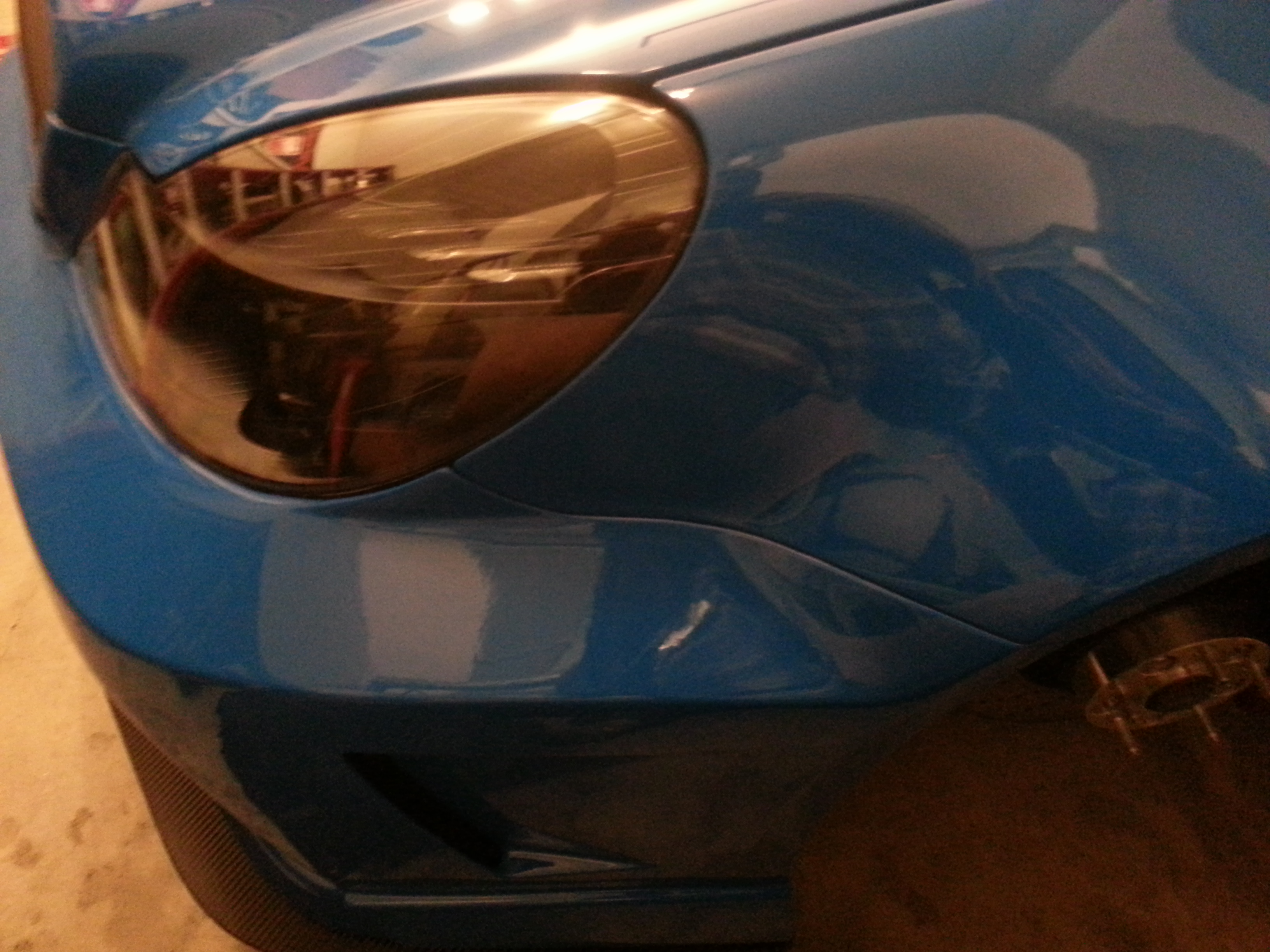

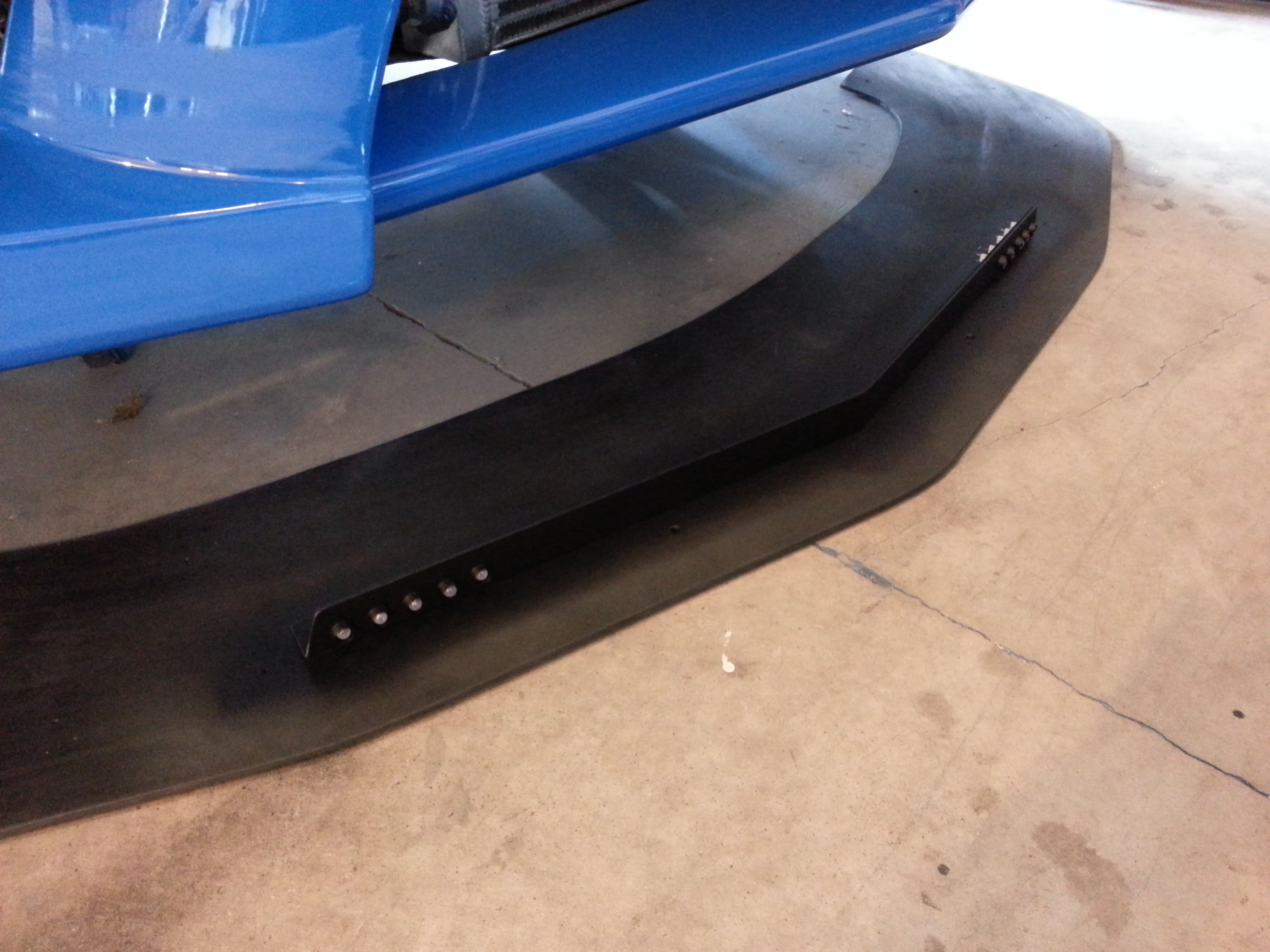

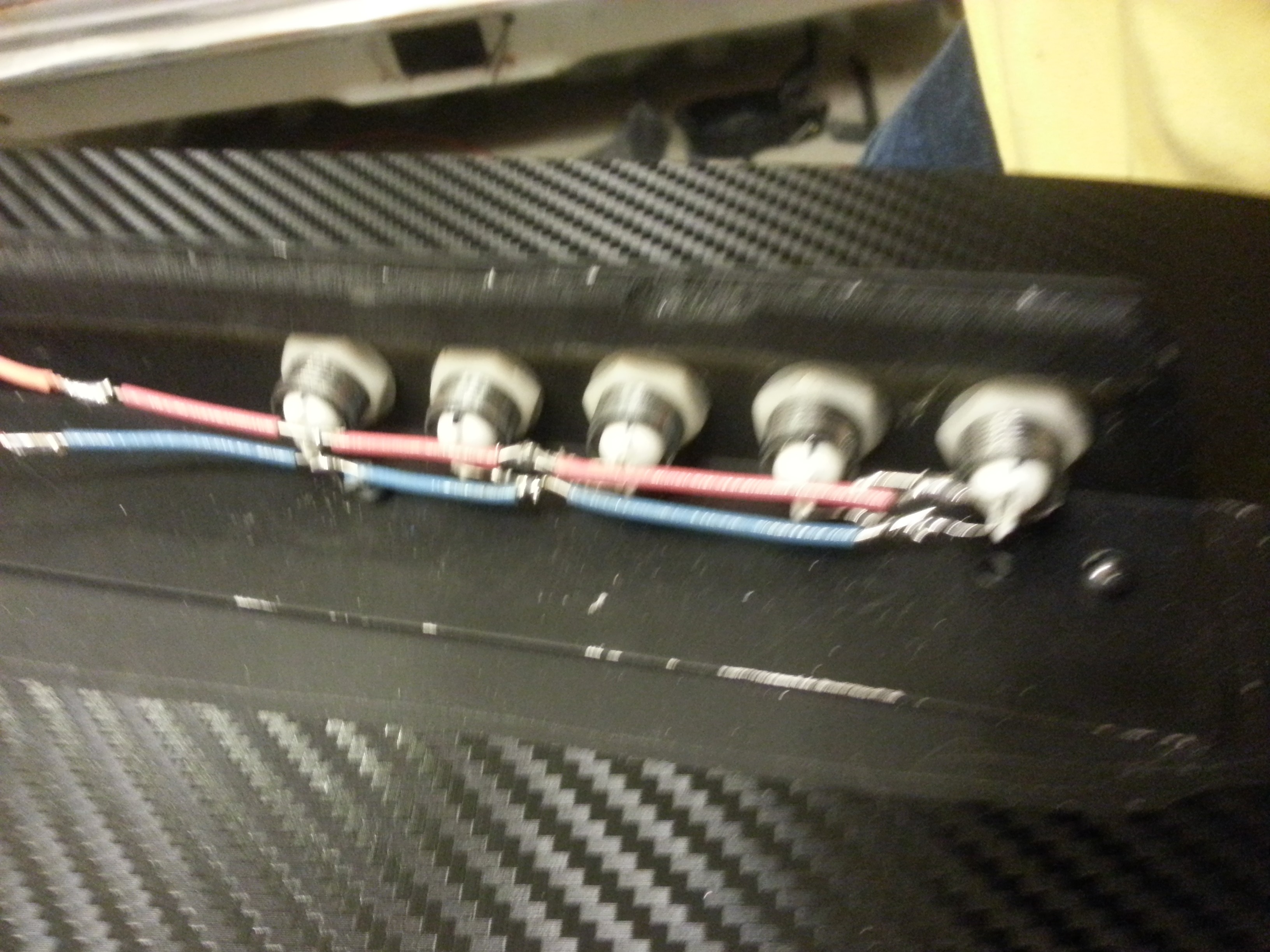

here is the fog light build.
starts with 5 10mm super bright leds per side, mounted in the front splitter. i found the correct resistors for the fog light circuit so no error codes or blinking. wired them in parallel. tough to do the small soldering and not melt the other closest connection again.
front side. used screw in 10mm led holders.
test.
after the "wiggle wire" test, i encased the whole thing in silicone.
while they do not look bright in the pics, they are. these leds are focused like a typical headlight. in the actual beam it is very bright. i tested it at night and it creates a beam and brightness very similar to the stock fog lights.
hard to get a pic, but here is the work needing to be done in rear wheel wells to get them sealed back up like it should be. all work was painted a textured black when done.

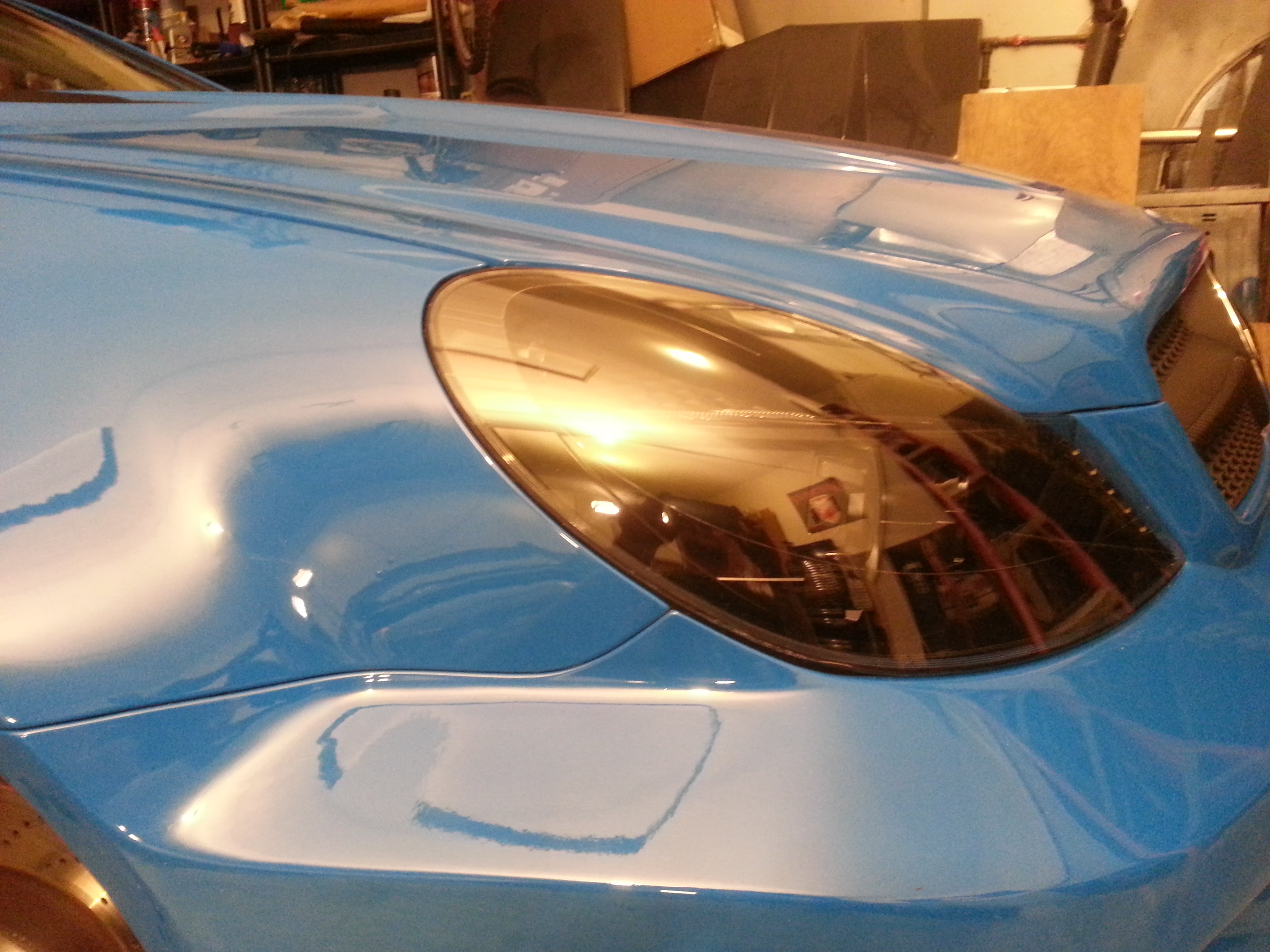

thats how that should be.
started the cut and buff now!

Are you kidding me!!!
That paint looks fukn flawless & fitment spot on way to go Scott! What'd you do to the headlights? They appear to be covered in a tint of metallic film?

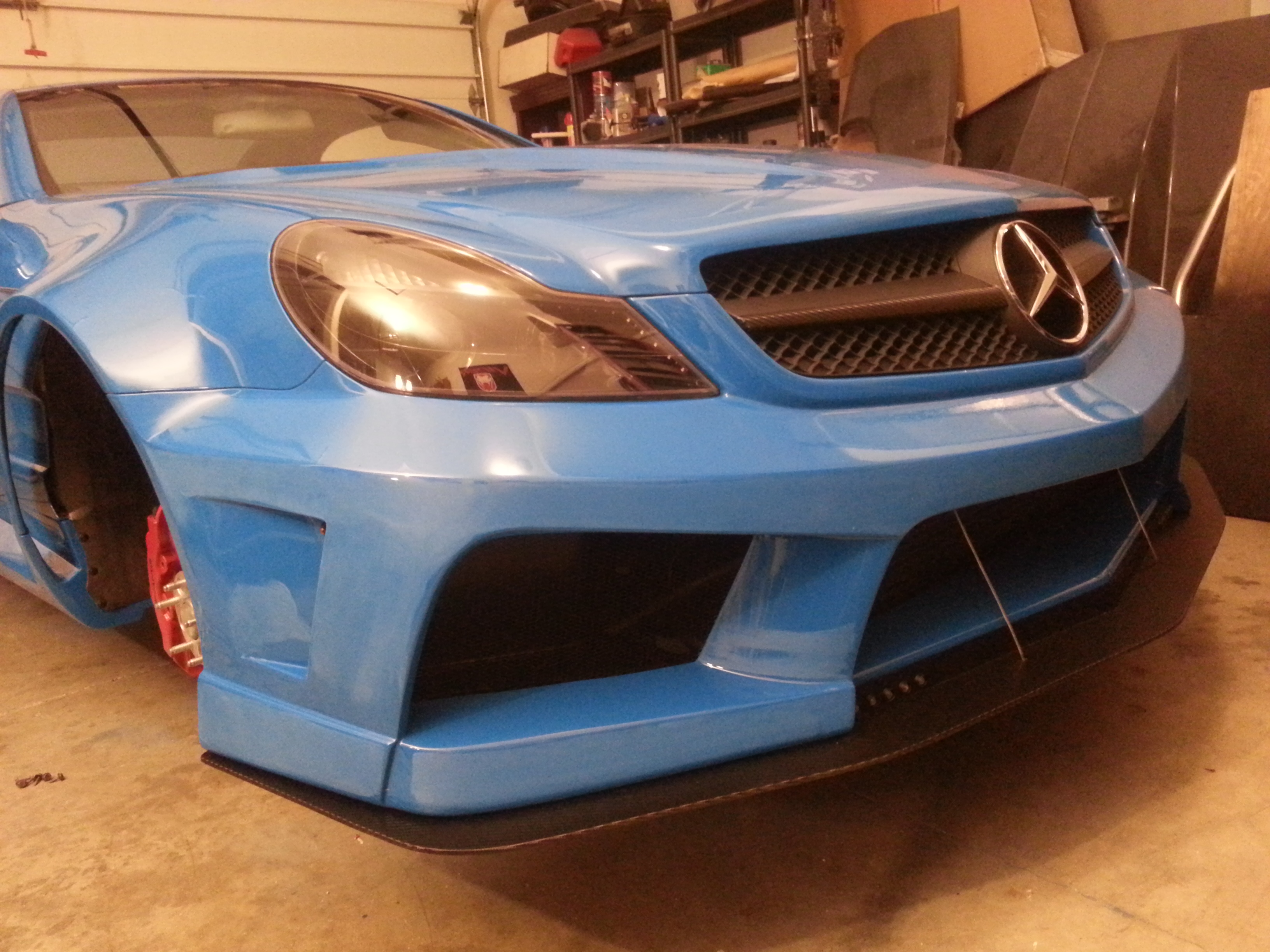

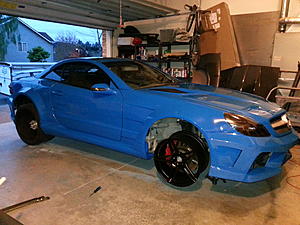

thanks guys. i think everyone here knows what i started with and the time it took it took to reach that final result. i'm just happy to be able to say "final" atlast!! haha
another pic with splitter installed and the fog lights. i started to sand side of bumper, so thats why it looks different.
