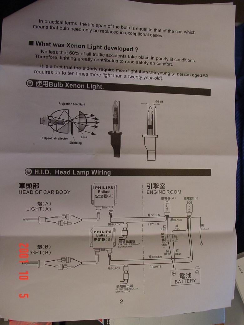

2

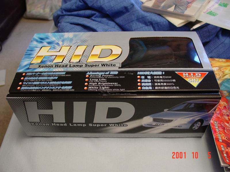

4

Thanx Supra, do you have some pic of installation of those HID in your SLK (where the ballast go, etc..)
