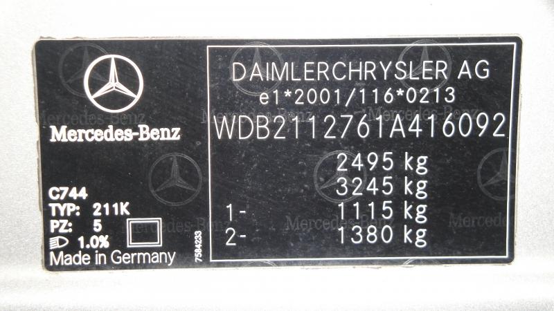

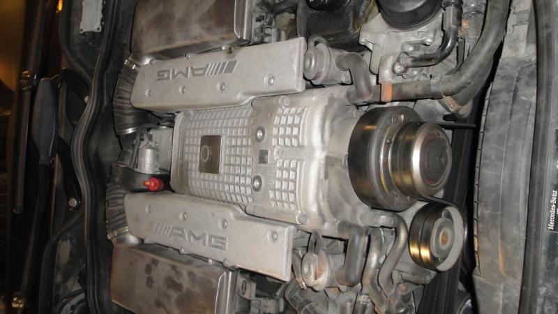

E55 113 engin replacement
I have a 2003 E55 AMG station vagon and need a replasement engine.
Can anyone tell which engines fit in this car preferably a bigger one.
The engin is A113 140 0 412
The 2003 E55 is a W211. This is the W210 forum, so you won't get as much help here. I would start a new post in the W211 forum.
If a 5.4L supercharger V8 isn't big enough (and lord knows it's not), you're looking at the 6.2L V8 from the E63, which will probably fit but require all sorts of electrical work. This really is a poor choice, because you're losing forced induction with this motor and really taking a step sideways, if not backwards. Your next option is to shoe horn the V12 twin turbo.
You probably want to replace the motor with stock, and just add a pulley and ECU if you really need a 7 passenger car that does 0-60 in under 4 seconds.

vidarsig's Avatar
Joined: Nov 2010
Posts: 4
merzedes
that rules out a begger engin.
so the 113 is called w211.
This is what I need to replace my broken engin ?

Fabio D's Avatar
Joined: Nov 2008
Posts: 1,560
Likes: 10
210 55
W211 is the chassis designation for your car (W210 is the old E class 95 - 02)
M113 kompressor is the engine designation for your car (M113 N/A is the V8 same as yours but normally aspirated)
You need to go to the W211 AMG forum not W210 AMG
