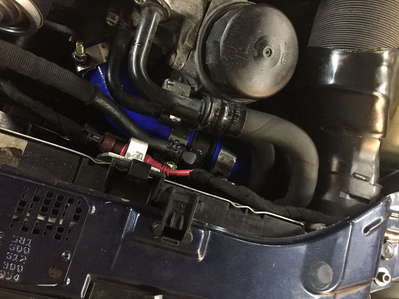

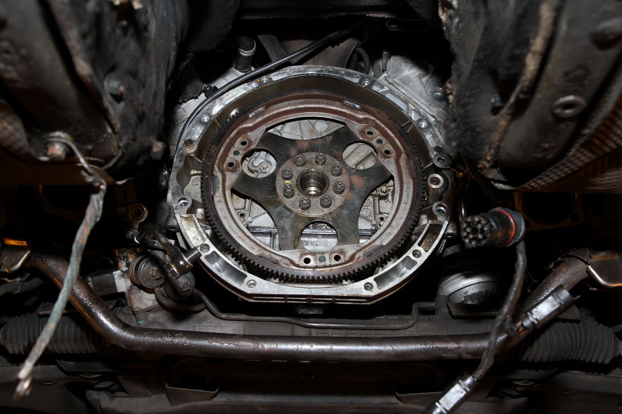

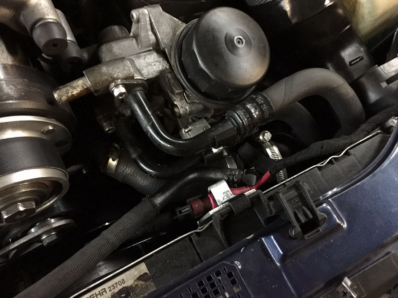

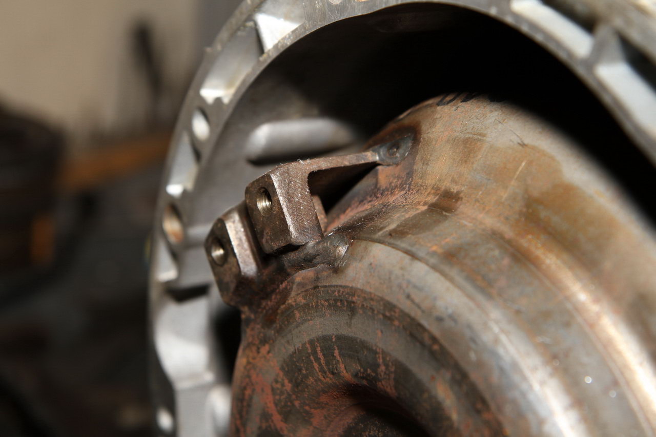

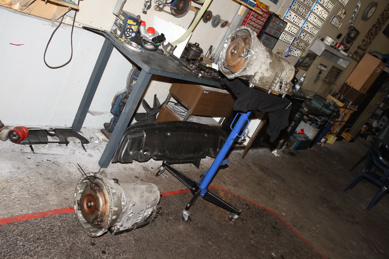

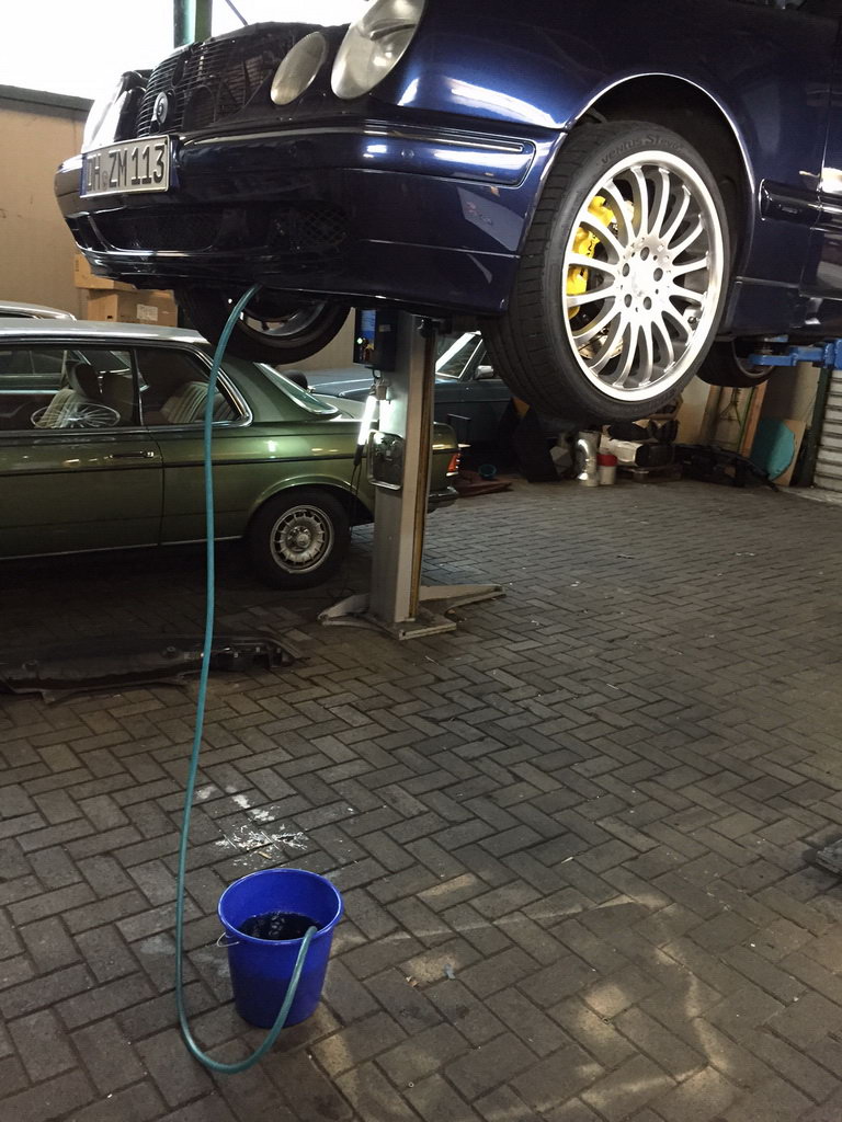

Several Updates...

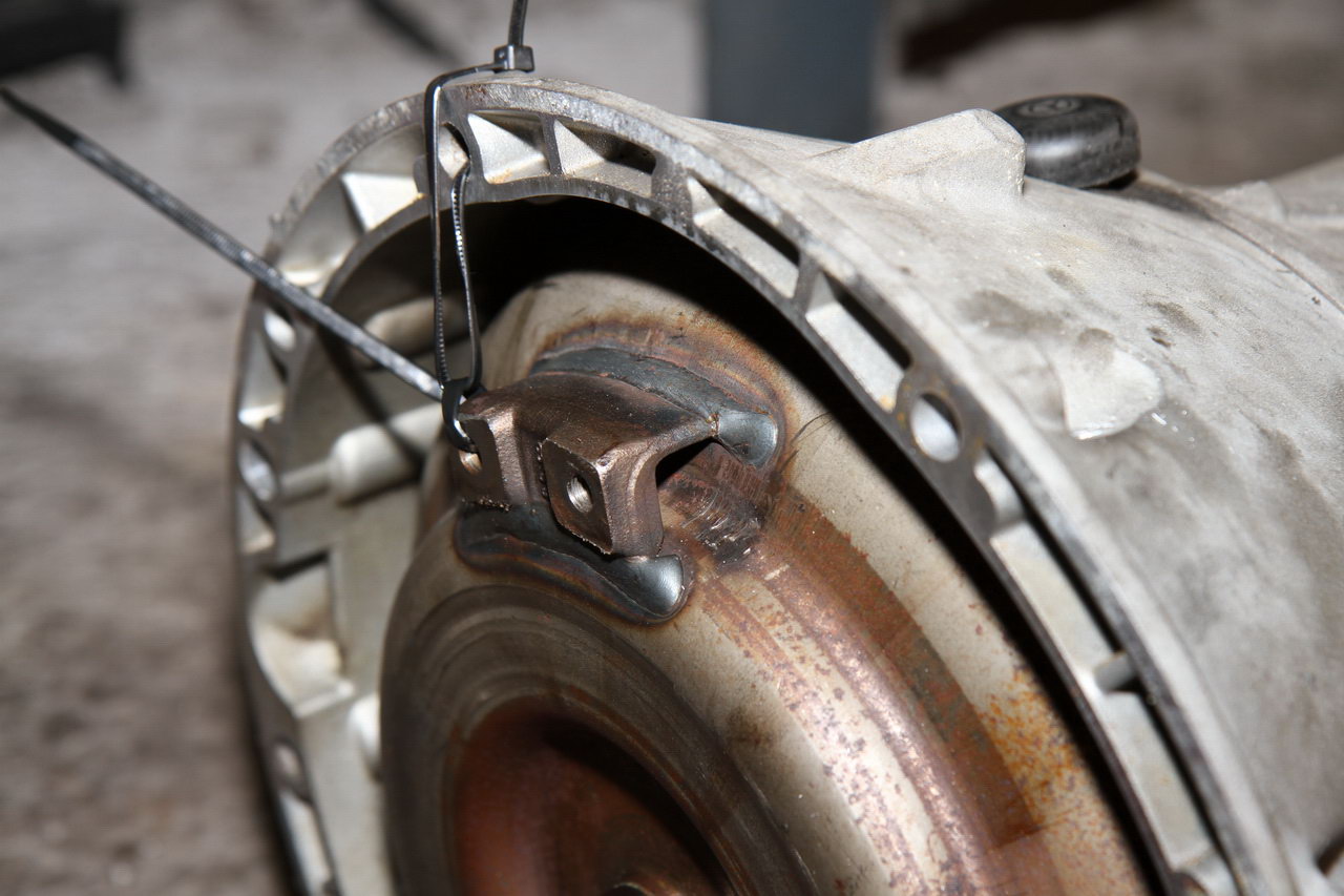

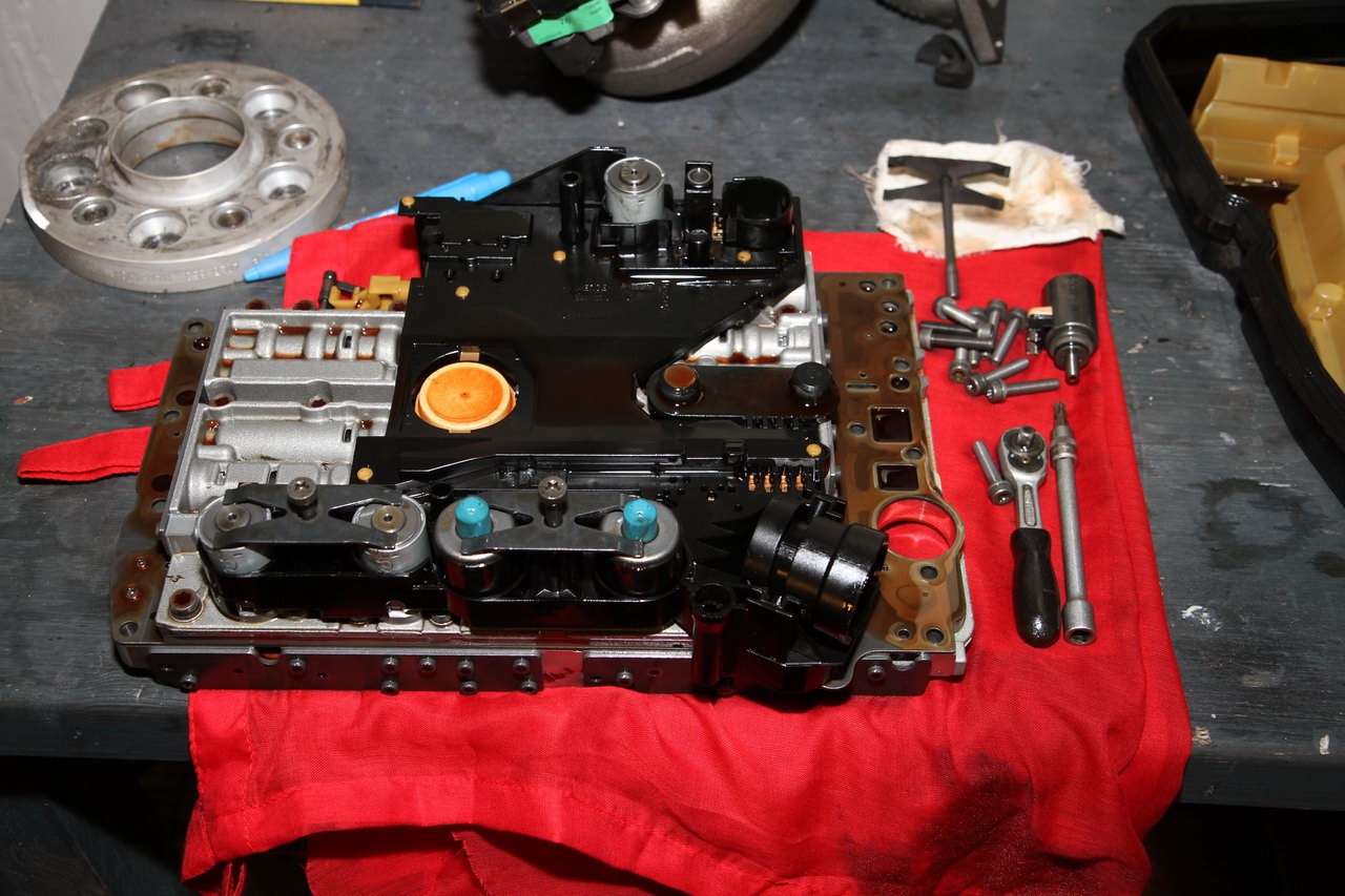

I threw out the SL55 722.643 Transmission and installed a SL65 722.649 instead. Shifting is nicer in some kind i cant really explain
722.649 Electrohydraulic Unit
torqueconverter from the 649
torqueconverter from the 643
722.643 and 722.649

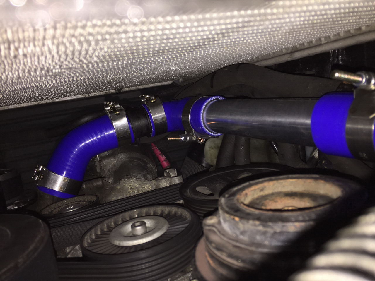

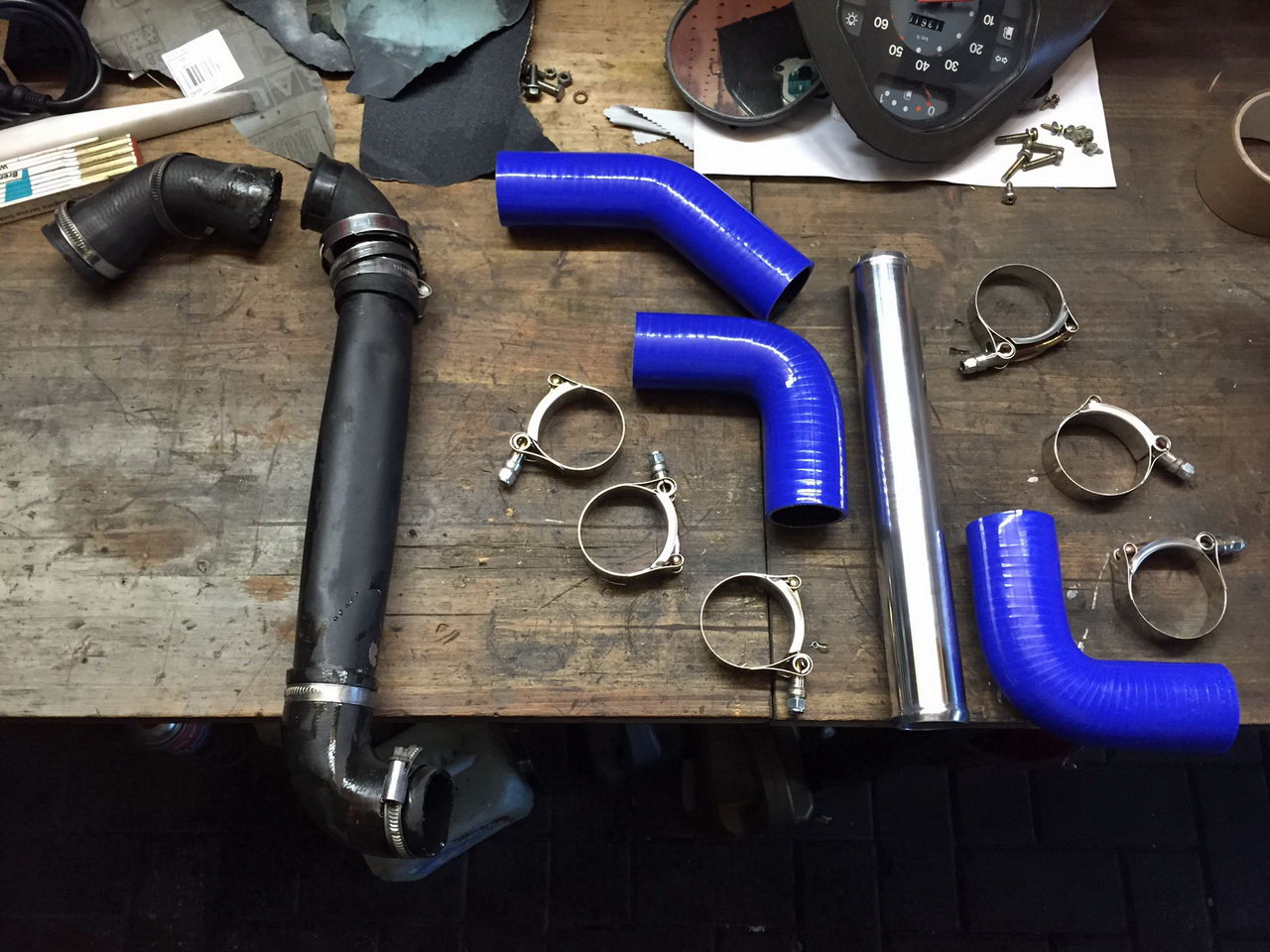

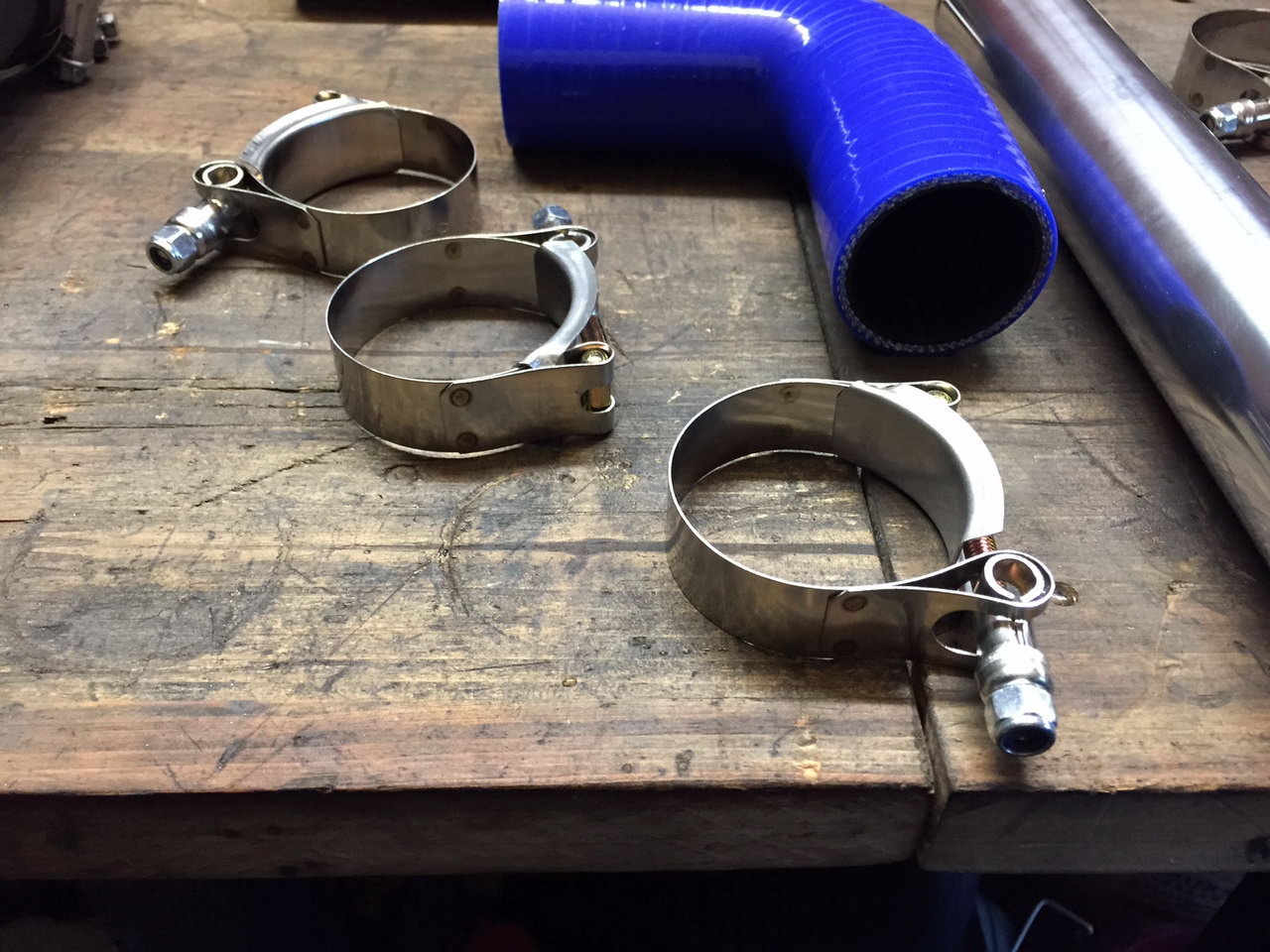

also i installed new hoses...

Excellent Fabian..,
when i taste the shifting of 649, can't go back to the stock, it's great..,,
very good hose fitment, like the way of alloy tube/silicone than plastic/rubber..

W109 300SEL6.3, W123 280TE, W123 200T, W210 E55
The 722.649 has a total different torque Converter wich can take up to 1100Nm of load
