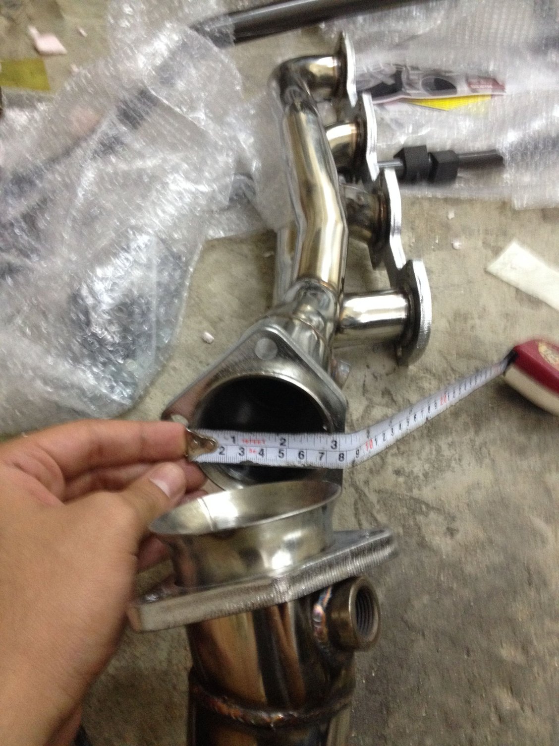

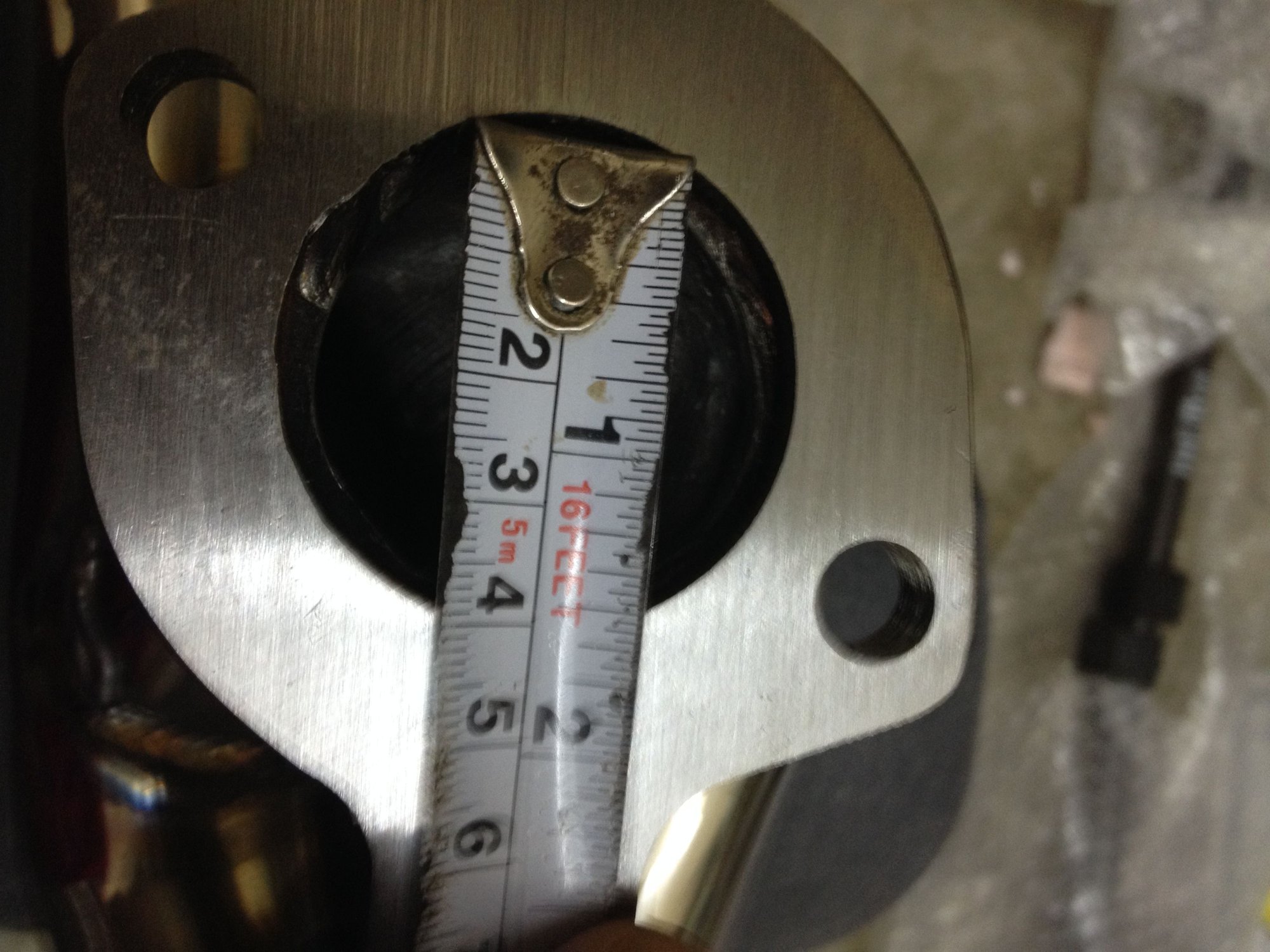

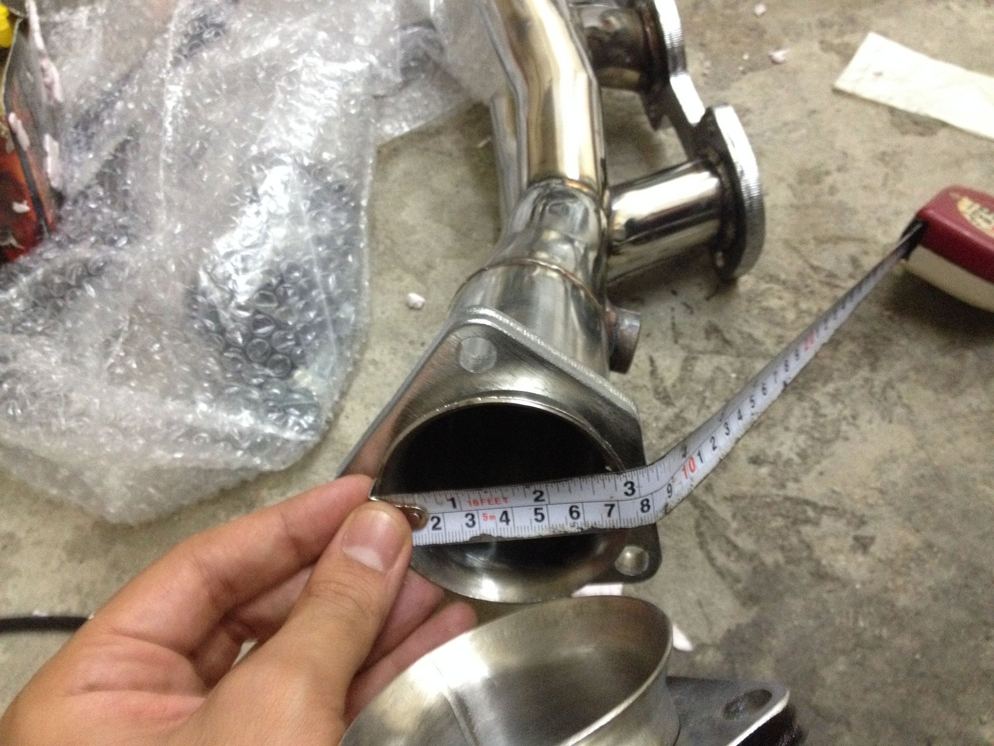

I measured it 3 inches diameter and
Eisenmann Exhaust pipe is 2.5 inches
3 inches....wow, you might have to change all your mid and back pipes to 3 inches

Size slots Clement Headers and Down Pipe
no need for 3in med pipe 2.5 is inof(As said by Fabio) let the images speak for heders Size

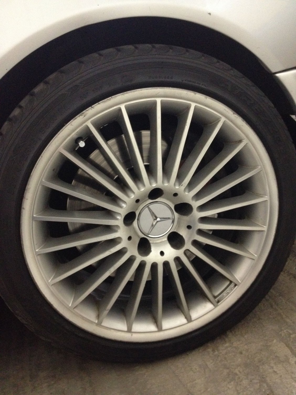

I own this rim now18 the first owner bought her I think she's good now I think I am trying to faind rims 19 you can put some suggestions and if possible some pictures (let the images speak)

ok, the downpipes connect to the mid pipes in the Kleemanns, I forgot..so 2.5" on the back pipes are just fine.

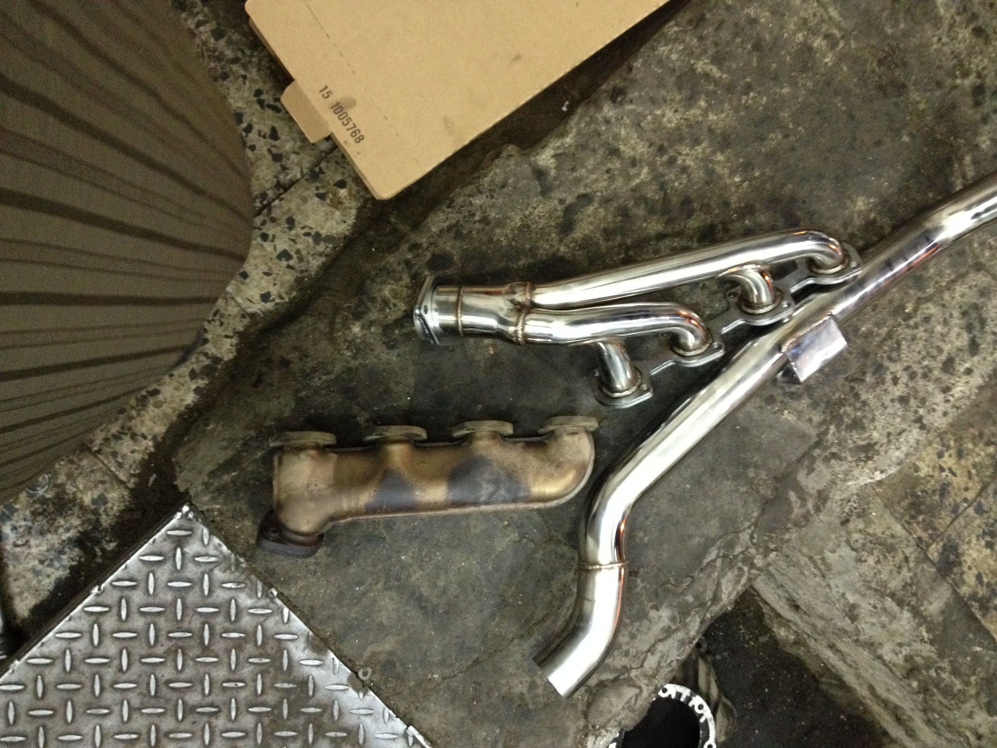

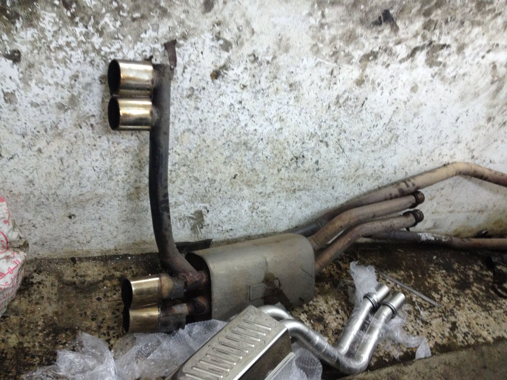

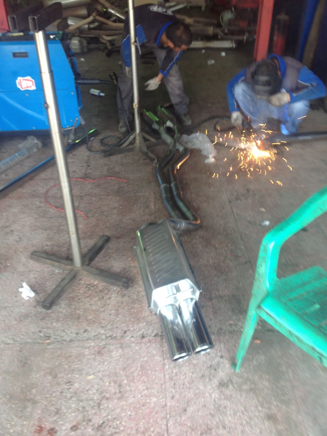

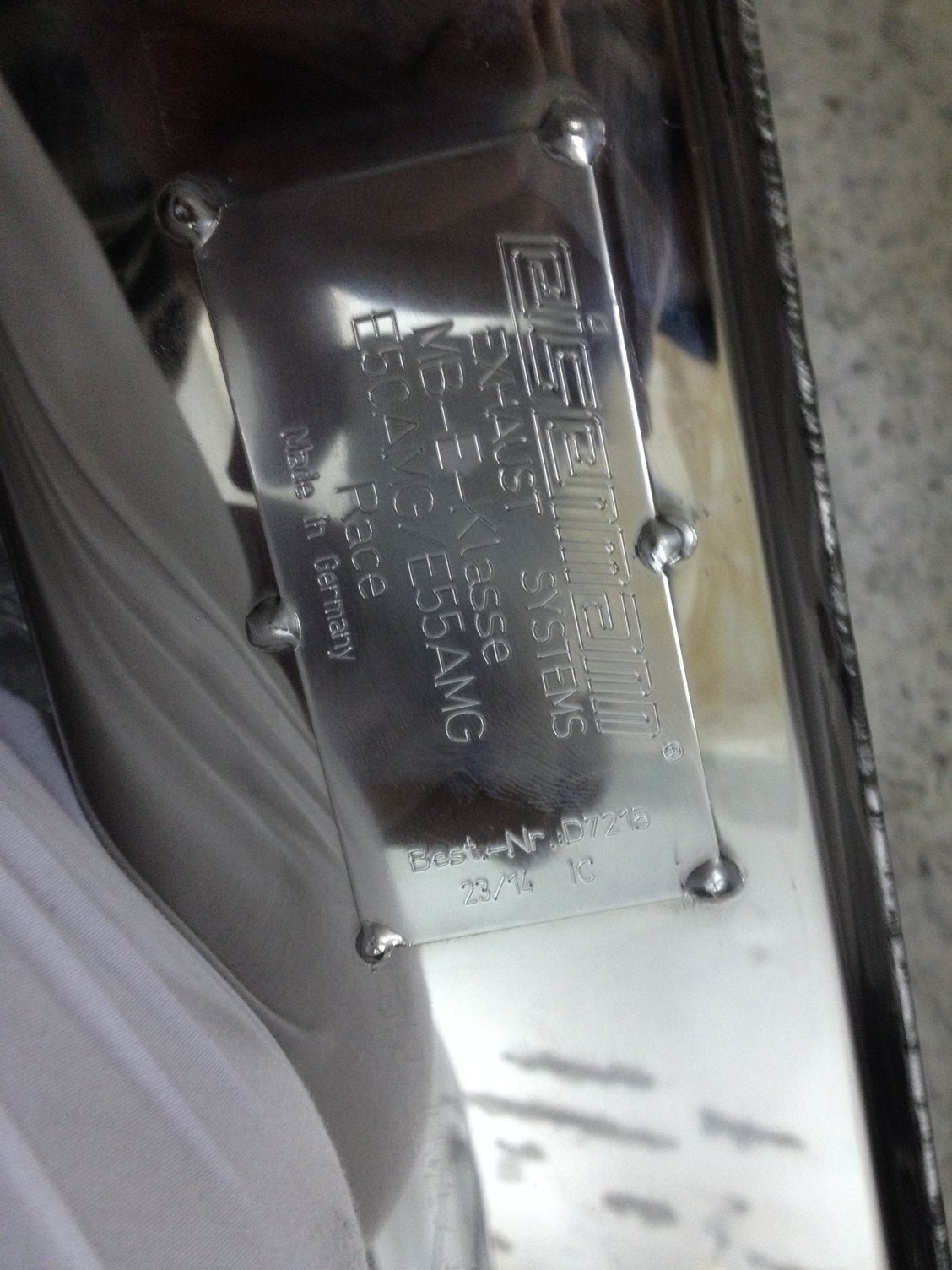

Some images during installation. Note During the installation Headers next to the driver who ran into some difficulties I had to steer the car to the mechanic because of steering column.
There are some pictures about the quad pipe exhaust installed in my car from firest oner I think that in a bad way to install and you can get an idea of their work better
Note: during the decoding old Headers discovered that the nuts and bolts are made of copper with the knowledge that all most cars made ​​of iron, and this makes them not subject to rust over time excellent movement from Mercedes in e55 w210

Just make sure you turn the steering and also make sure the heat shield does not hit the downpipes on hard acceleration with the Kleemanns. Best of luck to you on your install and hope everything works out. The Eisemann race exhaust will sound so awesome in the car

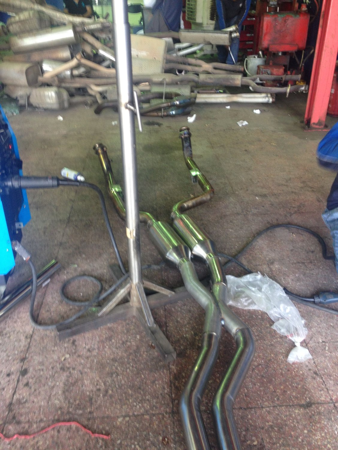

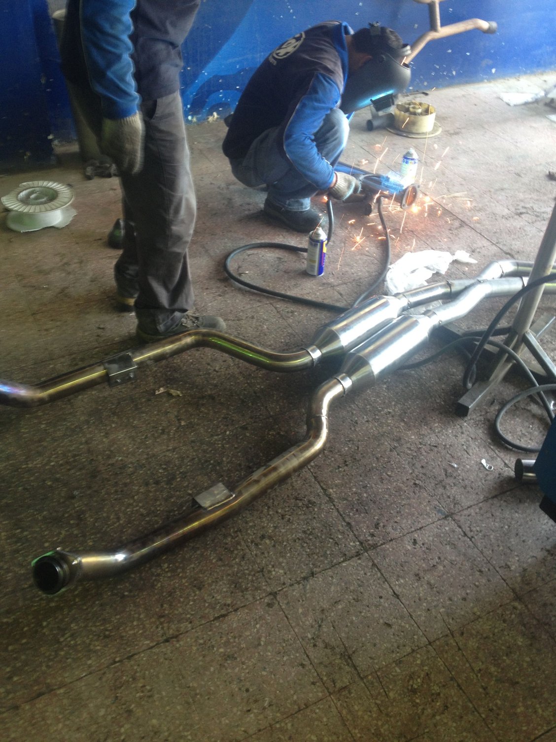

Been mounting
Hello everyone and thank you for your co-operation project with me in my car
i inestal heders +xpaip+exhost Sound very high feel it inside the car and feel everything vibrate inside the car sound wild i but
(Bottle Style) Resonators from vibrant (Part No: 17930 Description: Large Diameter Bottle Style Resonator, 2.5" inlet/outlet x 18" long .The man who advised me to putting Resonator is Ahmed Solfab from vividracing thanks very much ahmed treated him on the high-end and upscale style and useful advice
During installation I need some costem pipes to conect it to the mufler
after kleemann daown pipe I was hoping to put x pipe
First vibrant Resonator Second but i cant Because of the narrow space beneath the car
Some images and Video during installation and after
note : i need to cut the x pipe frome summit .
