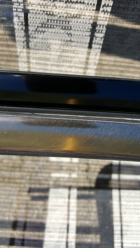

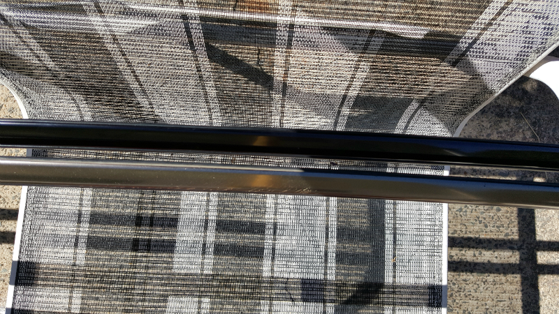

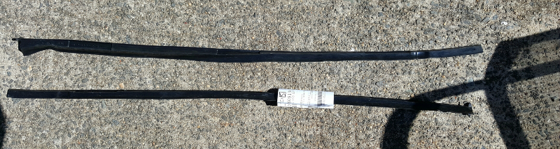

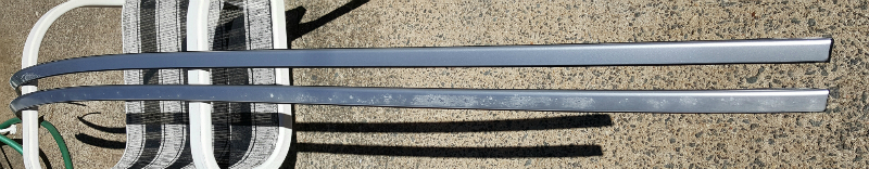

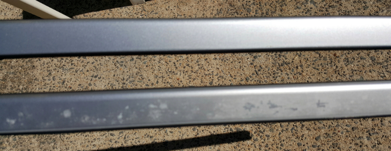

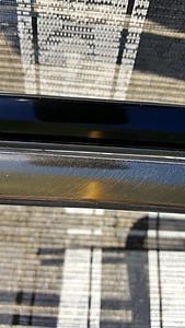

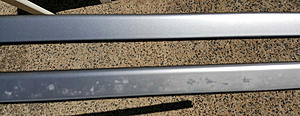

Not long after purchasing my car, 2.5 years ago, I noticed the roof drip moldings would sort of cloud up. I could polish them and they would clear up rather nicely. A couple of years later, they got worse, and wouldn't polish out as well. Then, my windshield needed replacing which necessitated the removal and replacement of the strips. The trauma of the R&R caused the clear to totally fail on top of the Brilliant Silver paint.
I thought about having them painted, but decided against it and just purchased new, pre-painted OE strips. I'm sure I could have had them painted more cheaply, but I didn't want to the hassle of going that route. I also replaced the seals that attach under the drip molding strips and run down the A-Pillar along the sides of the windshield. While I had access, I also replaced the upper molding that runs horizontally along the top of the windshield. It is like the other black, anodized molding on the car that turns a sandy, bronze color.
If anyone is interested in parts numbers, I will be happy to post them. Of course, your car has to be Brilliant Silver for the part numbers to match for the roof drip moldings.

ddb, I enjoy the attention to detail you put onto your car. How much was the black trim price you replaced? I am debating repainting all of mine windows windshields etc but it seems like a PITA to remove and reinstall. the individual pieces were high combined the last time I checked.

Hey TG, thanks.
The part number for that upper trim piece is: 210-670-09-22, and was $70.30. It is easy to remove once you remove the roof strips, which aren't terribly difficult to remove.4
The 4 side window strips are relatively simple to remove. You do have to remove the B-pillar covers first, which is easy. The B-pillar covers however are fiddly to put back on.
The vertical side strips towards the rear of the back windows are a problem. I thought I could pop off the rear door panels and have access to the fasteners that hold them on. Unfortunately, the fasteners are behind what I believe to be rear door airbag modules which are held on with rivets. I have a new set and will try to get them in this winter.
I also have the replacement trim that goes around the rear window. I've found very little about replacing these pieces (I can't remember if it is 2 or 3 pieces). I have read that you may not be able to get the new pieces in without removing the rear glass. So I've done nothing just yet. I may consult with a glass installation company at some point. I plasti-dipped the rear glass and vertcal strip trim until I get the new pieces in. It isn't glossy like the new windshield header piece and new side window strips, but they look better than the faded, discolored look.
Yea, the side and rear pieces are pricey. Painting or powder coating your existing pieces seems like the way to go. I looked unsuccessfully for someone to re-anodize my original pieces a while back. Whatever you do, it makes a huge difference in the appearance of the car, IMO. Let us know which route you take.

so the prepainted roof trims are $70 ea? If so that's pretty inexpensive. I just replaced mine along with the side mirror covers from my neighbor's totalled low mileage car before he donated it for a grand total of $0.

@ desired_speeds
I think the piece he is referring to is the the black Hematite horizontal trim piece that stretches horizontally across. Most all of ours are purple now.
@ ddb
Thanks for the part and price.
I have received quotes to have all of those trim pieces painted on car for about $125-$150. The issue is that I fear that they will chip away over time and that there is the rubber trim seals underneath the front and back pieces that would be hard to tape off cleanly.
The powder coat route is about the same price, but I have to remove them and deliver. Even if I buy a set from fleebay and have it done and swap, it would be cheaper than buying from MB, though there are plastic cap pieces on the ends of the window pieces so I am not sure how that works with powder coat. I could do a black chrome or similar.
I found a place locally that would actually would re - Hematite but they as expected are a little more than powder coat and again remove and deliver.
I think the route I may try is to have them vinyl wrapped and hopefully it can be done without cutting/damaging the seals. I dont think I have seen anyone do it here on the boards on our W210. I have carbon fiber vinyl for the A pillar trim piece that already has the faux carbon fiber which I may do myself for fun.
On the rear glass, I think that it is 2 pieces if I remember EPC correctly and it has those small cap pieces and underneath is a screw while the rest are clips. I think its pry the cap pieces and go from there.
I am working on replacing my windshield currently so Ill ask the glass company as well to see if the know about the small window trim in the rears.
I am having a annoyingly hard time battling door dings and such so the cosmetic costs of this car is adding up and my OCD is being tested lol. You know whatever Ill do ill post

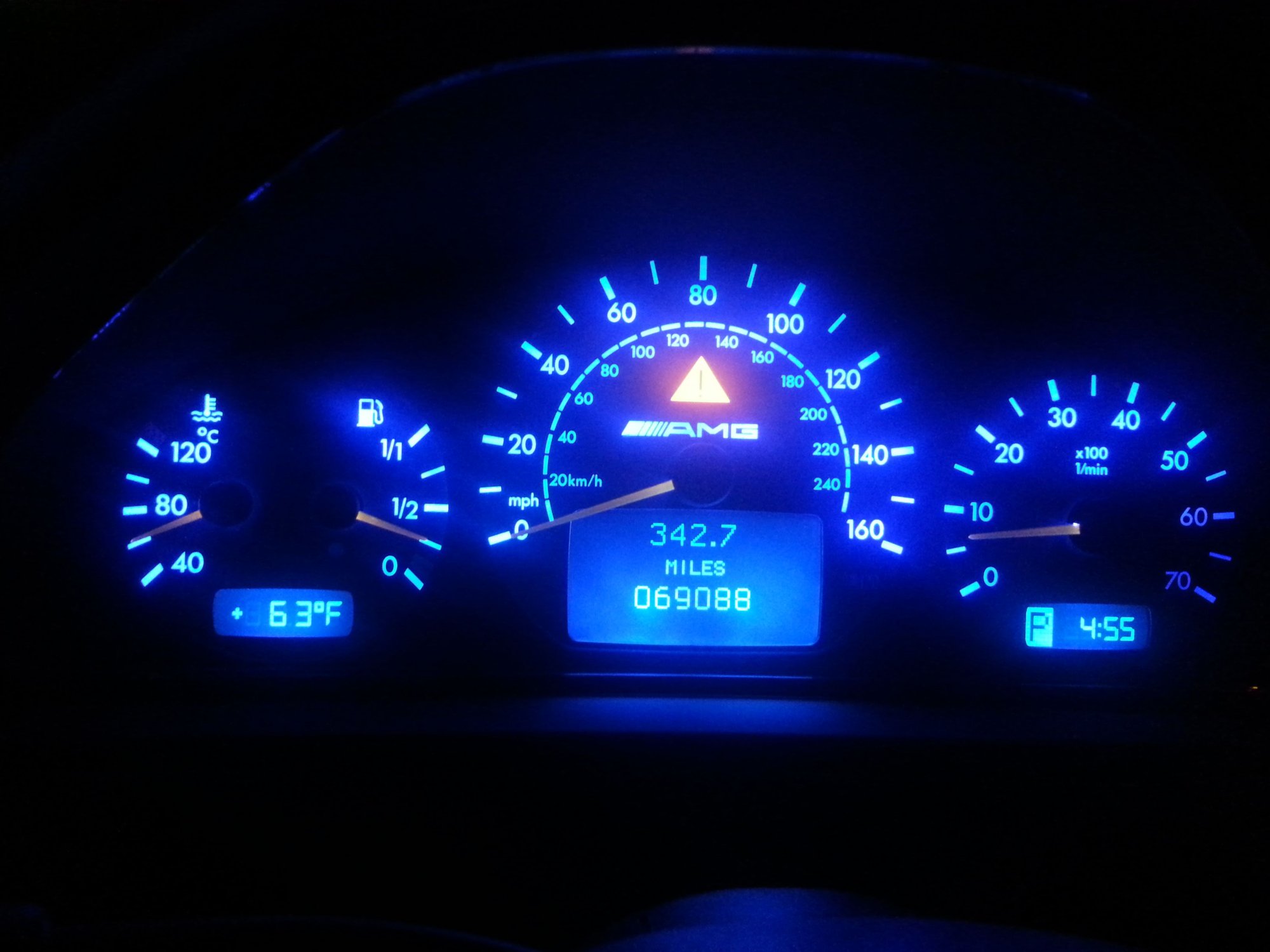

LED gauge cluster upgrade and pixel repair at the same time.

Looks nice, mitsumark! Nice low mileage too!
