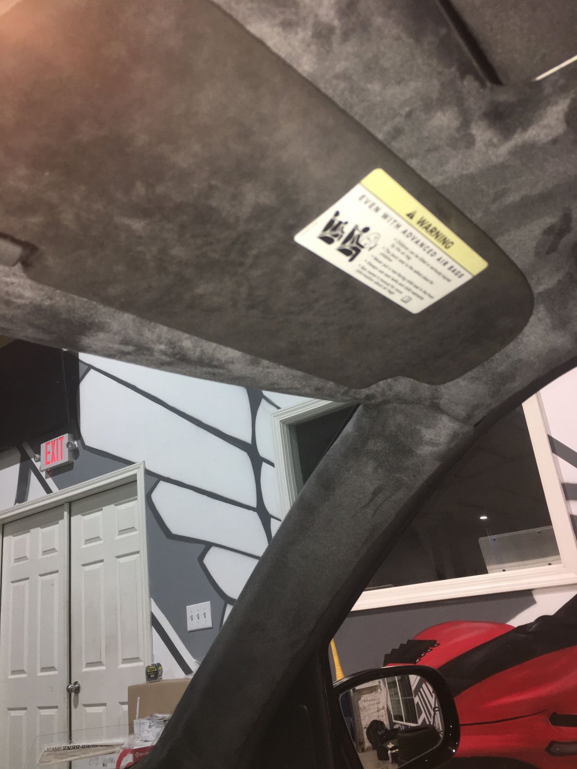

W221/216 Alcantara visors installed

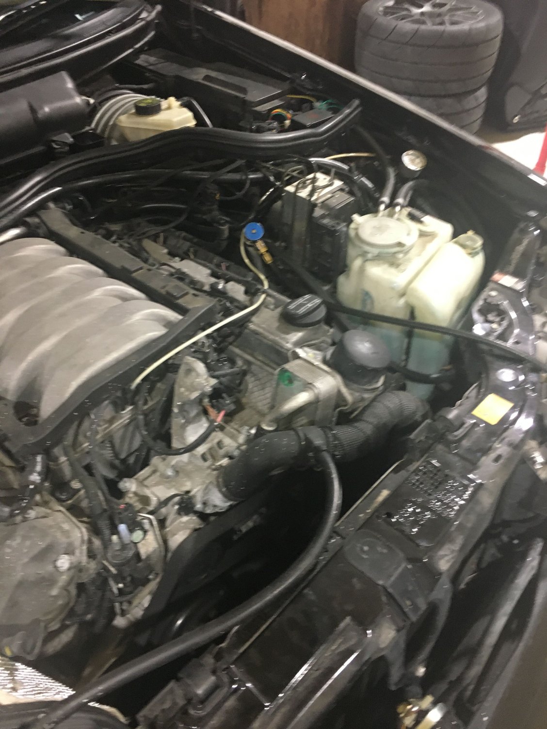

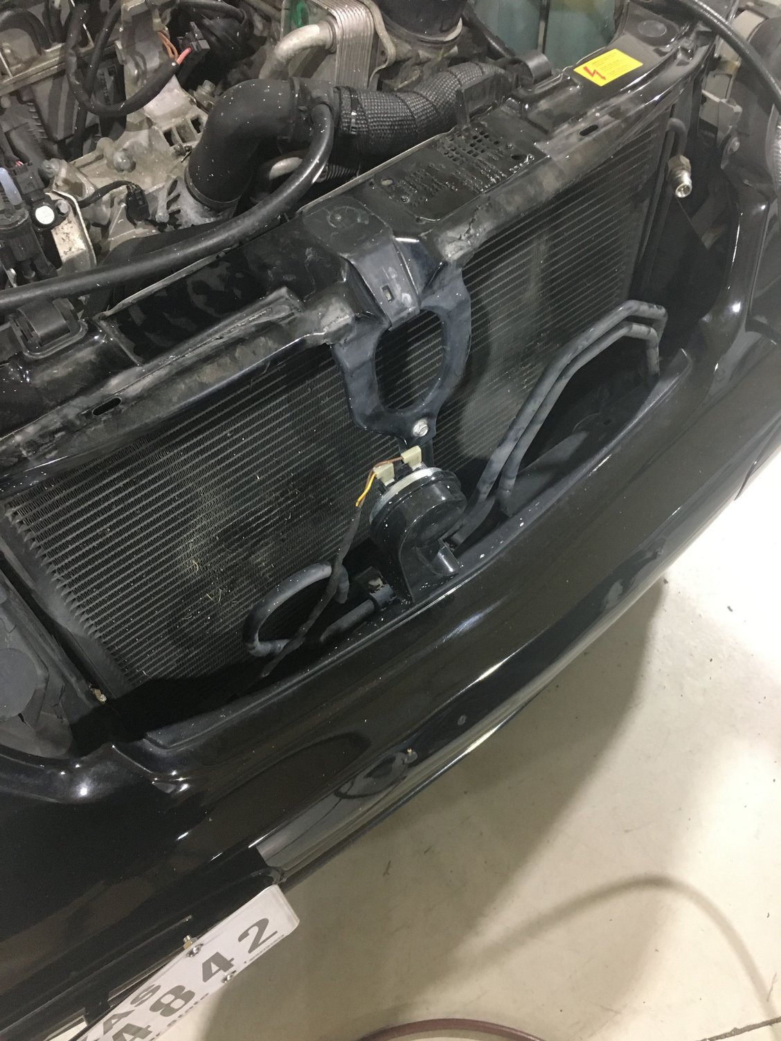

Installed new ac compressor, expansion valve and drier. Also set up my electric fan to fun when my AC is on. Removed my to front accessory fans also.

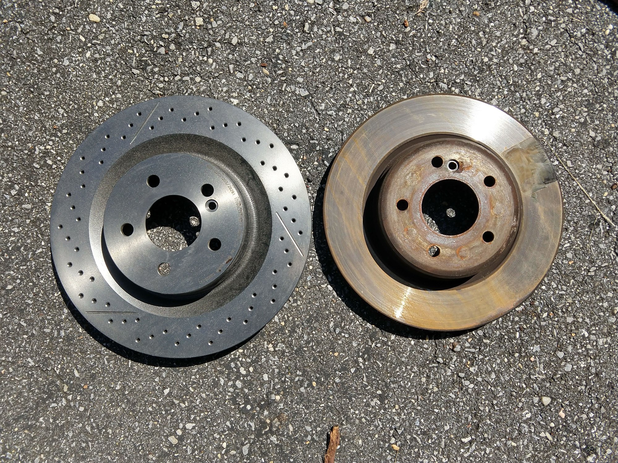

Replaced a worm out breather hose.
Found some rust in the rear wheel well and fixed it.
Found these S65 / CL55 / SLK55 calipers on ebay for cheap with a terrible paint job.
Stripped off the old paint, it took several tries to get all of it off.
Painted them silver and put some AMG decals on them
Old setup
New rotors
Trimmed and painted the dust shield
All back together
Old Sep 13, 2020 | 11:21 PM
  #535
cm60k's Avatar
Joined: Aug 2006
Posts: 7,053
Likes: 398
From: A.D., U.A.E
Good job bro..,
Is this SLK55 Rotors.?, and did you cut the edge of the spindle holes..??
-;-ZAYED-;-
Old Sep 14, 2020 | 08:58 AM
  #536
illest's Avatar
Joined: Aug 2006
Posts: 1,219
Likes: 94
From: MD
w210 AMG or S213
yes I used SLK55 rotors. I did not cut the spindle holes.

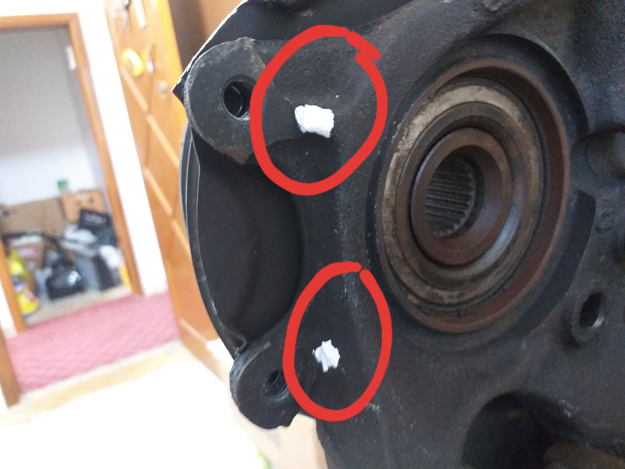

Those calipers for "W215 CL55/CL600/W220 S55-S600",
the bolts holes are (12.7mm), and your hub uses (10mm) bolts,
have to put (1.5mm-2mm) sleeves into the holes to make sure calipers will not moving due to hard brakes..!,
also, have to cut the spindle edge to give more clearance to the caliper bolt base,,
cause when you tighten the bolts, the edge of calipers bolts holes will be damaged, and they will not set properly in the middle of the Rotor..!!
-;-ZAYED-;-
Old Sep 14, 2020 | 03:07 PM
  #538
illest's Avatar
Joined: Aug 2006
Posts: 1,219
Likes: 94
From: MD
w210 AMG or S213
They seemed to bolt up fine without cutting but I will check today. I have not driven the car yet.
-;-ZAYED-;-
Yes, looks just like what I did. If you buy standard size tubing it fits perfect! Also had to grind those areas, and I completely removing the brake shield
Old Sep 14, 2020 | 03:36 PM
  #540
eurochargedw210's Avatar
Joined: Oct 2017
Posts: 668
Likes: 103
w210 E55
Make sure you use factory slk55 pads, if those are slk55 rotors. The brembo factory rotors like to squeal with other pads.
Old Sep 14, 2020 | 08:43 PM
  #541
illest's Avatar
Joined: Aug 2006
Posts: 1,219
Likes: 94
From: MD
w210 AMG or S213
Took everything apart this afternoon and ground down those parts a bit so everything fits up better.
I tried to order some 10mm ID tubing off of Ebay but it was coming from China and not going to arrive until sometime in October so I
found these on amazon found these on amazon
and they fit well.

Smart move bro., and 100% agree with..,
i really heat these stupid shields, not that necessary to keep them, they protect nothing..!!,
just pull them off,
take the small piece which holds the L&R speed sensors in Fronts,
and keep the round base to hold the brake shoes at Rears,,
that's all..

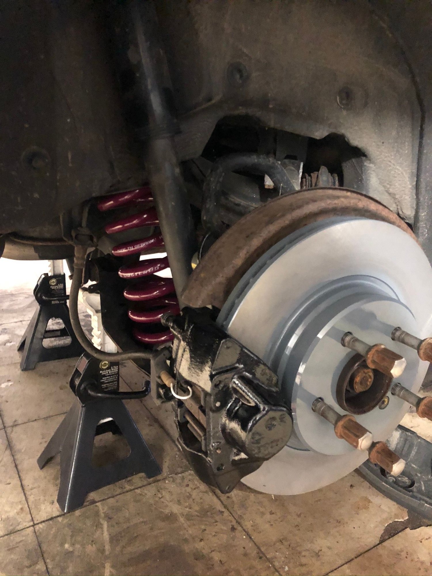

Did the rear pads and rotors. Painted the calipers and installed some Vogtland springs.

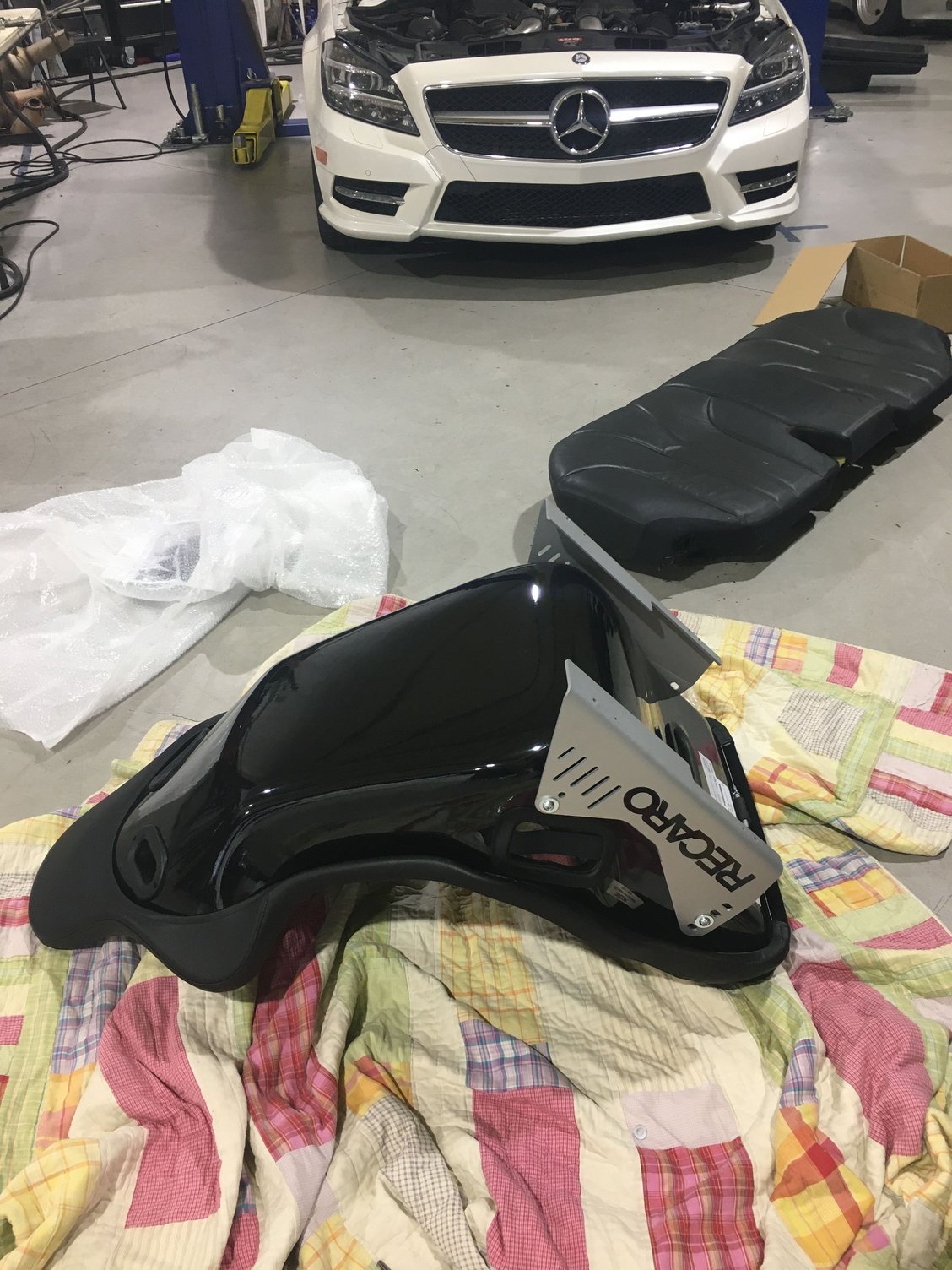

Removed Bosch S5 battery 52lbs
Replaced with Mercedes r230 SL starter battery 23lbs
Also test fitting my 996 Planted racing seat bracket.

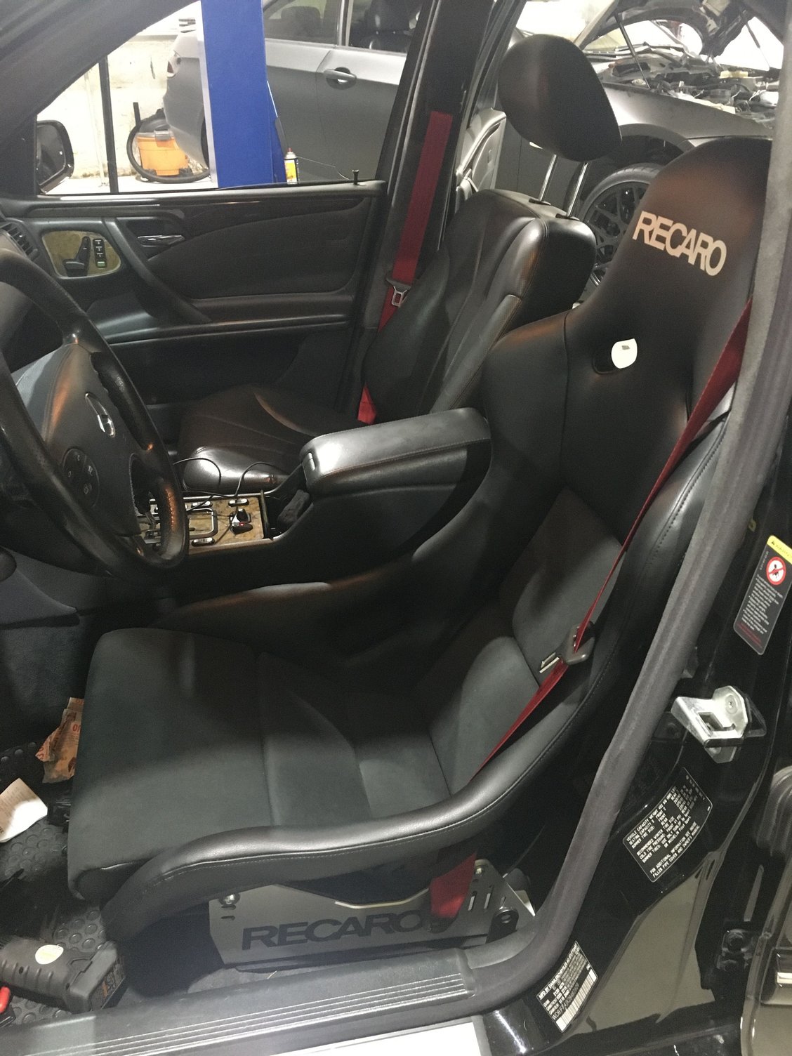

w210 E55
Some test fit action!
Factory seats seem to be right around 57lbs.
Planted racing bracket 7lb 3oz
Recaro seat with side brackets 20lb 8oz
So it looks like I will save around 30lbs per seat.
So with my new battery and seat set up, looking to drop around 80lbs. Hopefully if my boss lets me use his e63 5 spoke wheels and I get two piece rotors I can maybe get down into 3700lb range.
