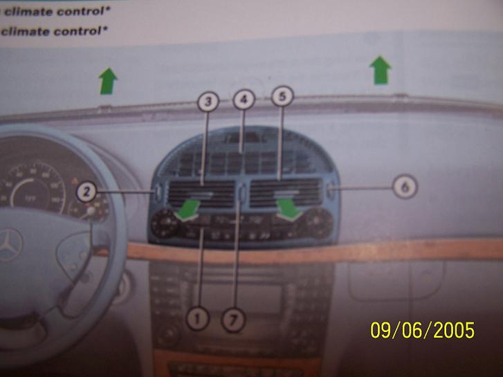

Hey last question.
Above the digital screen with the temps...there are the 2 vents and in between is a dial that has blue lines on it. I read in the manual that the dial controls the amount of cold air allowed into the vehicle. Any idea if which direction is "letting the most cold air in". Is it when the blue lines are being shown or when they are not.....any ideas. Maybe easier to explain, when I roll the dial up toward the hood or all the way down toward the shifter.....who knows, maybe that has been my problem all along.
Hmm that's interesting... my car doesn't have a dial in between the 2 vents
Is it something that 2005MY models don't have?
It has a dial on either side of the vents with white lines.

F'in scanner won't work when you need it.
I just snapped a pic of the manual.....see the dial in the middle of the vents......you 04-05 guys don't have that?....weird.
Hey last question.
I have a similar knob in my Bimmer. With the blue dots displayed, the vents emit cold air. Dialing the knob away from the blue dots causes warmer air to be emitted. HTH.

I have the dial in the middle and mine is a 2004.

My AC freezes my *** off within a few minutes to say the least. Sounds like a bad AC system to me. BTW, I too have that knob in the middle of the vents.

Push the center dial all the way towards the front of the car.
