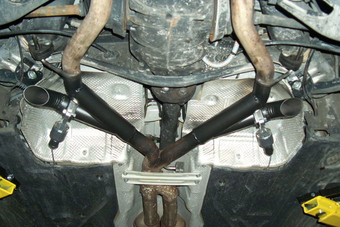

Yes, it is an electronic valve - like a throttle plate - that is put into the exhaust system. It can be placed anywhere - before or after cat, resonator or mufflers. When placed properly it will bypass almost all exhaust to atmosphere. Shown below are two examples of cut-outs we did on MB's:
The First one is on the last SL500 we did a Kleemann Kompressor kit and headers on. This is a simpler and :louder: design.

BTW - for those that are planning on comming tommorow, the car pictured above (the first one - short pipes) will be there, as well as a small display we made showing the valves.
