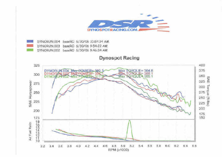

Well folks,
I had my car on the dyno this morning and as much as I had braced myself for the worst, the results still shocked me to some extent.
And the numbers are (drum roll please...)
1st run - 317.9 whp, 385.1 tq
2nd run - 306.1 whp, 368.1 tq
3rd run - 302.3 whp, 364.8 tw
Obviously this is one sick Benz and not in a good way.
I'm beside myself right now
At WOT the A/F ration took a nose-dive and the dyno wouldn't show anything less than 10.0 to 1, isn't this cylinder wall washing territory? This can't really be software alone, there has to be a mechanical failure as well.
I'll post the dyno plots as soon as I get near a scanner.
Maybe my dealership will believe me this time when I tell them the car feels hella-sluggish while I shove the dyno results in their face...
I have to go calm my nerves now and prepare for the inevitable brawl with my SA
-Mattias

You're down about 100 HP for a stock car - this is definitely more than software (fuel/spark) will cause. But it's too high for the S/C to not be working. With the A/F ratio going pig rich at WOT, my guess would be you're losing boost. Can you data log or can you connect a boost gauge? If this HP loss is due to the ECU reflash, it may be confirmation that MB is playing with the bypass valve. We would need to know your boost level at WOT to confirm - it should be about 12# for a stock car.

Dyno results
Sorry for the wait.
Temperature was right around 72F and the car sat for almost 45 min before the first run. The first available appointment with the dealer is this coming Wednesday... My presence was requested to go with the technician in order to verify the powerloss... Lucky me
Making myself available for various test drives and dyno runs is becoming expensive.
Grumpy,
I will make them prove that the car is making boost as advertised.
-Mattias

Looking at your dyno plots, in addition to the overall reduced power:
- If you go again, ask them to start the pull about 1000 RPM lower.
- Have you done the IC pump upgrade? You're losing about 25 HP from first pull to third.
- At 5000 RPM, it looks like airflow is significantly reduced, causing your A/F ratio to nose dive - probably from reduced boost.
Old Jul 1, 2006 | 04:01 PM
Vadim @ FD's Avatar
Joined: Mar 2006
Posts: 2,855
From: Southern California
S600TT, R350
I think you are not making any boost. The reason power falls so sharply on top due to non-spinning blower becoming a major restriction.
Try this. Pull the engine cover off and unplug the blower connector. It is on the left side of the clutch and looks like a "squished cigar case".
If the car feels the same, than you know that you have no boost.
Good Luck!

I feel your pain...for comparison here was my crappy K2 dyno from 1 year ago-- culprit a leaking coolant/heat exchanger hose...notice the ASTRONOMICAL IATs.
Its fixed now but should give you a lower limit for HP....if I didn't have any mods I am not certain at all that these #s would have been any different though...so I am not sure how you get down another 70 rwhp to where you are at.
