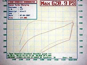

Hello guys...finally I have done some DYNO runs this weekends...
Weather in the Dynoshop was +16C...
Dyno - latest DynoDynamic machine...
My mods: Kleemann Style Headers, Primary Cats removed, E. Race mufflers and ASP pullies + custom ECU adjusted to those mods...
All graphs showing CRANK HP !!!
We couldnt do the FULL speed pull on 4 gear, cause DYNO machine would let US...its porgrammed for max speed of 125 mph...so it would only let us go up to 4600 RPMs...
Can someone tell ME what would happand nex if we got to FULL SPEED at 4th ???
Other graphs shows the FULL RUN run on 3rd gear...and we got the whole graph...
Please let ME know you comments guys...and I would apriaciate if some one who know this staff could recalculate this to USA measures and tell what they think about the GRAPHS...
Is everything OK with my ECU and anything I need to change ???
I also have all lambda ratio printed at each RPMS...
Thanks

O ****, that is one hellava E55 ! congrats !

Can someone explain what those numbers are translated into rwhp and rwtq?

I know if you divide by 1.36 we get numbers in KW...around 457kw
There must be someone here who knows how to transfer those measures...
and other question if on 4th gear we get TOP POWER around 620HP at 4600..Whould this number be higher at higher RPMs like 6800 ???

Well, depends on what you think the drive train loss is. If loss is 15% (using 600 hp as average) then rwhp would be about 510 if it is 19% then rwhp would be about 486.
Congrats. A full pull in 4th would be great to see.

The second graph shows your HP peaking at about 6200 RPM. Definitely breathing well !
I would be very interested in seeing the Lambda (A/F)

E55 RUSS said the numbers were crank hp. rwhp would be crank minus drive train loss. 23% loss is too high. Kleemann says there is about 19% loss, others on this board feel it is 15%. That's why I gave those figures. I agree a dyno should show rwhp, not crank, unless it did a calculation itself to convert rwhp to bhp.

Well...As I been told the Dyno calculates all the numbers inlcuding transmission loss by it self, there is all the data about 211 e55, we select E55 and then do a pull...
Why they have crank HP is because most of the people here want to see crank HP, thats why they have this software...
On the Dyno there is program that you can use and then it shows you wheel HP...but they are telling ME that its easy just to recalculate to KW and then to torgues at the wheels...

The chart in 3rd gear willl add further uncertainty as the conversion will be off ... the dyno will compensate for it - but 4th gear runs are the most usefull.... wierd why dyno wont go >125mph tho.
So looks healthy - but not sure how healthy ...

My car with K2 has been run on a Dyno Dynamics and showed a rwhp of only 425, and yes, the car had to be pulled in 3rd gear. It did not convert to crank hp. I never really felt the machine did it justice. I'm going to get a DynoJet done. The A/F was about 10.8 to 1

Spoked to Dyno Shop today..they spoked with DynoDynamics...they said there some kind of Cams need to bechanged for the machine to be runned over 125mph...4 of them need to be changed and cost of each is 4800 USD...
They will chnged it once the current ones are go bad...
They said they had the latest software and dyno caluculates the grpah n futher even we could reach onle 205 kms..

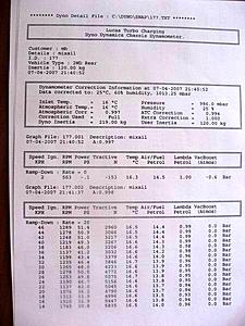

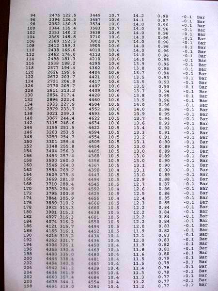

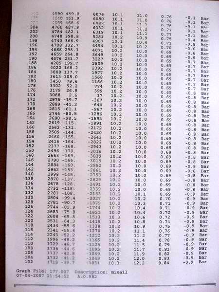

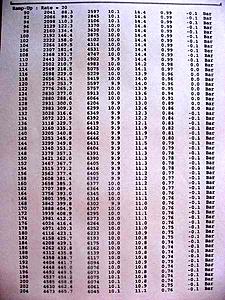

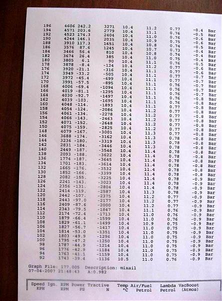

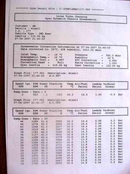

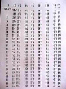

As promised here is the Lambda and other number from my Dyno runs...
What do you think guy ???
Attached Thumbnails MY latest DYNO RESULTS !!!-re-exposure-resize-rotation-dyno-lambda-001.jpg   MY latest DYNO RESULTS !!!-re-exposure-resize-rotation-dyno-lambda-002.jpg   MY latest DYNO RESULTS !!!-re-exposure-resize-rotation-dyno-lambda-004.jpg   MY latest DYNO RESULTS !!!-re-exposure-resize-rotation-dyno-lambda-005.jpg   MY latest DYNO RESULTS !!!-re-exposure-resize-rotation-dyno-lambda-006.jpg

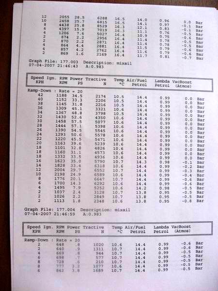

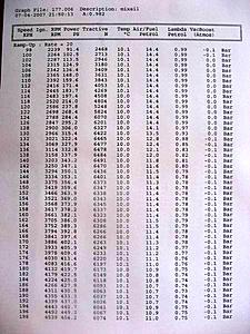

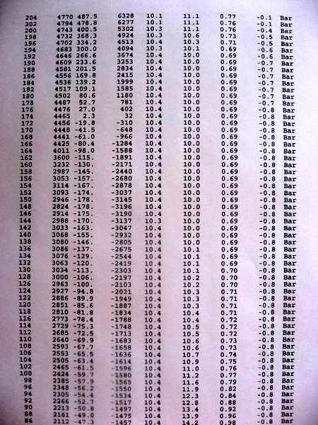

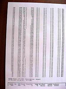

More
Attached Thumbnails MY latest DYNO RESULTS !!!-re-exposure-resize-rotation-dyno-lambda-007.jpg   MY latest DYNO RESULTS !!!-re-exposure-resize-rotation-dyno-lambda-008.jpg   MY latest DYNO RESULTS !!!-re-exposure-resize-rotation-dyno-lambda-009.jpg   MY latest DYNO RESULTS !!!-re-exposure-rotation-resize-dyno-lambda-003.jpg

I dont undertand..Can anyone tell ME anything about my Lambda numbers ???
