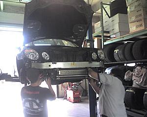

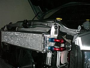

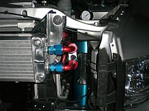

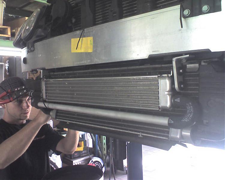

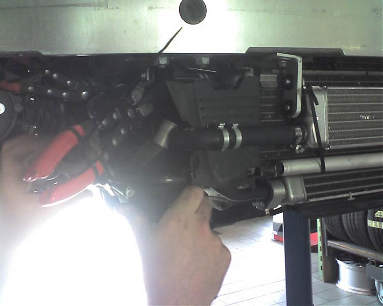

My car had lost it punch in the lower gears towards the higher RPM's and after a burst from 0-110 MPH would have the supercharger shut down for 5 minutes or so until things cooled down. Typical symptoms of intercooler pump failure. Instead of taking it to the dealer for the same bum pump replacement I took the car to RENNtech and had them install their upgrade kit which includes a new, much larger pump, and an additional intercooler.
The problem was the pump, we put the old pump on a test bench and tried to power it up and nothing happened. On the test drive the low end grunt is back, and the car pulls hard on the top end. It's nice to be able to repeatedly hammer on the car without losing power, even in 95 degree weather! I attached some pics....

this is just an additional heat exchanger up front and upgraded pump, the SLR intercooler upgrade is just that, the intercooler at the S/C is upgraded, side by side intercoolers, this upgrade is seperate from the SLR intercooler upgrade

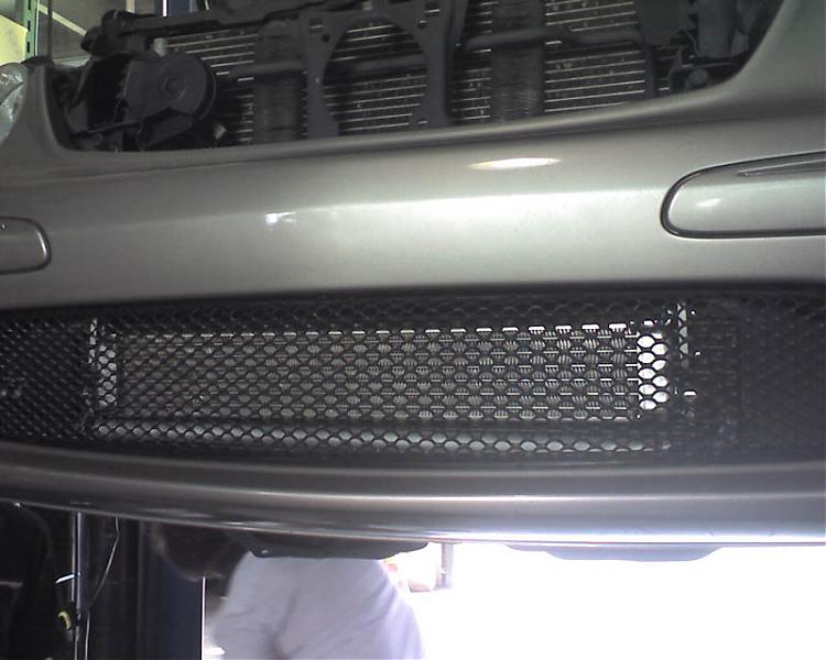

Fit of the added intercooler. The RennTech one is not as big, so it doesn't protrude into the mesh at all.

service was great, I had an appointment for 9am, when I arrived they were working on the car within 10 minutes and had it done in a couple hours....

They programmed my ECU to turn on the pump earlier than normal, but it's not on all the time....

yes i have you post a big picture of one of the parts i hate most. thebig fake steel braided lines. renn has a nice solid tube very clean lookin. also do like the way the exchanger looks. renns looks better here also.

Sorry, but they are real. They are made by Goodrich for use on race cars.
RT heat exchanger is half the thickness and only a single pass vs double on evosport's.

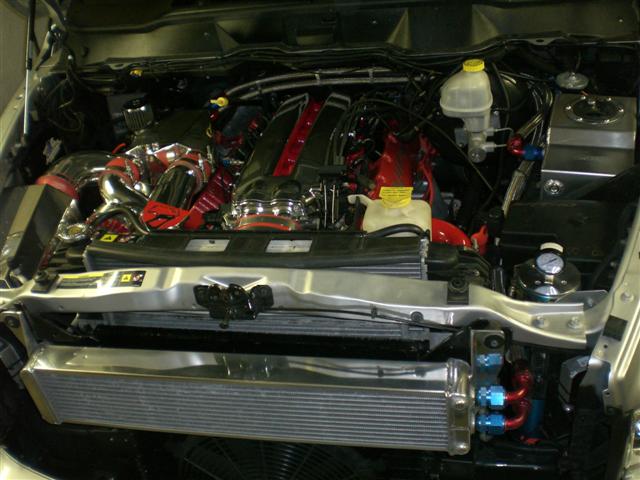

they are real stainless steel braided lines aren't they? aren't those AN fittings on the ends, another point double pass heat exchanger is like twice as good, double pass think about that, in my opinion the Renntech one is not as good as the EVO probably is, you can get single pass heat exchangers from places like AFCO racing for $200-$300, I prefab my own kit on my old SRT10, it probably cost me $600-$700 and it keep my IAT really down over the stock Paxton heat exchanger, one could get a johnson pump and make their own kit for under $1000, here are pics of my old setup

lol, heat exchanger cores aren't that expensive...it's the time to fab and weld the end tanks, brackets, and connections, and then get it all to fit your application that costs money.
since we're all posting pics of our custom heat exchangers...here are both of mine!

looks like the evo flows down half the cores and comes back the in other half, is that what you mean by double pass?
