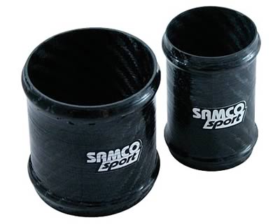

Cool link! great prices, 1 could custom fab-up a trick CAI, maybe help reduce a little Intake Heat IE CF laid inside & out, or just add some pizzazz to OEM setup, chk out these Carbon Fiber wrapped alloy 3" Couplers
Samco Sport CF76 - Sport Hose Coupler, Carbon Fiber, Natural, 3 in./76mm Bore, 3 1/8 in. Length, Each $19.50
