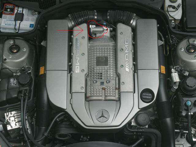

Mercedes does not have the part number on file and it is making a very strange clicking noise and a high pitch whine. I am trying to diagnose why the car wont start and would like to know what the part is before I change the CPS.
I circled the part in red. Thanks alot.

thats your tb,take the intake y pipe out and look if it sucked up the rubber gasket thats at the opening and jammed the blade stuck.
also make sure its plugged in.
I dont know the part number but that should be an easy one to get.When I was looking for the 82mmtb the dealer was looking up lots of different ones for me.
do you have a scan tool?If you do take a look at your tps %,

Actually, it looks like an idle motor on the throttle body to me, but I do't have an E yet to verify.

it is the motorzied part of your TB that actually moves the TB flap. you will haev to replace the whole TB
ah, TB actuator

yup,you need to replace the whole tb,its one unit!!!

No I got in there took off the hoses turned on the car and no blockages and the blade was moving without a problem but still had that high pitched noise??? Car still will crank but won't start so time to get the Crankshaft position sensor and give that a try. Anyone have any thoughts what it may be if not the TB or CPS.
