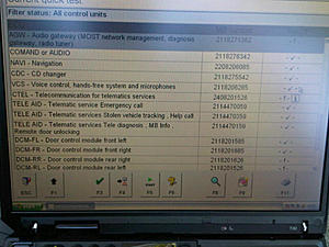

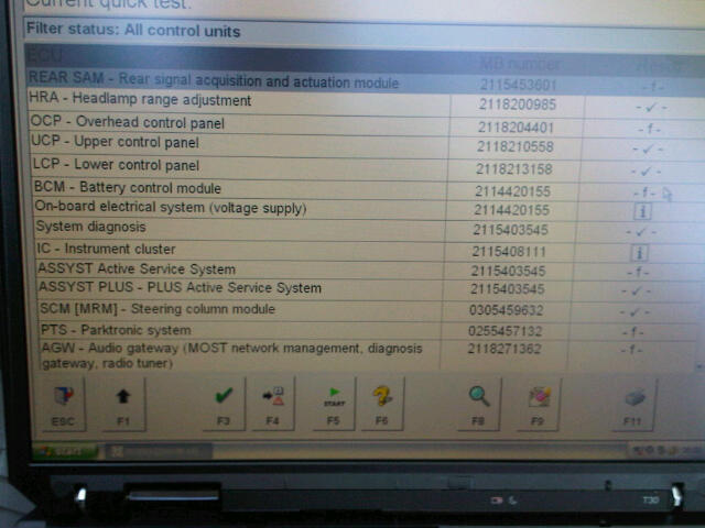

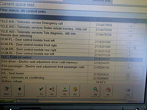

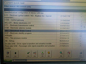

yesterday the check engine light suddenly went away ...very weird.....friend came over and scanned the car, this is what he pulled out...any ideas guys? I have a feeling it may have something to do with the fack that the last tank i let the car go all the way down to reserve and then some....maybe some sediment at the bottom of the tank got picked up? anyway thankfully it runs ok now....

what is the stored fault in the ECU?
That's not likely since the fuel pump is ALWAYS sucking fuel from the bottom of the tank so going low of fuel doesn't make a difference.
Also, those pics really don't tell me much...I need to know the codes stored as shardul stated.

We're fairly new using the Star, can you tell me where we have to go to see the stored codes? is there a step by step somewhere?
