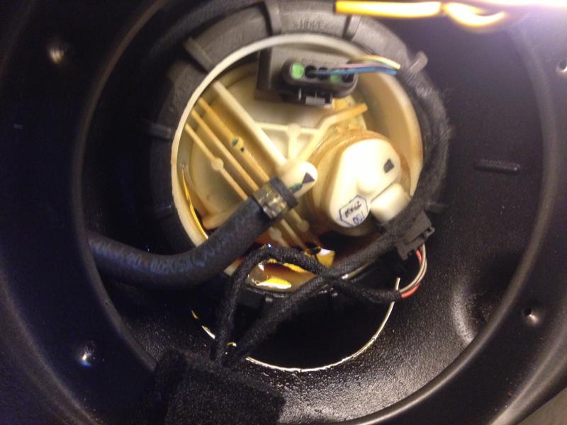

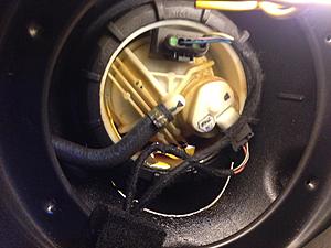

Old Feb 4, 2013 | 08:17 PM
  #453
prfmerc's Avatar
Joined: Feb 2013
Posts: 5
2007 e63, 2006 Range Rover Supercharged, 2010 GL 450
Here's what I found under the driver side rear access panel. Clearly quite a bit fuel pooling on top the the fuel sender/tank. Fumes in the car and garage are unacceptable and its pooling by the driver side rear tire. I just dropped the car at the MB dealer near me (not MB dealer where purchased b/c diff states). I'm going to let him do a diagnostic and suggest a solution. I'll cross reference any parts with updates from previous threads. Does anyone have further suggestions as per course of action? Once these fixes are in place, can I feel safe with the car? With kids in the car?

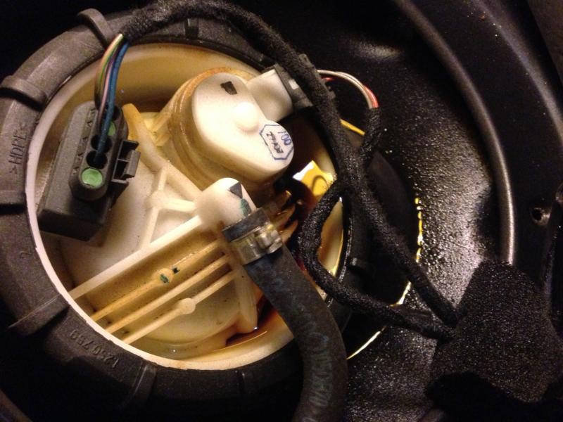

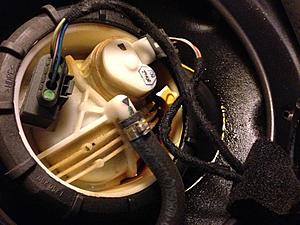

Old Feb 16, 2013 | 05:02 PM
  #459
E63//AMG's Avatar
Joined: Dec 2008
Posts: 354
Likes: 10
From: Illinois
W211 E63
Add me to the list ...
Attached Thumbnails URGENT: NHTSA Opens investigation into fuel leaks on the E55.-photo-1.jpg   URGENT: NHTSA Opens investigation into fuel leaks on the E55.-photo-2.jpg
