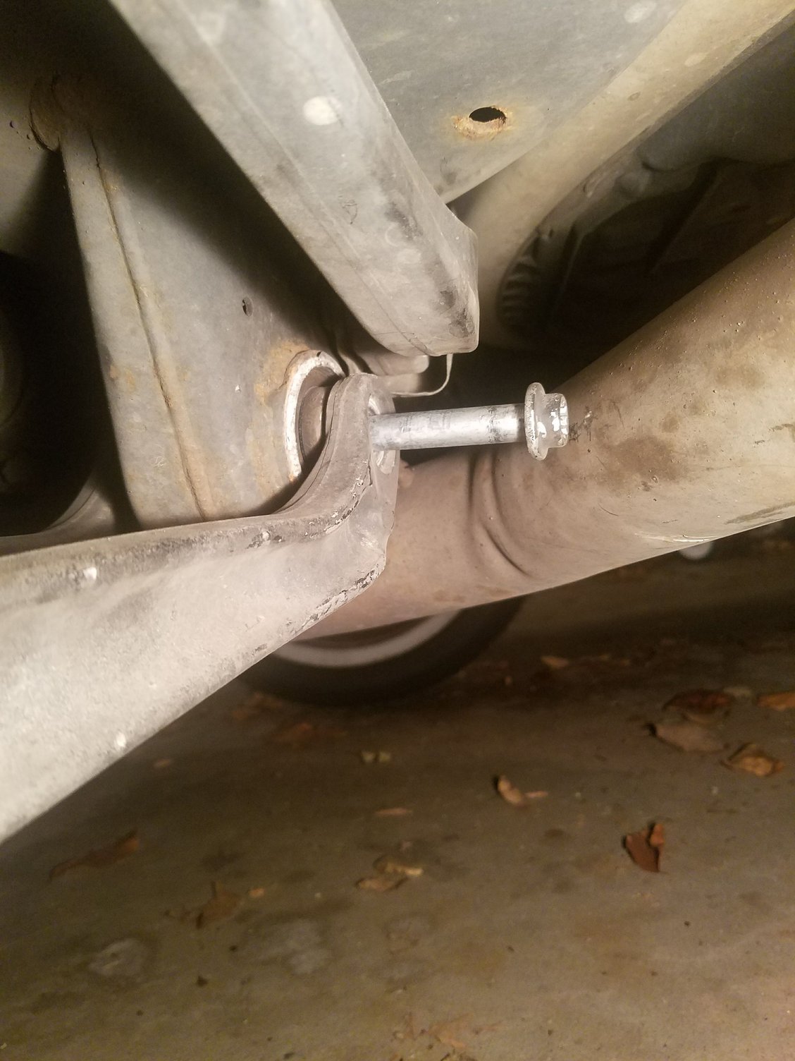

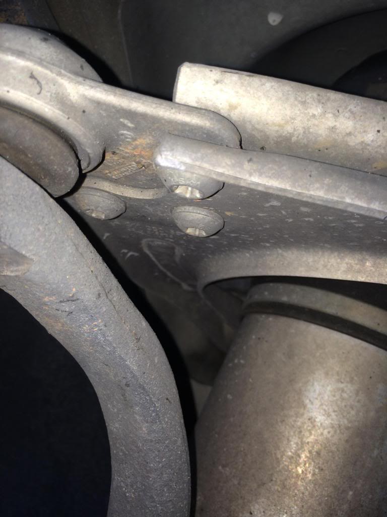

Can someone tell me how to get the inner control arm bolt out without dropping the exhaust? If I pull the bolt straight out it hits the exhaust pipe and I can go no further without dropping it.
Side note, if I have to drop it, does anyone know how?
Thanks,

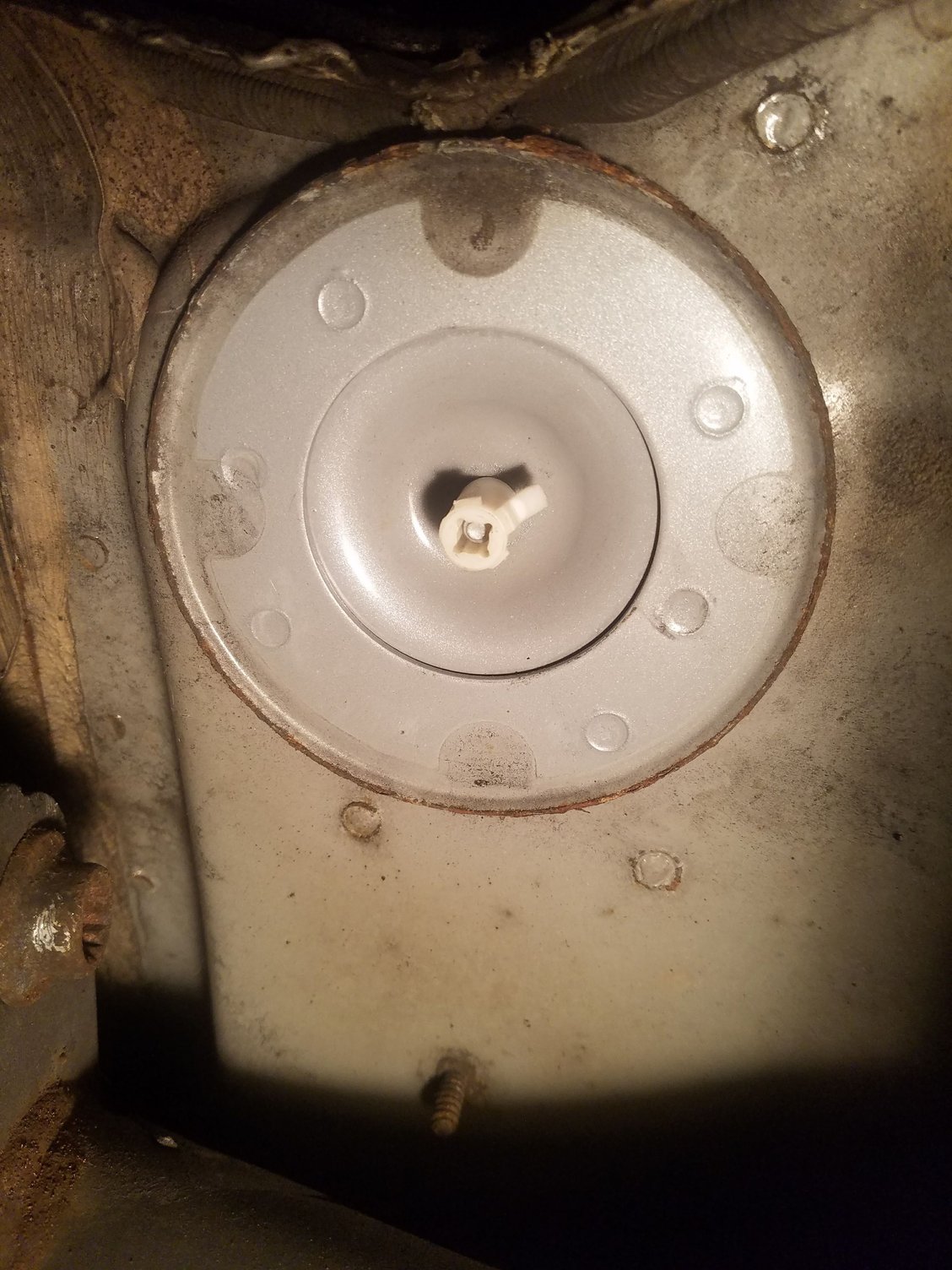

One more question, do I have to remove this or will the spring perch sit right on it?

You can leave those plastic tabs there, you can just loosen the cross attachment at the diff from the exhaust, then two 10, or 13 mm bolts looking up the rear bumper near the tips, you can then have enough play in the exhaust to get the bolt out.

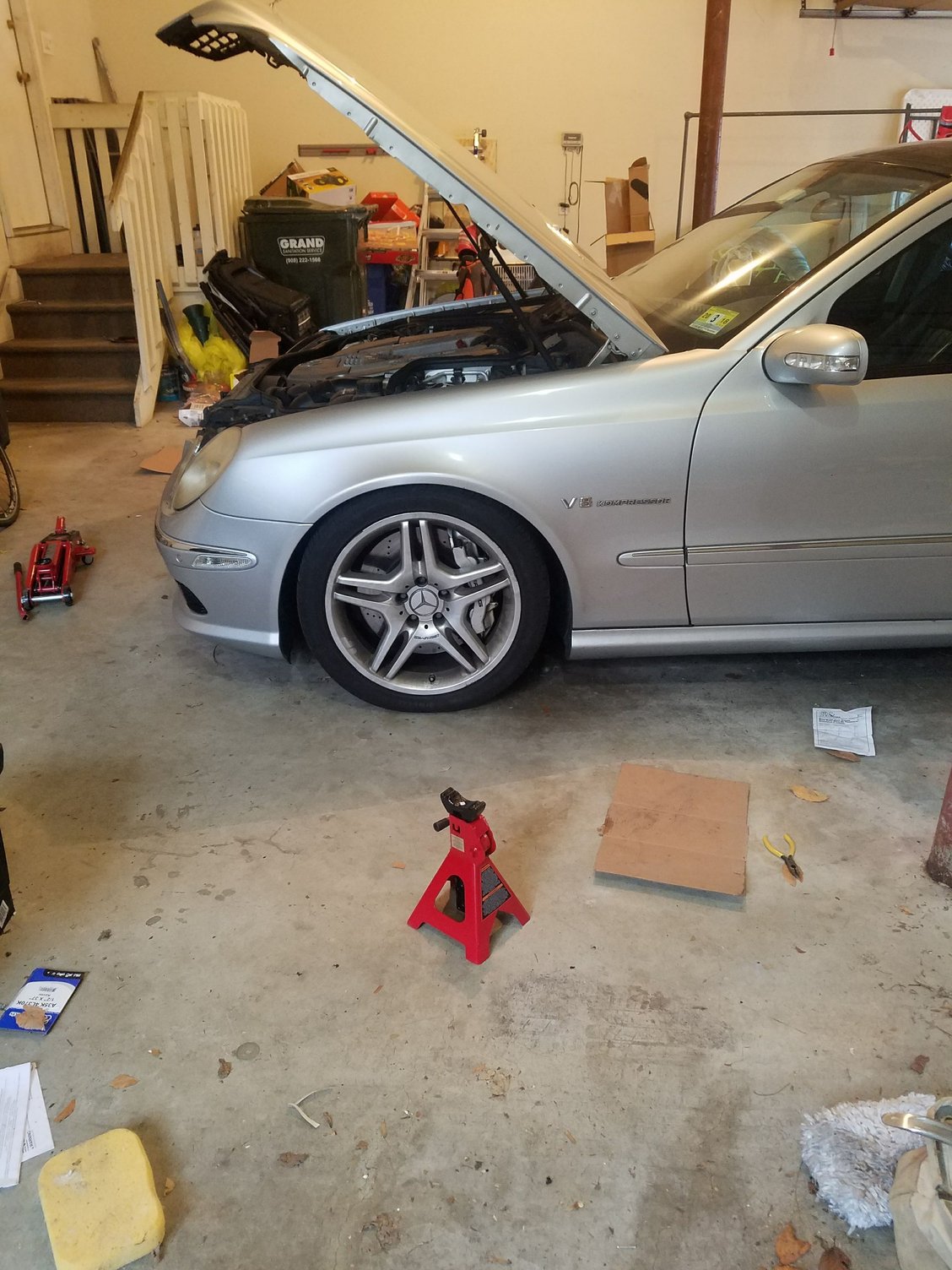

Thanks Jeff, I will give that a try tonight. Also, given how difficult you guys are saying it will be to adjust the height of the rears, maybe you can give me some indication on how I should set the rear perch:
Just to give you some indication of the stance I am looking for this is how I set the fronts for now:

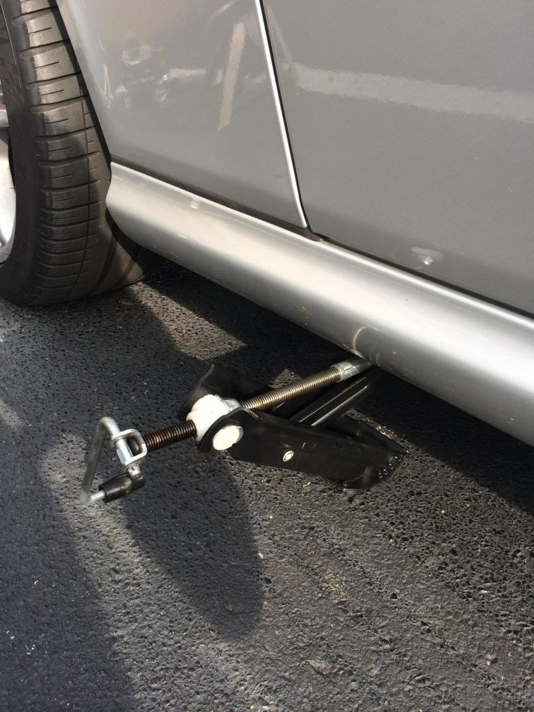

First things first break your wheels loose in the front while the car is on the ground. Apply the emergency brake and chock the rear wheels. Then use the factory jack on the factory lift points to get her up in the air.
Attachment 377119

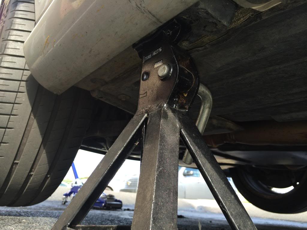

Place Jack Stands under the factory jack points.
Attachment 377121

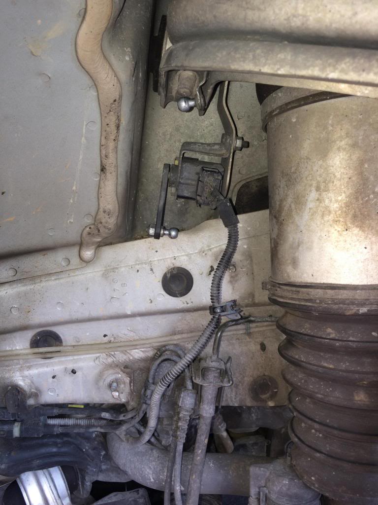

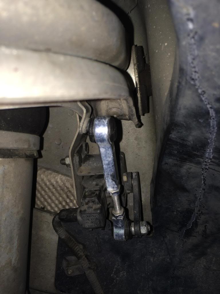

Now we begin by removing lowering links. Place a screwdriver between the link and the sensor and pry off:
Attachment 377125
Then unclip sensor:
Attachment 377126
Attachment 377127
Attachment 377128

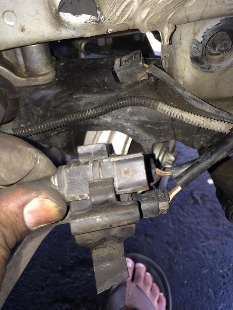

Trace the wire leaving the shock and follow it to this cluster fudge of wires and unplug it alone.
Attachment 377130
Attachment 377131
Attachment 377132

Removed the upper mount to the height level senosor and left sensor on the chassis till i removed the shock:

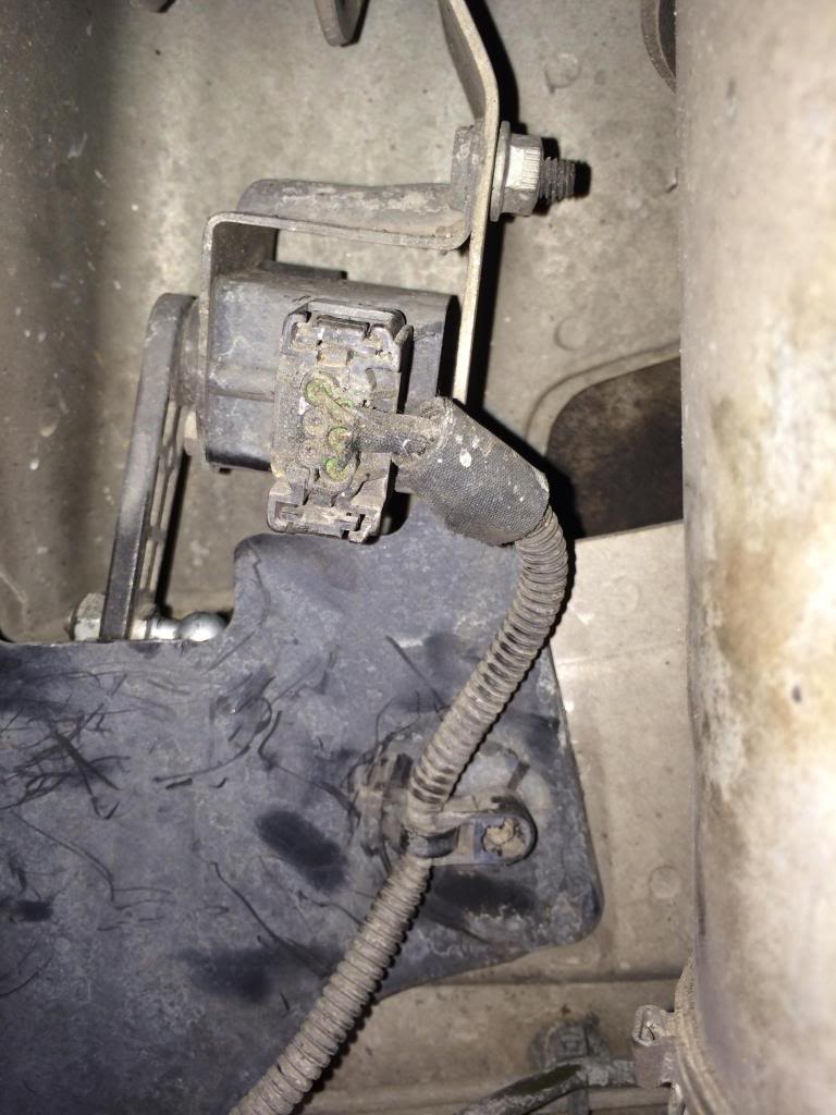

Remove the level sender from the chassis:
Attachment 377139
