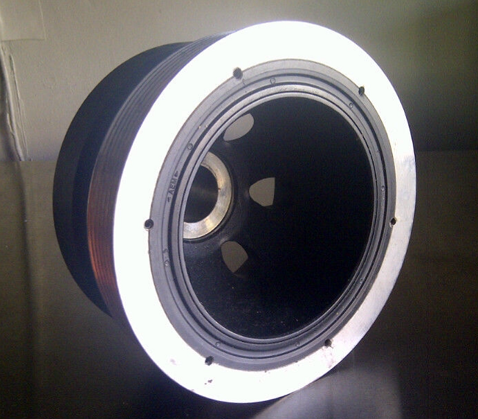

Ok I'm officially nervous now, the rabbit hole doesn't look so inviting and I'm feeling claustrophobic! She aint going back on the road till I'm satisfied she's ready for runs without any chance of doing damage. So from a simple Harmonic Balancer replacement suddenly I'm up for:
(1) MKB Crank Pulley US$500
(2) Nakai SC Pulley Bearing US$100
(3) Shardul 5 piece Idler Set US$500
(4) Shardul Water Pump Pulley US$180
(5) Shardul Beltwrap Kit US$450
(6) Shardul 550cc Injectors US$500
(7) FABTECH-PERFORMANCE I/C Trunk Tank US$559
(8) Updated Eurocharged ECU Tune + Cable US$200
(9) Postage to Australia for all the above aprox US$700
(10) Installation assistance aprox US$500
Making for a grand total of $4189, many hours carefully wielding tools and around 6 - 8 weeks without a vehicle.
Cooling mods already include a Johnson CM30 I/C Pump and Eurocharged HE plus she is running Kleeman Headers and of course the standard Performance Tune together with that SC Pulley and K&N Filters rounding out the list of mods. I was hoping to have Air Induction by now but guess that will have to wait.
If anyone has any suggestions on how I might lower the overall cost without jeopardizing my baby please let me know?
This is the Pulley that has created this whole dilemma for me...
Attached Thumbnails Does running a smaller SC pulley AND a larger Crank pulley put too much strain on car-photo-26-06-2014-9-53-36-pm.png   Does running a smaller SC pulley AND a larger Crank pulley put too much strain on car-photo-5-07-2014-3-21-20-am.png

Ok I have gone over your list of mods and looked at your crank pulley and have my suggestions for you:
1) How did your research go for determining the reliability of the crank pulley you have purchased? I noticed the larger 180mm has been installed on a Mercedes OE centre hub but don't think it had the extra dowel connectors that others have been using that further strengthens the inner hub and outer ring together. Please make sure you research the crank pulley 100% before you install it. The last thing I want is for you to damage your entire engine.
Having said all of the above if you are really going to install a 180mm crank pulley with your smaller clutched pulley I really think you need to consider extra cooling mods over and above what you are proposing such as a killer chiller or meth.
2) It is a great idea you are looking at doing injectors, make sure your tuner knows the full specs of your chosen injectors and is happy to adjust the custom tune to suit these new injectors. As the supercharger needs to be removed to install the injectors (or so I believe), it might be the perfect time to upgrade your throttle body saving on labour and supercharger gaskets at the one time. Don't forget to change your supercharger oil whilst it is removed using Mobil Jet Oil II.
3) Fabtech intercooler trunk tank...Yes a trunk tank is a good idea and I have one and think you should get one to. Perhaps ask Shardul/BIP/Eurocharged on a quote for this as well. I have some Fabtech parts and mine are rubbish.
4) Make sure the belt you have already purchased is ok with a belt wrap kit as well.
Your installation assistance of $500 is ok as long as you are really doing most of the work yourself. I am located in Melbourne and I would guess if you had to pay somebody to do all the labour over here it would cost about $2500 AUD.
In the back of my head I do have some concerns about you running the 180mm crank pulley and smaller clutched supercharger pulley together simply due to the immense heat you will create and the continual strain on your supercharger and motor. You are really at the upper echelon of the boost levels your engine can handle without going to extreme cooling modifications. At these boost levels you must have everything always running 100% perfect and the air fuel ratios checked on a dyno with a wideband o2 meter after your custom tune has been downloaded into your car and then have the tune modified slightly if it has any areas it can be tweaked for that extra margin of safety.
You may also want to monitor data with a dashdaq to keep an eye on engine knock & inlet air temps etc.
Oh and whilst at this level it may be a good reason to do the intank fuel filters as a precautionary measure.
Hope it all goes well for you because your car is going to fly.
Best of luck.
Regards,
OZZYAMG
