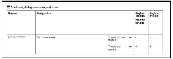

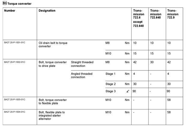

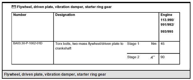

Old Dec 2, 2014 | 09:16 PM
O-55's Avatar
Joined: May 2008
Posts: 293
Likes: 20
From: Houston/Plano, TX
2005 E55, 2009 VW GLI
Here you go.
Last edited by O-55; Dec 2, 2014 at 09:33 PM. Reason: Added flywheel to crankshaft screw part number.
Old Dec 2, 2014 | 09:35 PM
Chomanche's Avatar
Joined: Oct 2014
Posts: 42
From: Denver
2007 E63 Amg, Heavily modified 1988 Jeep Comanche
The 90 degrees is hard with out the flywheel lock tool. Just tight as *** as long as you replacing em

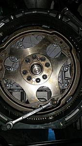

Old Dec 16, 2014 | 10:32 PM
Funk Season's Avatar
Joined: Apr 2014
Posts: 74
From: Manteca, CA
06 Mercedes-Benz CLS55 AMG
my lock tool lol
Old Dec 17, 2014 | 01:18 AM
Elhonaz's Avatar
Joined: Jun 2014
Posts: 471
Likes: 32
W211 E55 2003
Originally Posted by Funk Season
my lock tool lol
Nice!! What parts did you replace? Just the seal or back cover also?

Old Dec 17, 2014 | 10:39 PM
Chomanche's Avatar
Joined: Oct 2014
Posts: 42
From: Denver
Thats a good lock tool, props.
