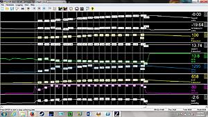

Originally Posted by SICAMG
Any time the bower spins faster regardless of what pulley is where...it will produce more heat.I think every one gets a little crazy with the heat issue. On my Mustang I run 25lbs of boost with just an air to air intercooler. The Shelby we just finished made around 18lbs ,900hp, with the same type of set up,air to water intercooler we have for our cars and the Shelby has always been a fixed pulley just like everyone else with a supercharger.
Here's a pull in 50-55F ambient with 14psi...
Granted had I stuck ice in the tank before going to the staging lanes I might have had near ambient temps at the line, considering the lanes were packed that day.
