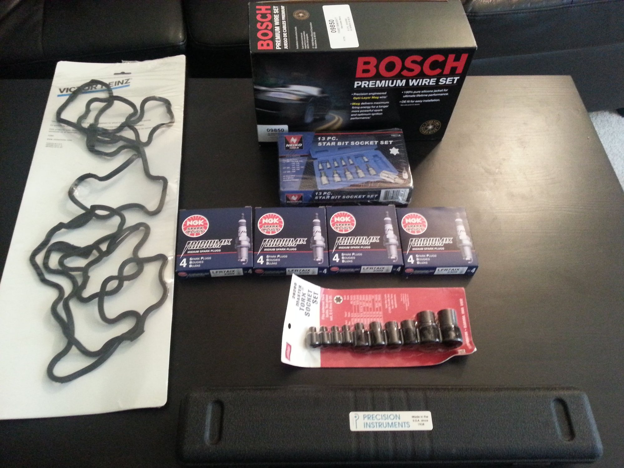

Finally got all the necessary tools and parts to work on the beast. Doing spark plugs, wires, and valve cover seals. I believe I will still need some rtv for the seals. I am a bit disappointed at how the valve cover gaskets were packed. Hopefully it won't cause any problems. Is there anything else I need to tackle this project?
This wrench feels great excellent craftsmanship.

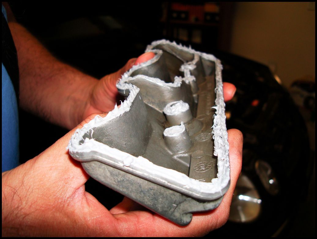

On the rocker covers you will need RTV silicone for the breather top and the oil filler top (photo attached so you know what I mean)
None needed on the main seals
Attached Thumbnails some new goodies for my first project arrived today!-17.jpg
