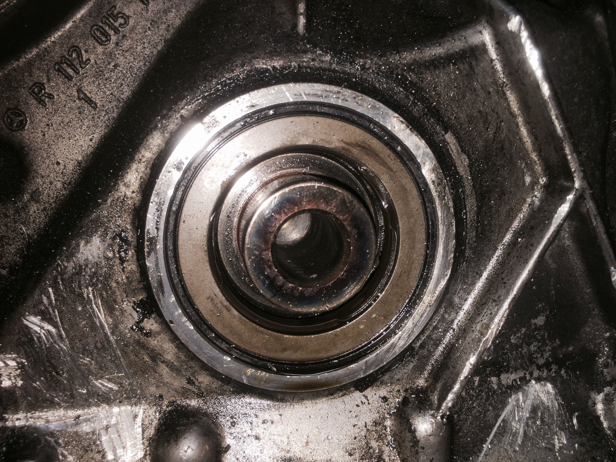

Post a pic of what your crank snout looks like. You have a couple of options.

Ls1toAMG's Avatar
Joined: Dec 2014
Posts: 1,236
Likes: 72
From: Indianapolis
2004 E55.98 SS Camaro.Jetta TDI. Expedition
Craig will chime in again. He has first hand experience on this
To me the crank looks ok. Will need a couple pins to hold the pulley.
