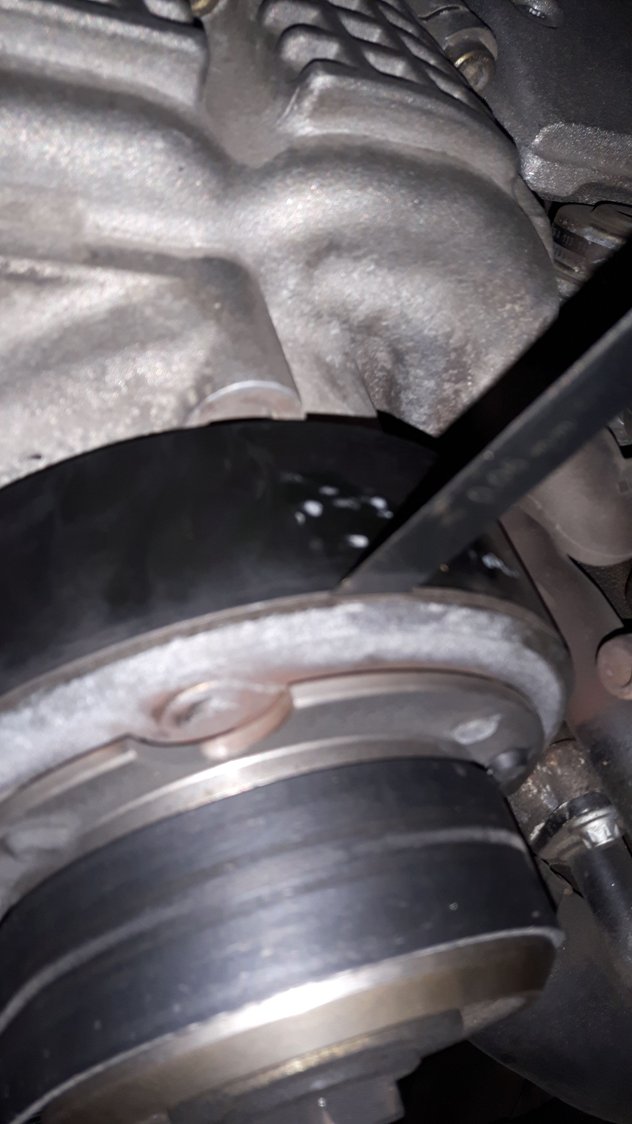

Could not get .36 to fit. Too tight.
Did I measure in the right place and should I do anything given the measurement?

measure between magnetdrum and pulley friction plate. Should be .35-.45mm

There will be some variance when the pulley is spun. Better tight than loose IMO. If the gap is too great, the clutch pulley springs will work harder and are more likely to wear more (and break) over time. Get a LM21 scattershield for safety.

Sep 27, 2016 | 09:14 AM
Forgot to upload pic!

Also make sure your using Mm and not inches. And yes as you spin the pulley the gap will vary. Keep the largest under .5 mm and you will be fine.

Gap doesn't seem to vary much & the .36mm is tight

You may close but ok. I just installed my pulley and I can fit the 0.35 and 0.45 gauges in but not the 0.50. 0.45 is tight, 0.35 goes in ok.
You can also start the car and try to lightly apply pressure to the magnetic clutch. If you can easily stop it while the pulley is turning, i'd say you are OK.
Or with the car OFF, turn the magnetic clutch and listen closely whether its scrapping against the pulley.
Do these "tests" at your own risk! Gloves are a good idea. Clutch gets hot and trying to stop it can burn. I usually use a microfiber and just apply pressure with 2 fingers and it stops.
