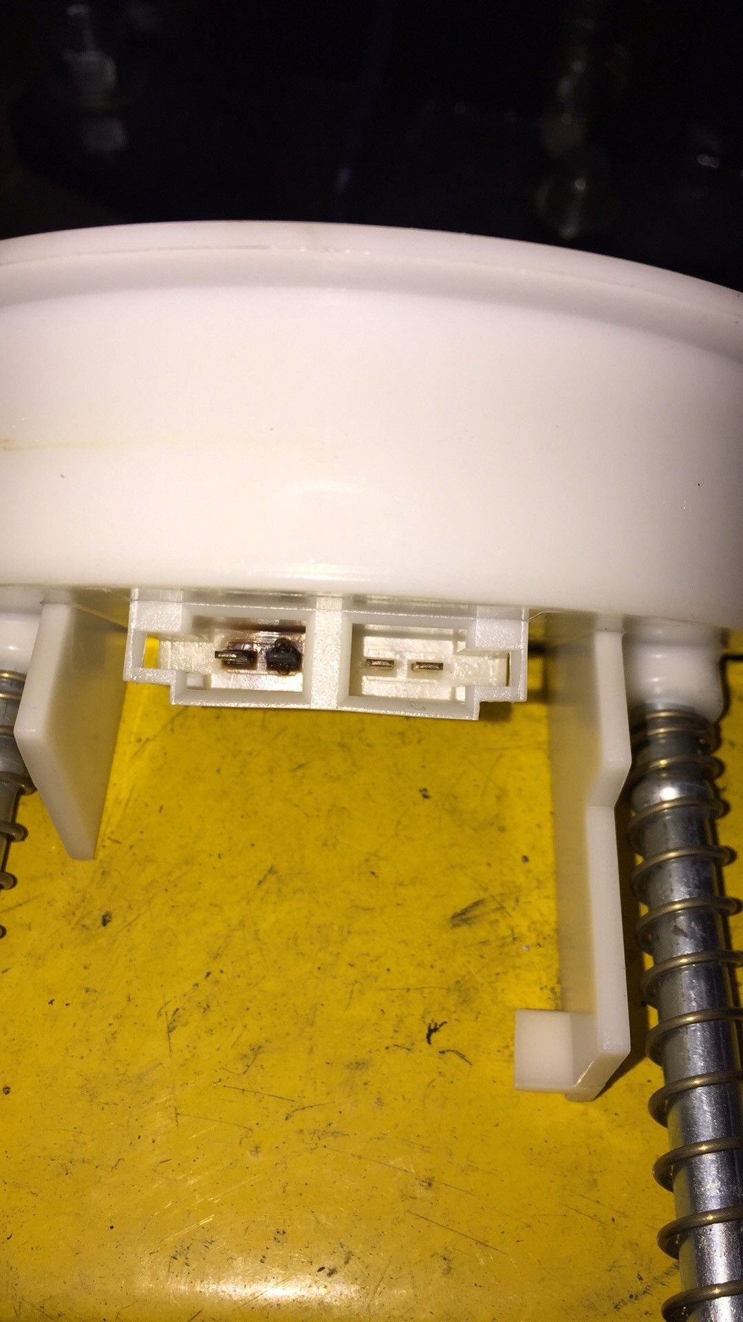

Back when I was I was stacked I was 77/168, mid length headers, 82mm tb , 2 heat exchangers, 10 gallon trunk tank, 550cc injectors with looped fuel rail. You need meth to cool
it down from climbing too high. The car would just gets too hot especially in the summer. The ecu pulls timing at 3 tiers:
95F - 3.5 degrees
113F- 6.3 degrees
149F - 9.5 degrees
My cooling still wasn't enough in 75F weather. My temp would start at 56F with ice and get to 129F on a 3rd gear pull at the dyno. I would recommend adding a meth kit to stop the temps from climbing so high. I added a 10 nozzle post inter cooler and a 3 nozzle on top of the snout. My temp wouldn't climb higher then 95F via zeitronix ndash on a 3rd gear pull at the dyno.
If you’re on recall fuel pumps I wouldn’t do it either. I lost a compression on cylinder #8 within 6 month of using a 77/168. I would upgrade the fuel pumps and drill some holes on the sides and bottom of the fuel buckets. To help refill the bucket so the pumps are always have fuel to pump. The new recall fuel pumps don’t have a siphon jet in the bottom of the fuel buckets like the original buckets that first came with the car causing a fuel pressure drop and going lean.
This issue doesn’t allow the fuel buckets to refill the buckets with fuel fast enough which causes the fuel pumps to not pump any fuel during a pull. If the pumps aren’t pumping any fuel they'll over heat and cause the fuel hat to get burnt. Which is what happened to me and unfortunately costed me a motor
ECU timing pull on the bottom left
Top view of the fuel hat
Bottom view of the fuel hat
