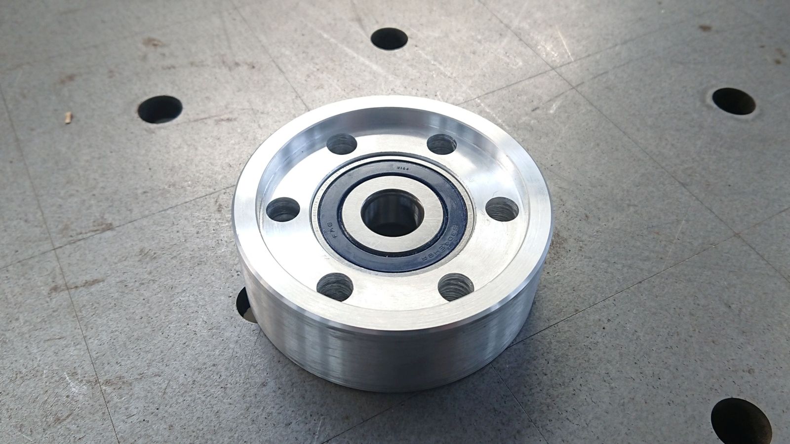

The pulley is done. And it works

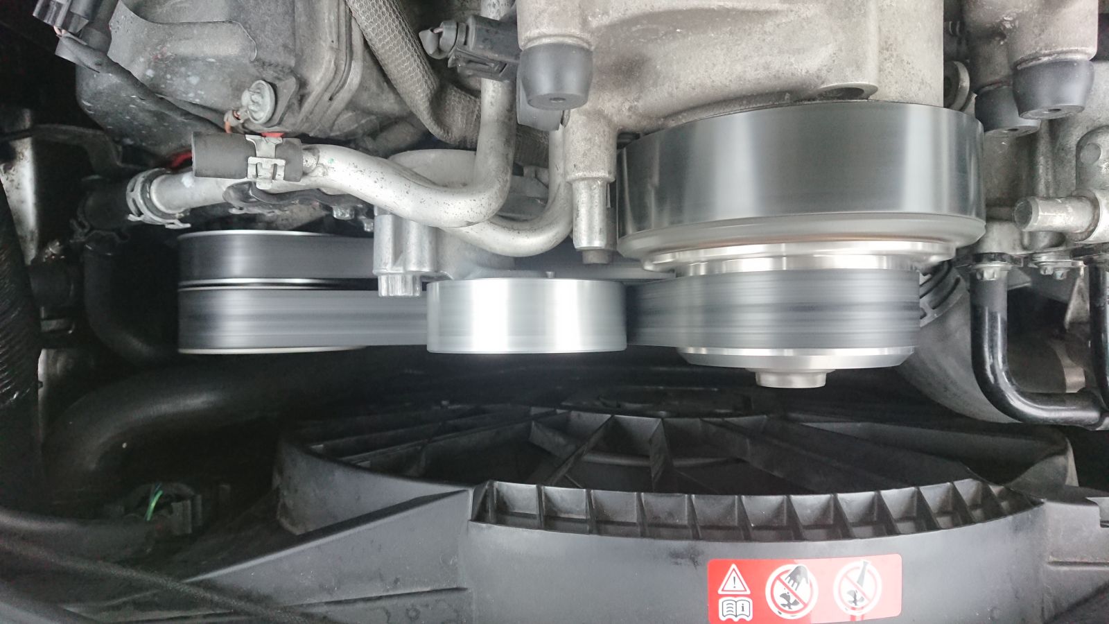

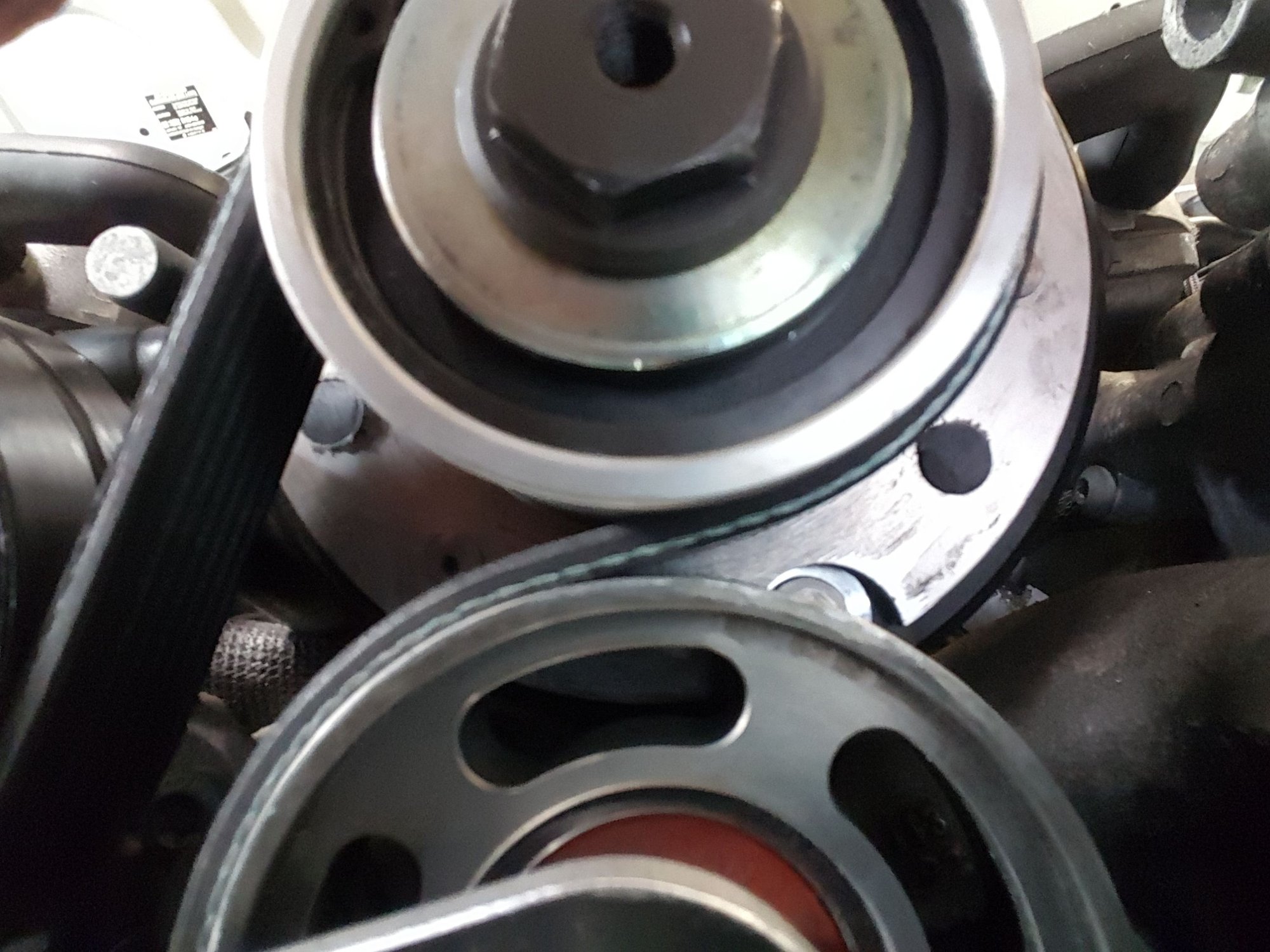

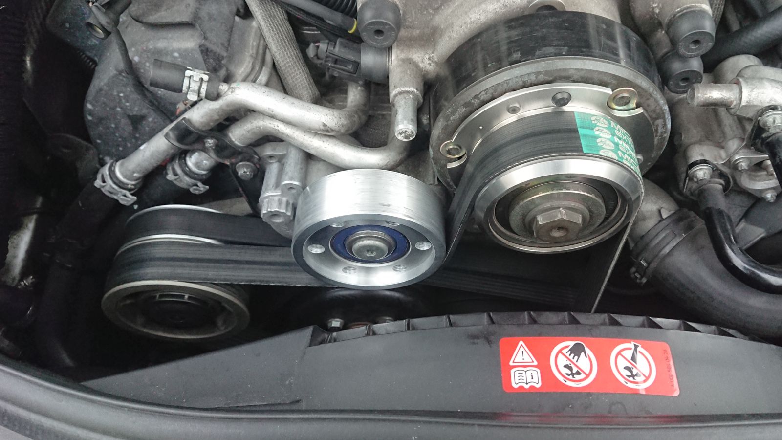

Alignment (if I understand it properly) went out not bad:

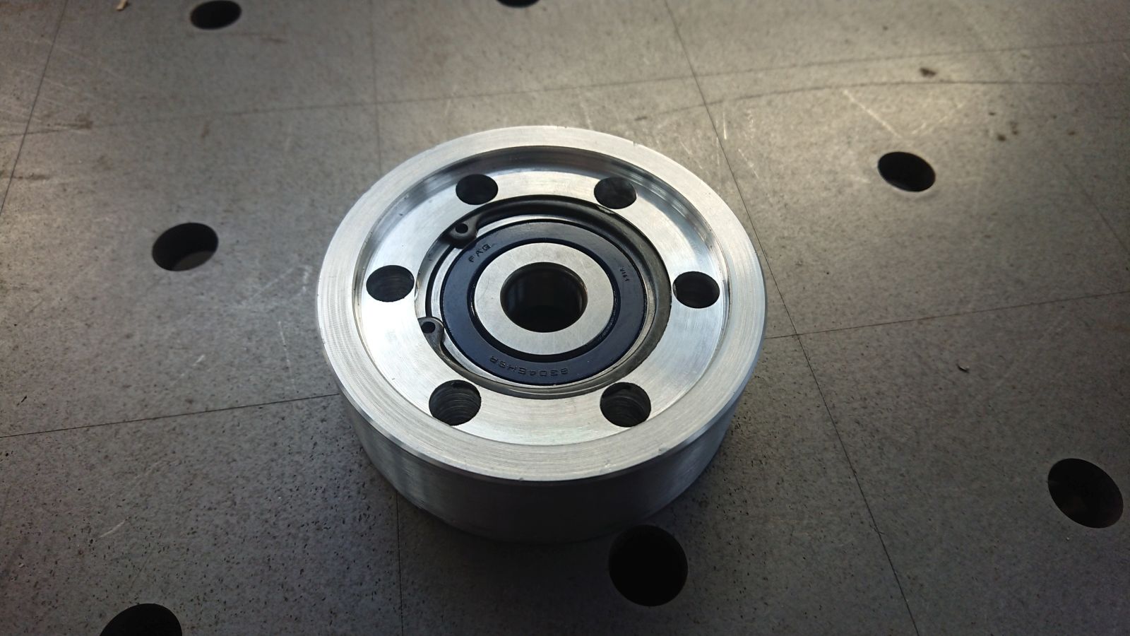

Disadvantages? (I still did not ride with it much yet)
1. Beasause of the bigger bearing I used I needed to shave a bit of "lip" that surrounds the bearing on the tensioner side (really minor thing)
2. You need the "brake line wrench" to move the tensioner now
